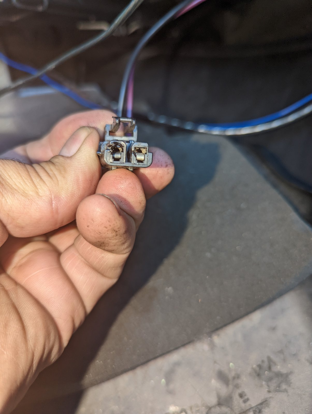

a couple days ago the ac fan in the wife's 05 burb died, fixed that and go figure now mine has died as well, have rear fan no front, luckily I have a resistor and a fan on hand already, now to figure out which is the culprit......techII hi-** :ehcapt:

Bad fan motor or just the connector? Are you thinking the motor caused the connector to melt?
ya, the post inside the fan connector is melted a little also, it shouldn't be like that. To me this indicates there is too much resistance in the motor and it's getting hot and once they start doing that it just gets worse and worse I could just replace the connector but it would still be a problem and melt the new connector over time. The fan I replaced it with was from a 08 denali I pulled out of the junkyard a year ago and it looks perfect and had a perfect condition harness also. back in business
