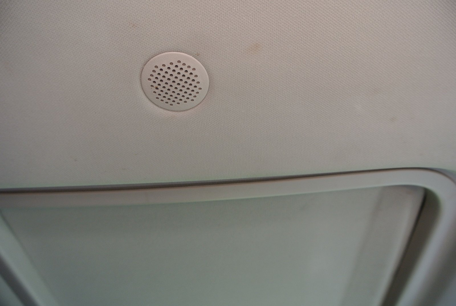

if there is no rear rooftop sensor then it could be one of the ones inside the vent tube, you would have to pull the rear panel off again to get access to it and check it, they are small and are poked into the vent tube with a grommet, they can be tested with a ohm meter and a hair dryer. I haven't head of any going bad they are just a thermistor.
do you have the bose radio?

So then above your head in the headliner there should be 2 little round grills that look like little speakers or mic's, 1 is the ambient temp sensor and the other is the a bose anc mic,
. you said previously there is none in the back? specifically above the 2nd row passenger side seat?
