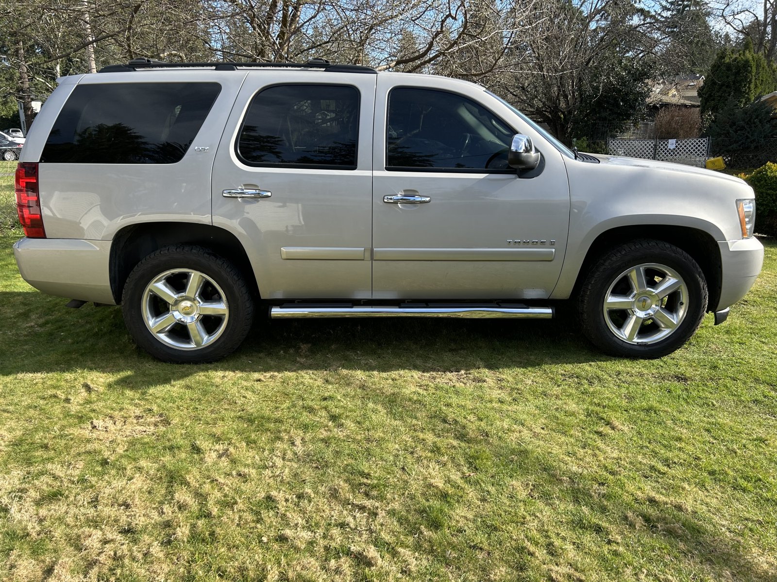

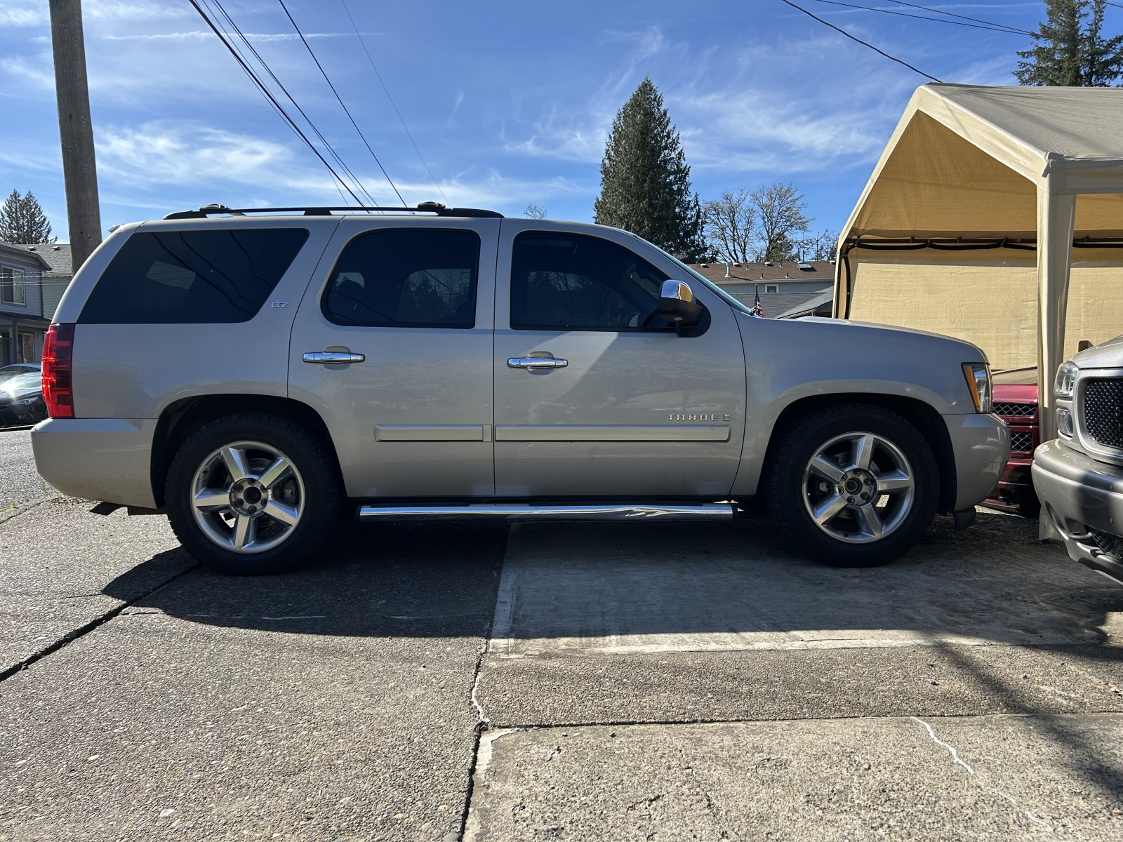

All done with the 2/4 drop. The rear is still settling but I have about a 2/3 drop now. The auto level is still calibrating too I think. I’ll run an ALC trim set with the Tech 2. $230 total for the parts. Way better than stock height. I didn’t get a before shot in the driveway but the yard shot is still valid. IMG_3746.jpegIMG_3809.jpeg

Damn..If I wasnt going for an overlanding theme id lower mine cuz this looks great.

That looks good. Is it 4wd?
Yes it is. :) And I installed new rear Arnott shocks and a Dorman compressor a couple weeks ago and the Autolevel is still functional as well. I just had to shorten the rear ride height sensor rods.

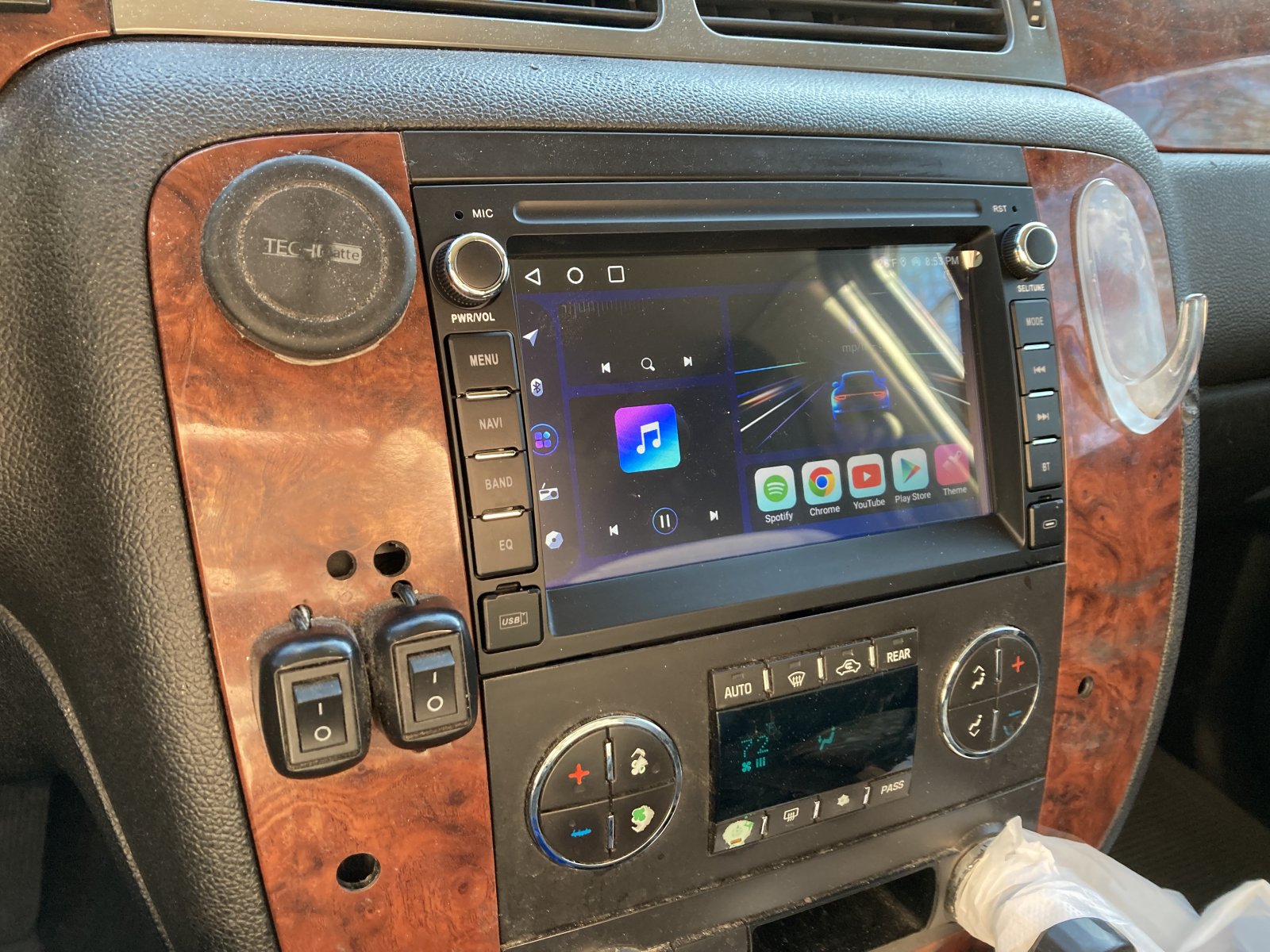

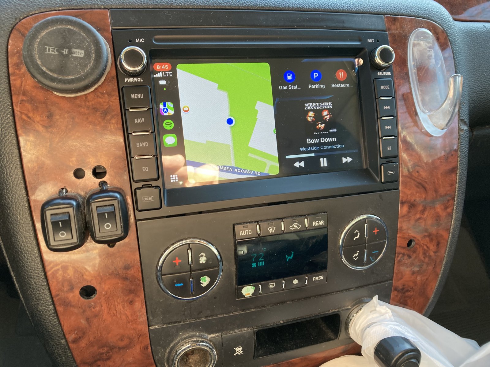

I've had something very similar in my '07 for the past 4 years and it's been great. It worked fine with the Bose amp without any fiddling and did indeed sound better than the factory Nav unit I had. However it will not work with the rear seat screen without the Maestro harness, so I haven't bothered to do it since we used the '12 for long family road trips.
