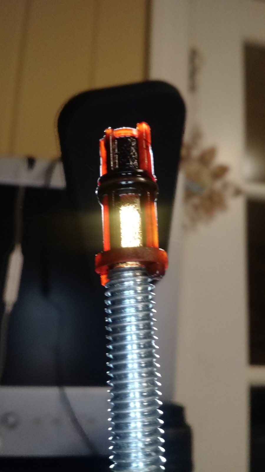

I had the same problem with mines. The 194 LED's didn't work even after turning them 180. They worked fine for license plate bulbs, but nothing in the mirrors. Put the stock ones back in.
Replaced my puddle lights with leds. They don't work even when I reverse the bulbs. Even the original ones didn't work after a while.
By chance when you installed the puddle lights were you parked in daylight? Put a book or magazine over the sun load sensor on the dash to trick bcm into thinking it's dark, then using your key fob unlock to turn on the perimeter lighting to install them so you can get the polarity right.
