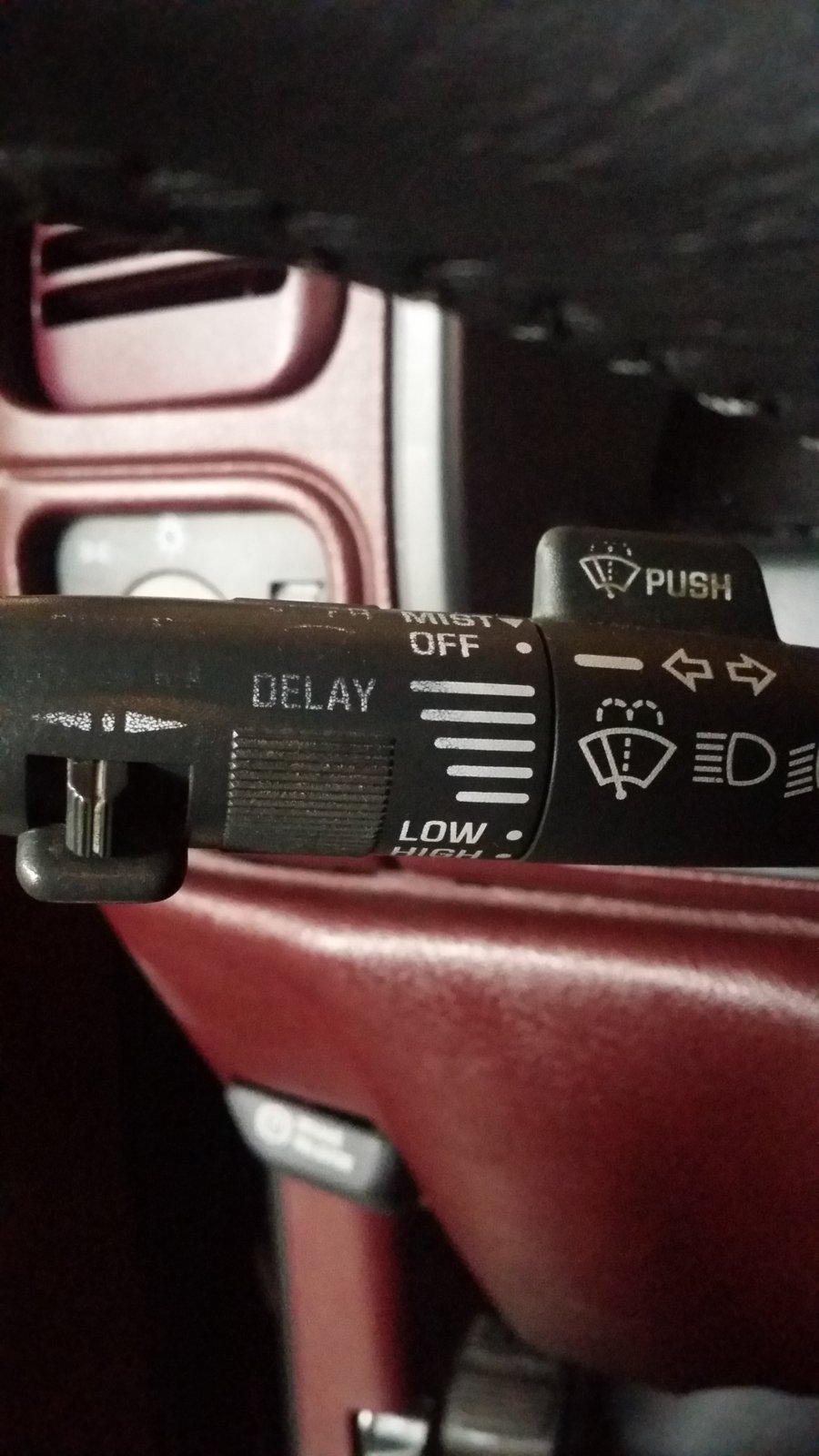

What the hell does this switch do?
east302
Dec 21, 2016
1,648
1,562
Mississippi
Pull the lever forward, the blue indicator will come on in the center of the speedometer.

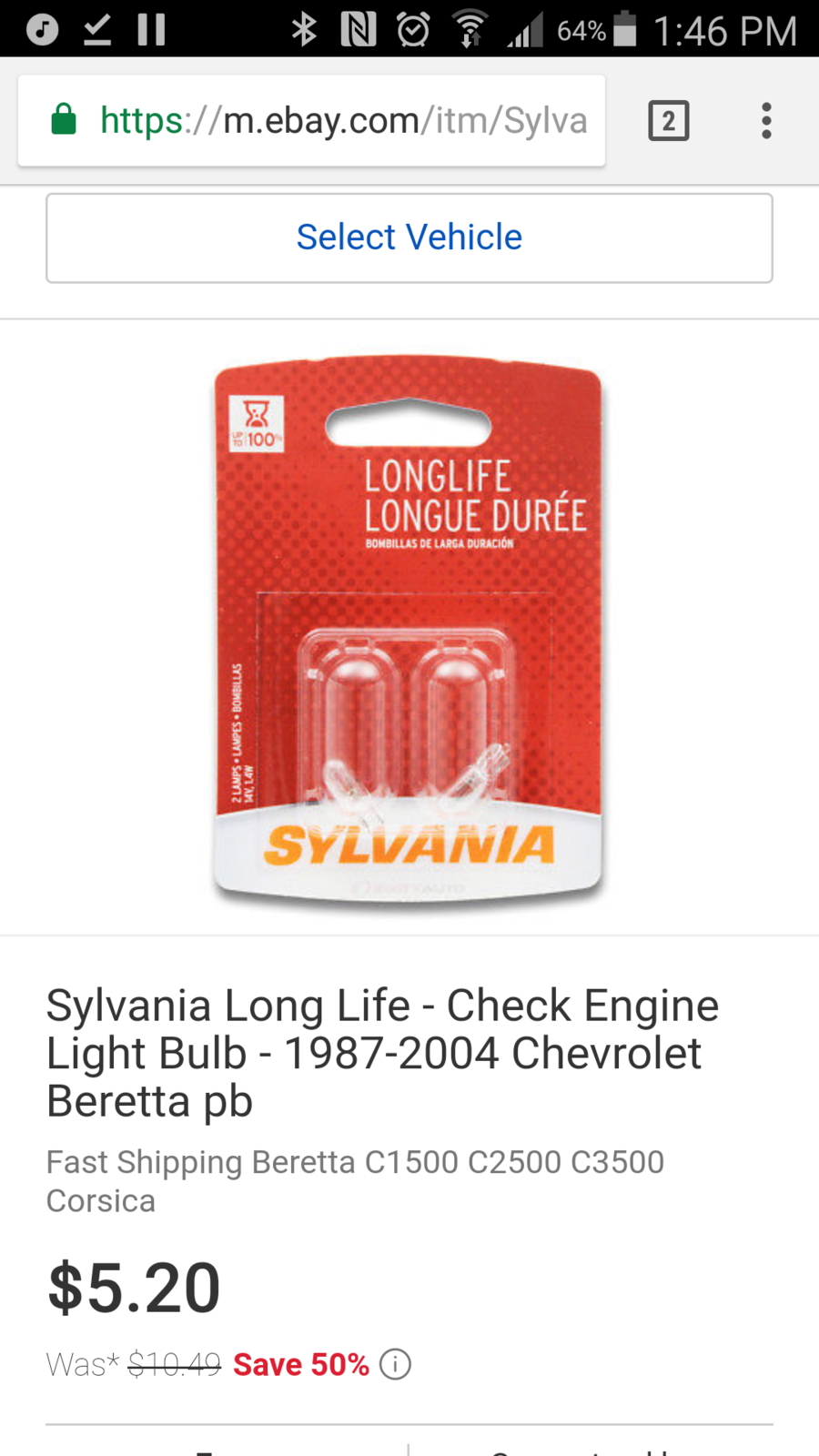

It doesnt come on. Neither does the check engine, i must have quite a few lights out. Anyone want to take a pic right when they turn theirs on so i can see all the lights im missing?

If you pull stalk towards you gently and either hold it there or let go the highbeams will come on to ‘flash someone’ then go off. pull it so it ‘clicks’ and highbeams will stay on. Blue light on dash may not come on unless you click it all the way

Turn key foward without starting and all dash lights/indicators will come on. When you start cel should come on as a check. It’s possible someone pulled the bulbs on yours because it was constantly on. Not uncommon.
