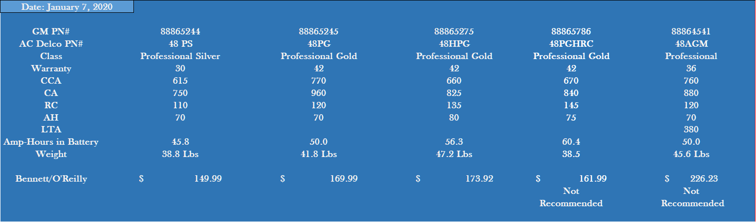

The GMT900s were not designed to use AGM batteries. That doesn't stop people from using them though, they just don't last as long as they could have.
My 48PS lasted about 4 years and was replaced by the 48HPG.
challenge accepted I bought the one with the longest warranty 3 years vs 5 years... 20$ more
159 for the AGM with 5 years full warranty(says right on the battery) why would i spend 139 for a normal with only 3 years...
that is a cost of ownership of $2.67 per month for the AGM... compared to
$3.86 per month for the normal one
