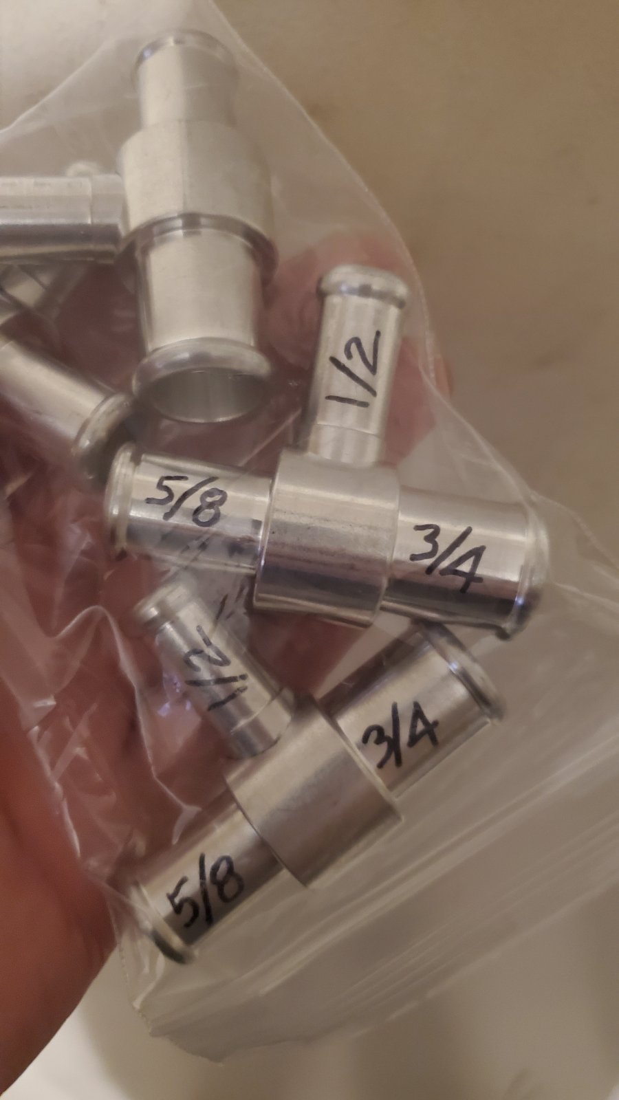

If you have not changed all of the coolant hoses (radiator, heater, overflow) within the past few years, change them all now, while you are replacing the radiator. If you have a rear heater/AC unit, change the heater hose splitting plastic Tees near the firewall on the passenger's side.
I recently blew out a heater hose and just about emptied my motor of coolant. Fortunately, after replacing all of the hoses and Tees, my motor still runs fine.
