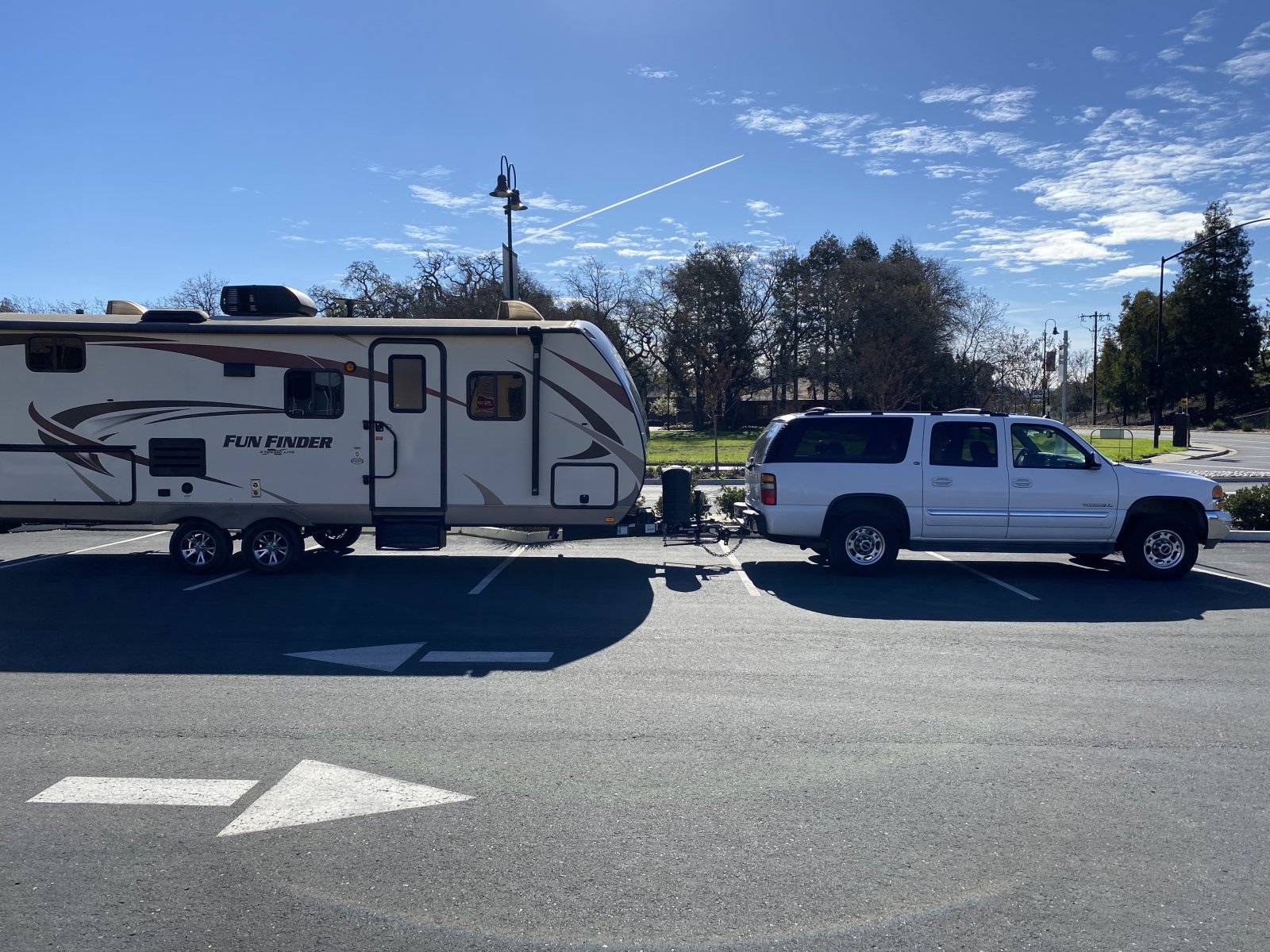

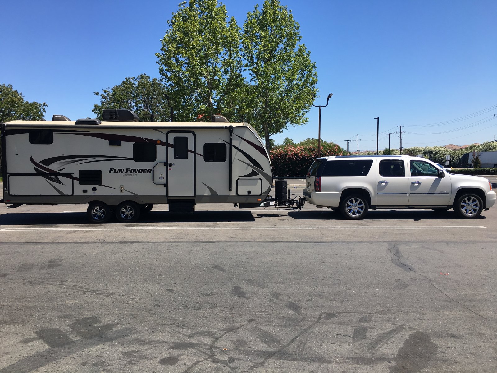

I tow with an LQ4 in my 2006 Denali xl and I also live in the mountains. Town sits at about 7,000 feet in elevation. While my towing has not gone over about 4500lbs, my LQ4 and my rebuilt 4L65E trans handle the boat I haul up and down the mountain roads for a close family friend, pretty easily. I’m not necessarily winning any speed races going up the grades when I’m towing but it pulls and pulls and pulls faithfully and doesn’t struggle. All I’ve done under the hood is a spectre intake, and a mild magnaflow muffler in pace of the factory muffler, and had blackbear performance do a tune. That’s a piece of the puzzle I would absolutely recommend. He tweaked a lot and adjusted for being at altitude most of the time. Here’s what I tow most often behind my Denali.
