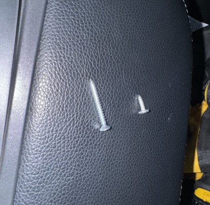

Sorry for the mish mash of photos. The video is way more explanatory. It works great I have an I Phone 15 and it has plenty of room. My phone has a case and still charges. You have to place the phone in. The middle of the charger or it doesn’t work/charge. I had to drill two holes and run the power cord from the back Consol but it all worked. My only advice is shop you screws. They don’t come with the charger. The skewers needed to screw in the top charger takes four screws when you place the power charger the length of the screws isn’t long enough and I had to make shift using old screws from around the garage. They were two long and went through the pastic. Now you put back the cover and you don’t see it and it doesn’t bother anything but it’s there. I have to cut both screws or get shorted ones to replace it. However it all works. I recommend it.
