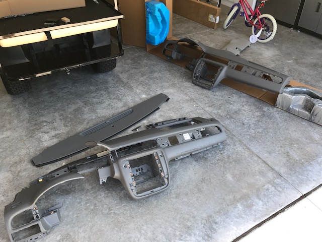

Worked on my cracked dash this past weekend

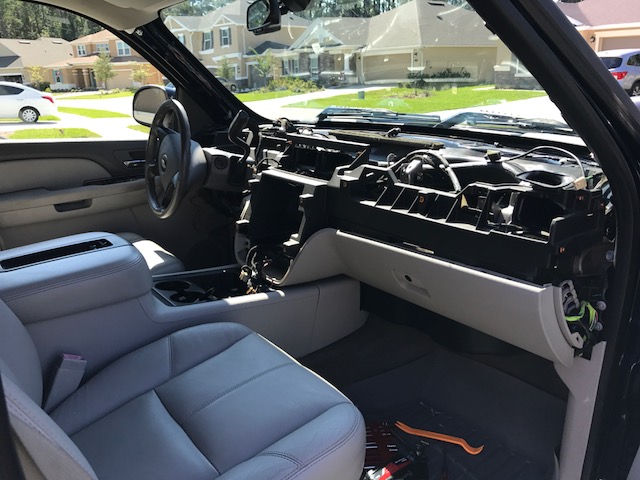

Took 2 hours this morning, but that includes wiring up a USB outlet. Watched the video before hand for tips, and just a side note I do car audio/video so I'm comfortable doing stuff like this. It'll probably take most people a little longer...
