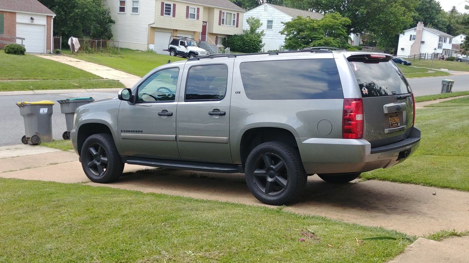

I have an 07 Suburban with 215,000. We rebuilt the trans 8 months ago. It needs motor mounts, has an oil pan leak. Needs some front end work and struts. We owe about 4,000 on it. Paid off next year. Would you just repair motor mounts or put a reman in? We have the typical oil consumption issue even after changing the gaskets. It has other issues but nothing that I can't deal with right now.
Looks nice! Have y'all replaced the driver's side valve cover with the updated one that came out in 2011? It helps reduce oil consumption. Judging from your other post, it sounds like your AFM system is worn and needs to be overhauled or replaced. This requires removing the cylinder heads and putting in new lifters and such depending on what you want to do. Is this a 2WD or 4WD truck?
