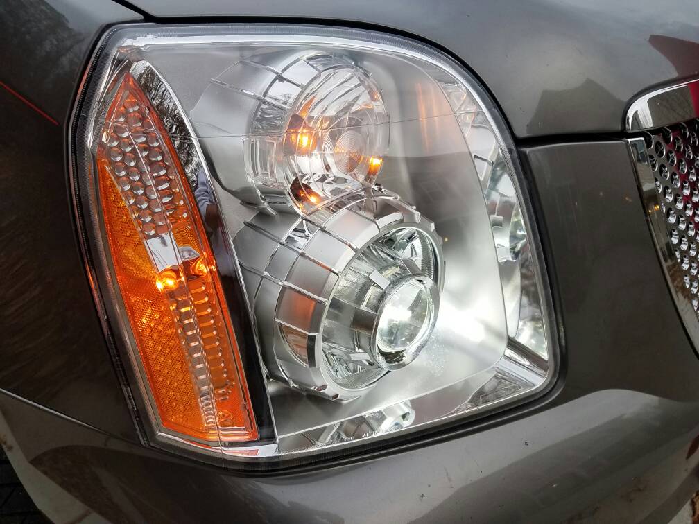

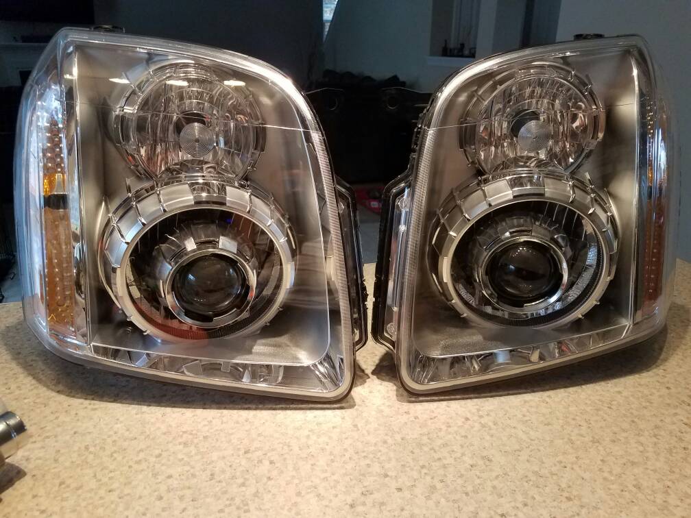

Oh I'm **** retentive with perfection. I'll take my time and do it right. Did you plasti-dip the lights or scuff and paint? No issues with hear from the lights melting the plasti-dip if that's what you used? I would love to see a good close up of one light, as I'm sure other people would.

I didn't use everseal perma- seal, what ever that craps called. I used geo seal either from lowes or Home Depot. Just clear weather resistant **** stuff for windows I think. Got it from my bro. In law. The **** gun made a world of a difference easier to apply. I did 275 like every 10 min. Took it out tried to pry a lil bit at a time and put it back in another 10 and pry again. Patience and time will get it. It will come apart. Just a pain a lil bit

I tried to find out myself about what type of paint to use, cause I figured it would get hot but never really got an answer so I had some plastic spray paint from Wally World ( Walmart) laying around and sprayed it. It's been at least 2
Months and haven't notice anything. They're sealed in there so if anything would hAppend it would be heat so far so good. The only thing I chipped the paint a lil putting it back together sharpie helped me out there.

Krylon fusion for plastic works well if u scuff first. I would recommend bulldog adhesion promoter after scuffing. That's probably what I'll do. Post a close up pic of a light.

I'll post a pic in the morning. Caulk my bad guys not a good speller. **** gun lol.
