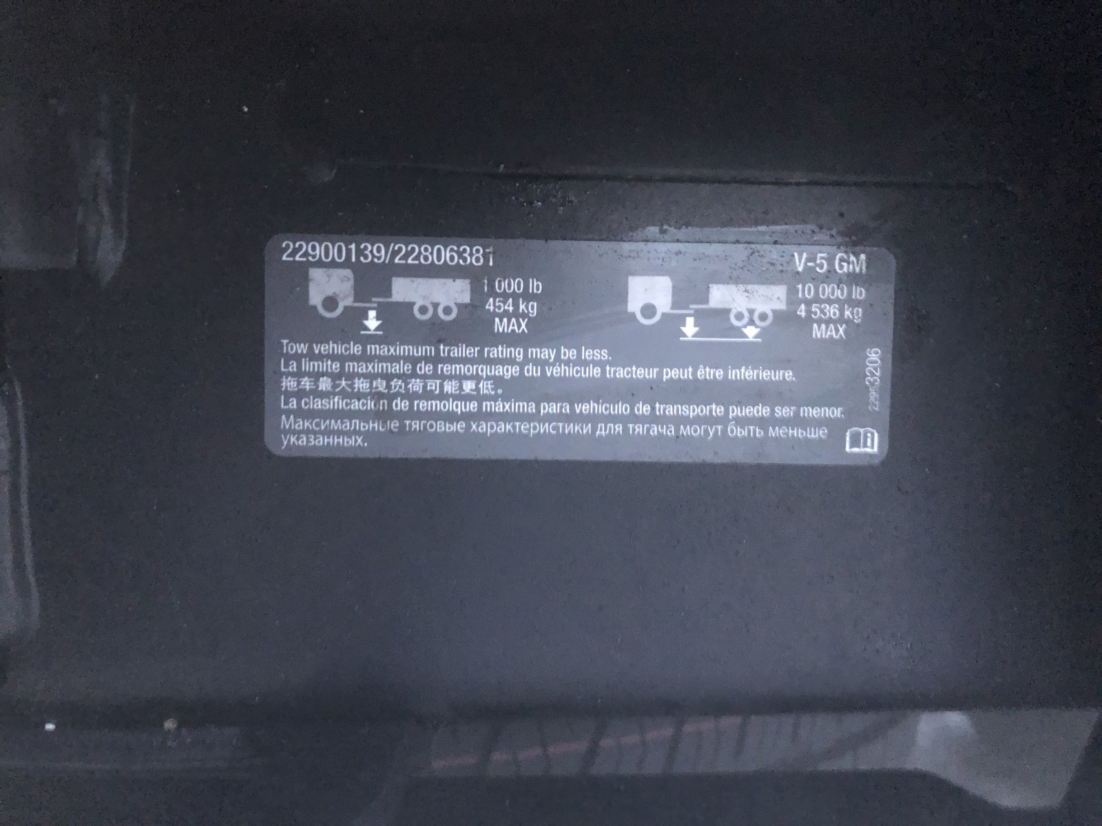

I rented a 2WD 2019 Tahoe this week for work (VIN - 1GNSCBKC2KR331221) and this is what is on the receiver. Didn’t think to grab photo of door sticker.
Yours and mine would be the same ratings too. The hitch itself exceeds the vehicles capabilities. While not certain, I think that the 2500s use the same hitch but have a higher rating because their frame is larger out back where the two connect. Well, maybe that and for certain because of their higher load capacity because of the leaf spring suspension and 10.5 full floating rear axle.
