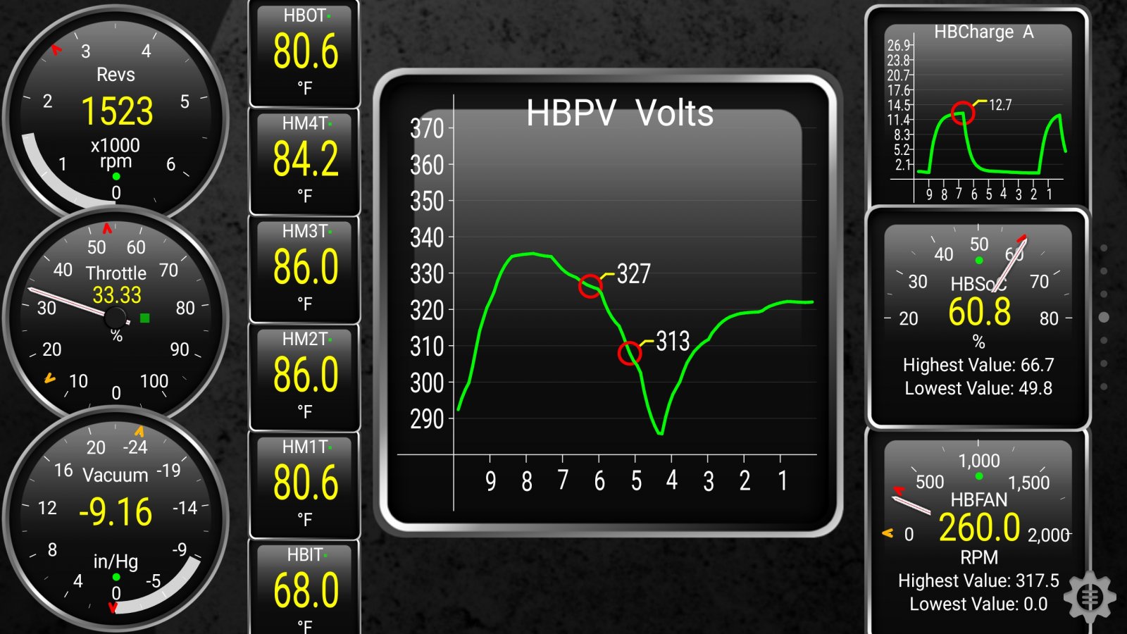

The NEXAS NexLink OBD2 Scanner worked like a charm! I'm trying to create dashboard to monitor kW in/out similar to the Volt/Bolt. I also like to monitor heat/fan info since that's how my last battery died.
j91z28d1
Feb 28, 2022
3,424
4,246
very nice.. you can do the kwh, not just amps. you be to create a math channel looking at the volt and current.
I think I have the math setup somewhre if you need it.
(VAL{Hybrid Battery Pack Calculated (Volts} * VAL{battery current}/1000)
givin you have both of the other pids loaded. this just points to those
I like your soc gauge. very nice.
