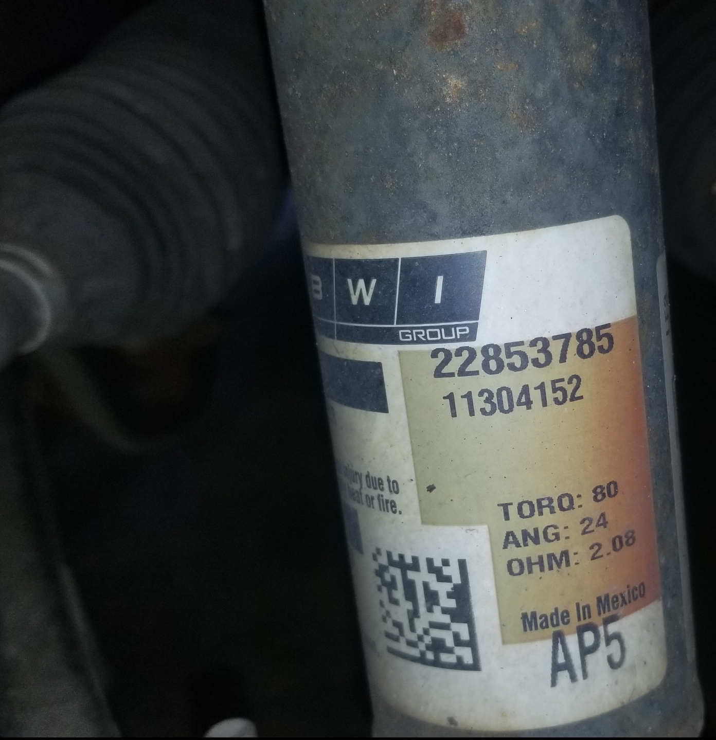

My update on this, I cannot find anything in the Tech 2 on the health of the suspension, I will chalk that up to user error at this time.
Secondly, I'm trying to locate the front strut cartridges, based on my VIN, the 2 dealers I called gave me: 19420494 and they also verified I have the computer controlled suspension.
Are these correct? Searching these parts I don't see the electrical connector at the top.
This is a pic of my front strut, safe bet these are OE with 120K miles....ouch.
I purchased this with 92K on the clock and these have been on my to do list.
