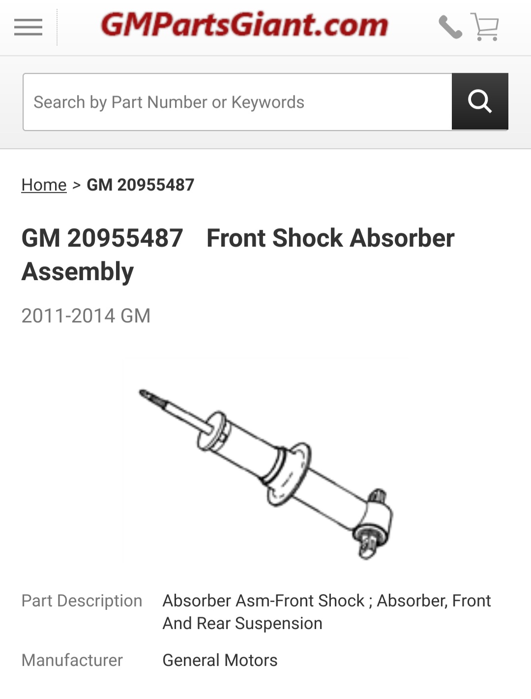

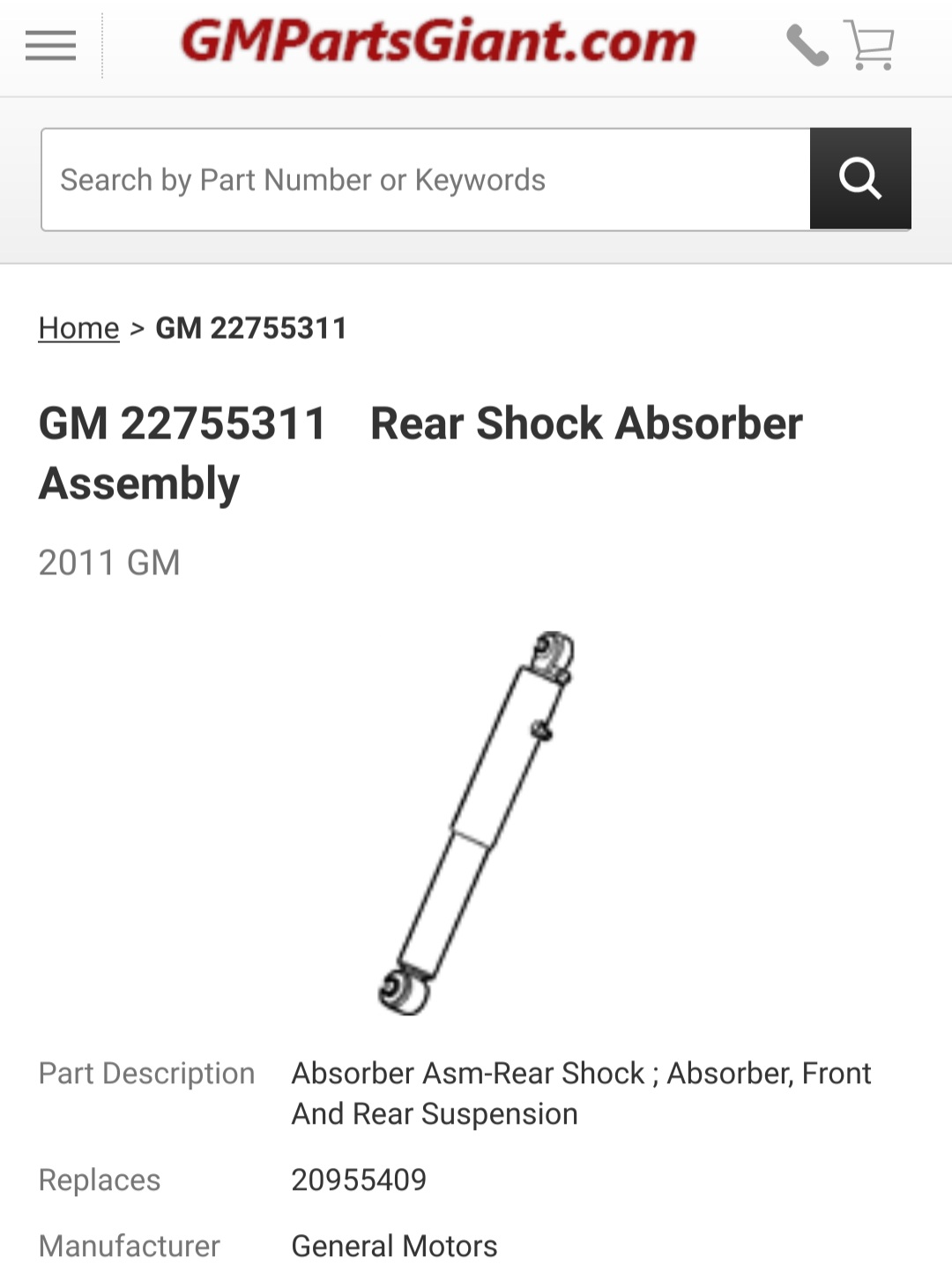

Hello all. I bought my 2011 Tahoe LT with 80k on it back in 2018. At 100k I replaced the shocks and struts with new gm parts. Kept original springs. Tahoe now has 130k on it and I just don't get the hype of the Premium smooth ride. Maybe I was expecting something more. I didn't even change when I installed new parts. Is there something I'm missing? Also I hear people complaining on the price of rear shocks being upwards of 200 dollars a piece. That was not the case with mine. They were about 70 dollars for each rear and maybe 80 dollars for each front. I am pretty certain I got the correct parts for the ZW7 RPO code. Stabilizer links were also changed. Anyone have any insight? Thanks

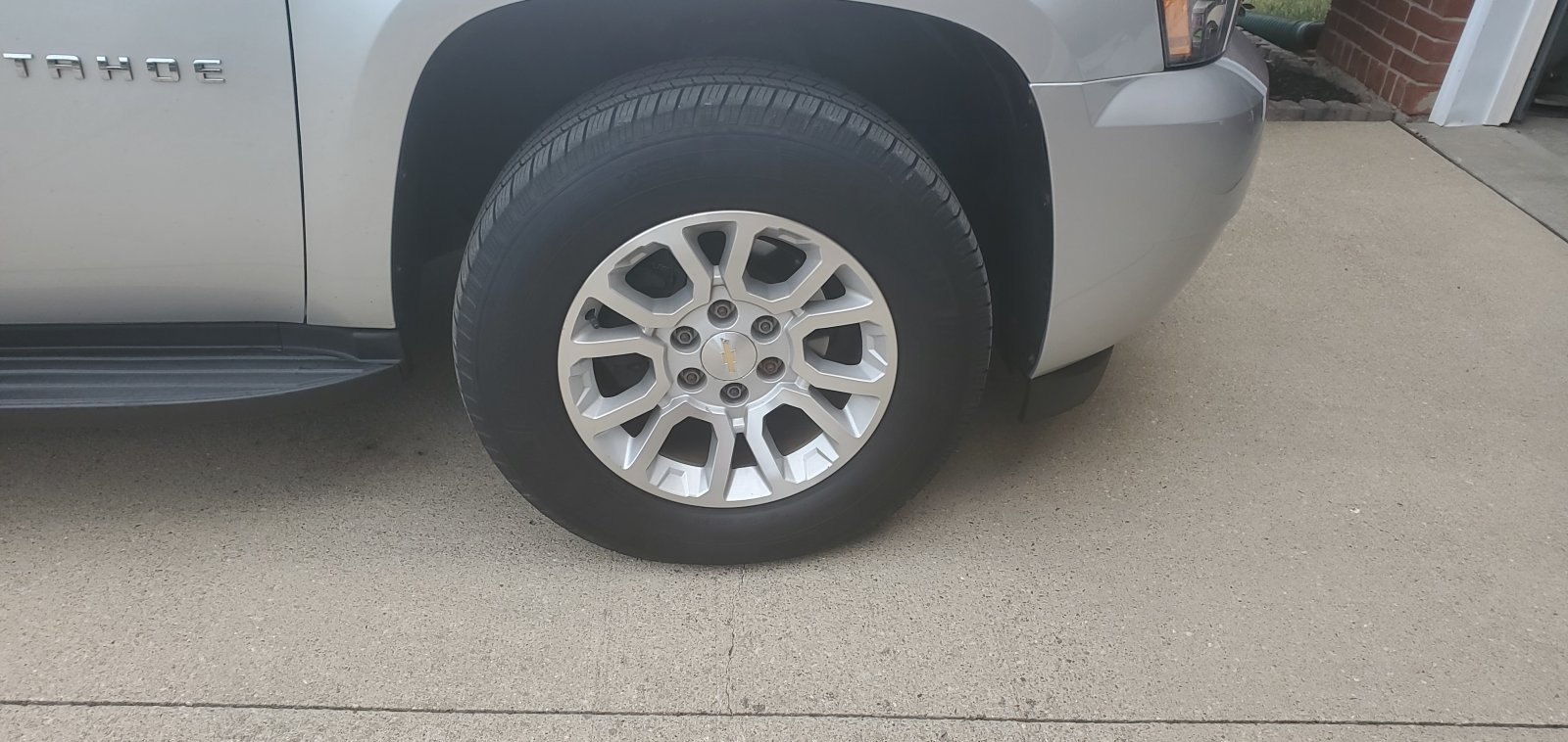

Wheels are factory take offs from a 2018 model Tahoe. They are 18 inch wheels. Tires are Michelen Defender LTX M/S with 20k on them. I run them at 32 psi.

Tire size is 265/65R18
Those should provide an excellent ride unless there is a defect somewhere. What symptoms or concerns do you have with the ride? Is it just harsh, vibrations, etc.?

ZW7 has the nivomat shocks in the rear and a softer spring. Do you also have the G69 rpo code? I’m betting you replaced the rears with regular shocks and didn’t upgrade the springs at the same time and that’s why it rides like crap. I did the same thing and my problems were resolved with the installation of some Z71 springs from moog.

The part number for the shock and struts are said to be for my vehicle according to the vin. I will double check for the G69 rpo code. I have the ZW7 RPO code indicating I should have the nivomat shocks. What is the G69 RPO code. I do not have that code
