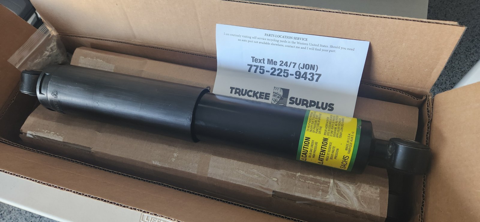

My friend, Jon, with Truckee Surplus has nearly brand new 'used' Nivomats as a pair for less than $300 including shipping. He specializes in shocks also. He's been doing it for years.
I just returned a pair, because ( after all my research), my Yukon ZW7 smooth ride does not use them. Nivomat rerquires a softer spring, so stick with OEM.
Not sure how I feel about getting a set of used shocks. Plus this name brand I’m not familiar with.
mountie
May 9, 2018
5,323
10,069
Used shocks though? Can you personally vouch for these shocks?
The seller, inspects the vehicles for 'evidence' of newer shocks, he removes. The Sachs 'Nivomat' shocks he sent me were in a brand new condition ( The OEM decal was also original and clean) . I spoke with him, and he has been doing this for a long time. He also guarantees them.

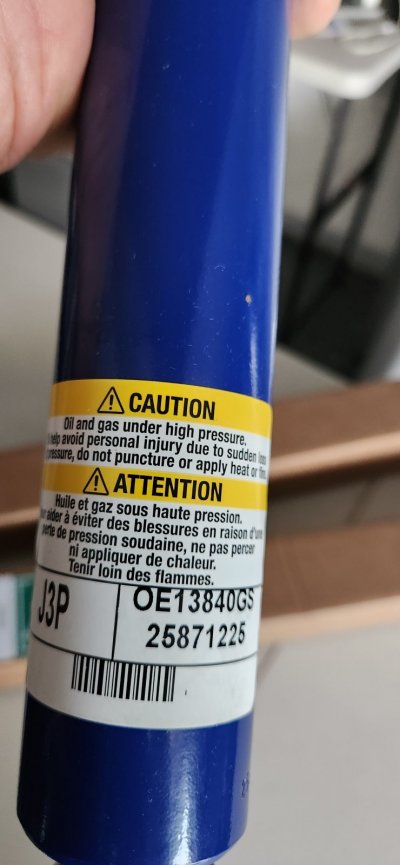

I just received today, my OEM / AC Delco replacement rear shocks. Since the originals have 175,000 on them.....
My Hellwig front sway bar to arrive today, also.....
I am happy.....
I am happy.....
Did these come from Jon ?
