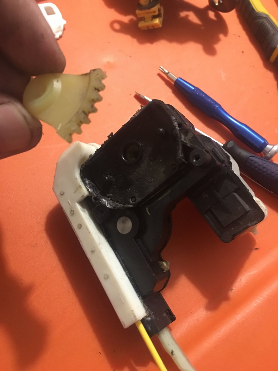

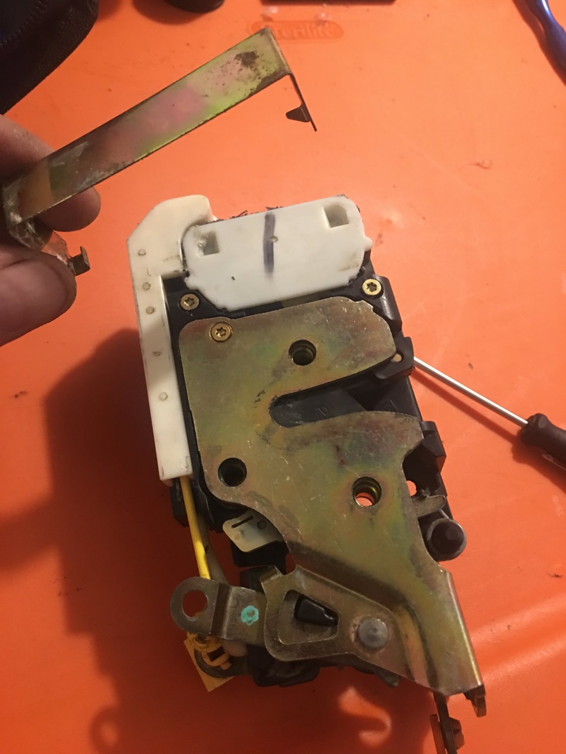

I removed the drivers door latch assembly which has three harness connectors that plug into it. The connector with the dark blue and grey/blk wiring is for the mini wedge switch. I disassembled the latch assembly and quickly realized the root of my issue.

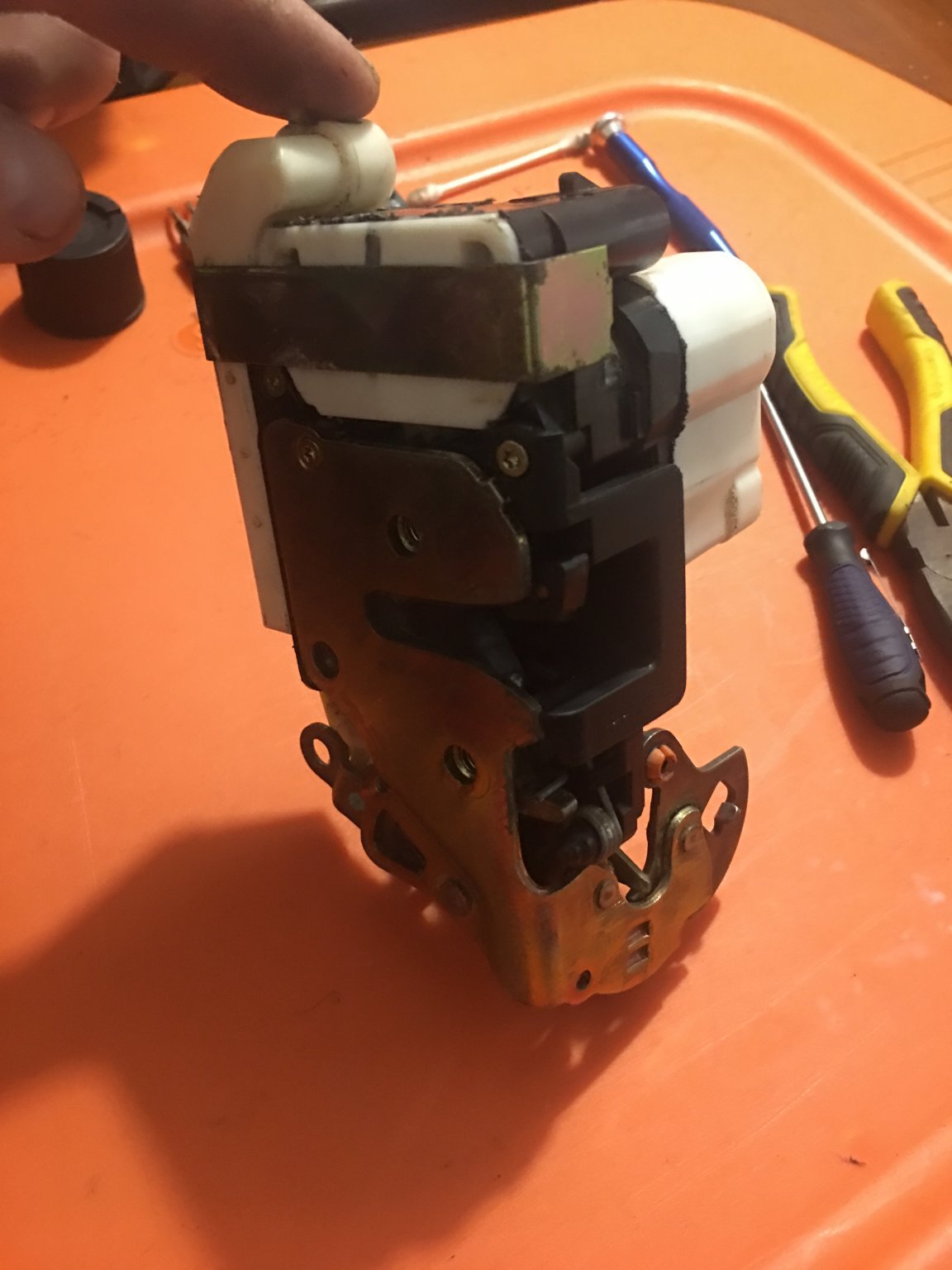

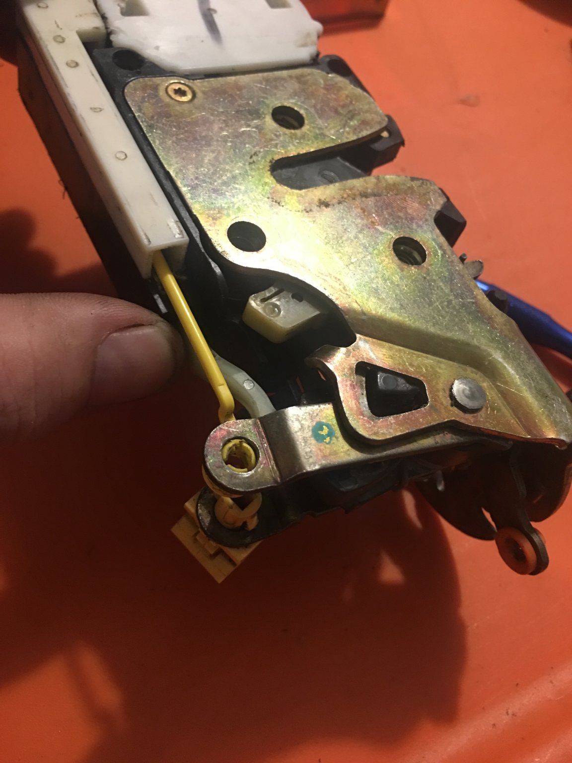

Here is the complete latch assembly

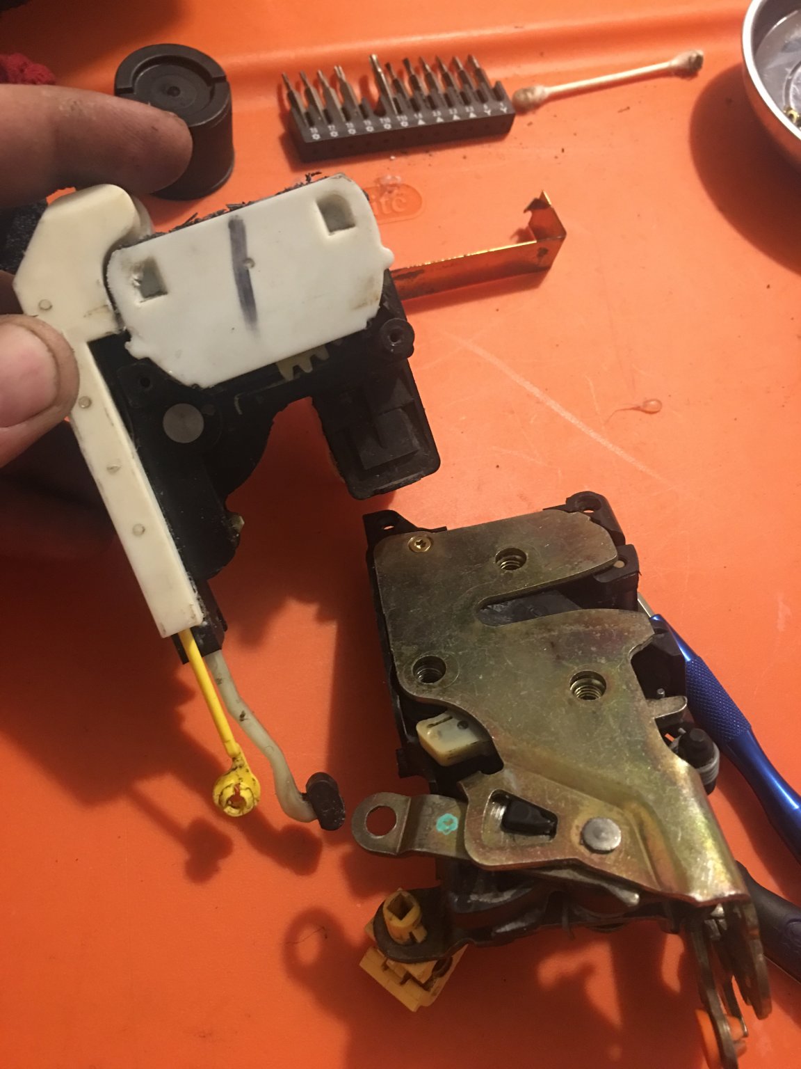

Remove the metal strap from the top and the two small screws closest to the top

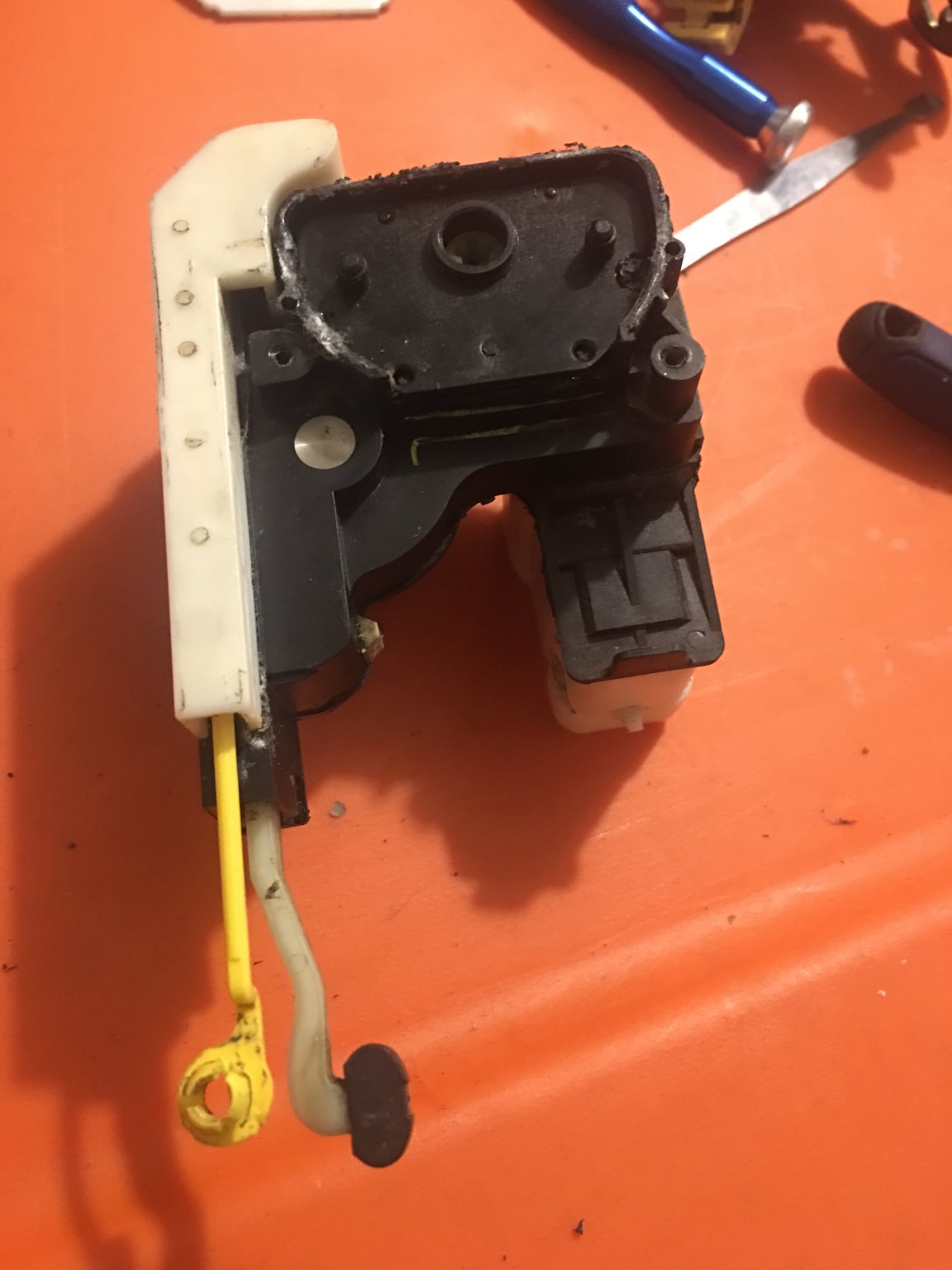

Pop free the yellow arm
Seperate the the two pieces
Remove the white plastics backing plate
...continued.

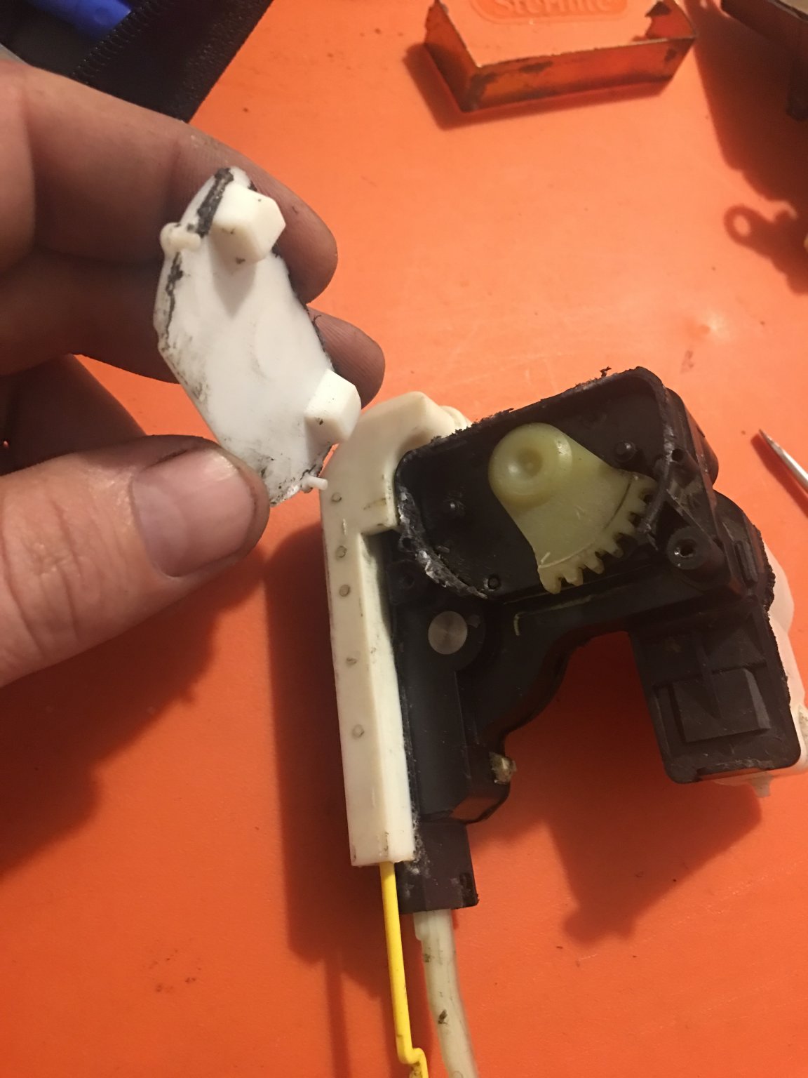

2 of 2
Remove the gear
Very gently pry off the black plastic plate behind the gear

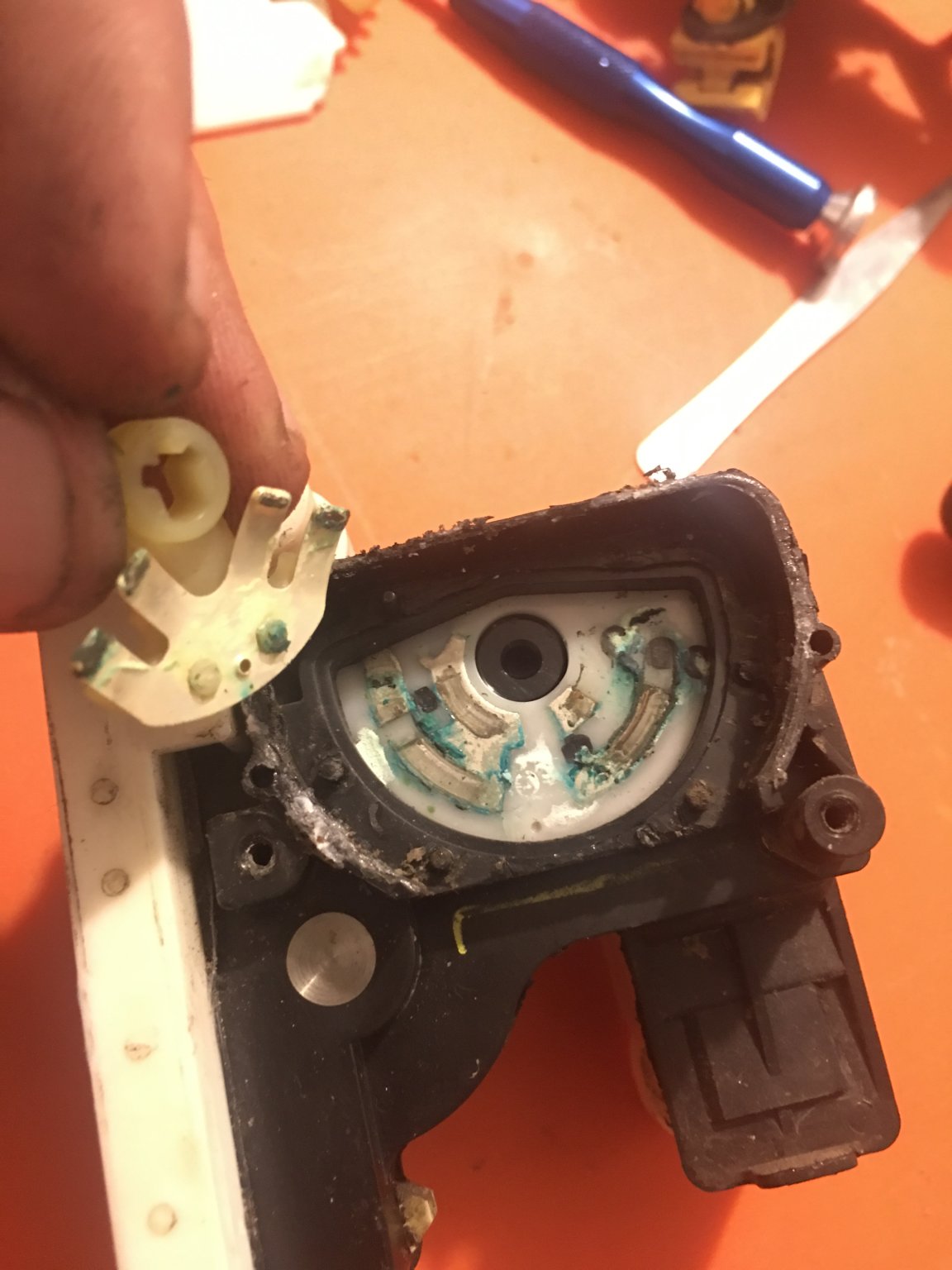

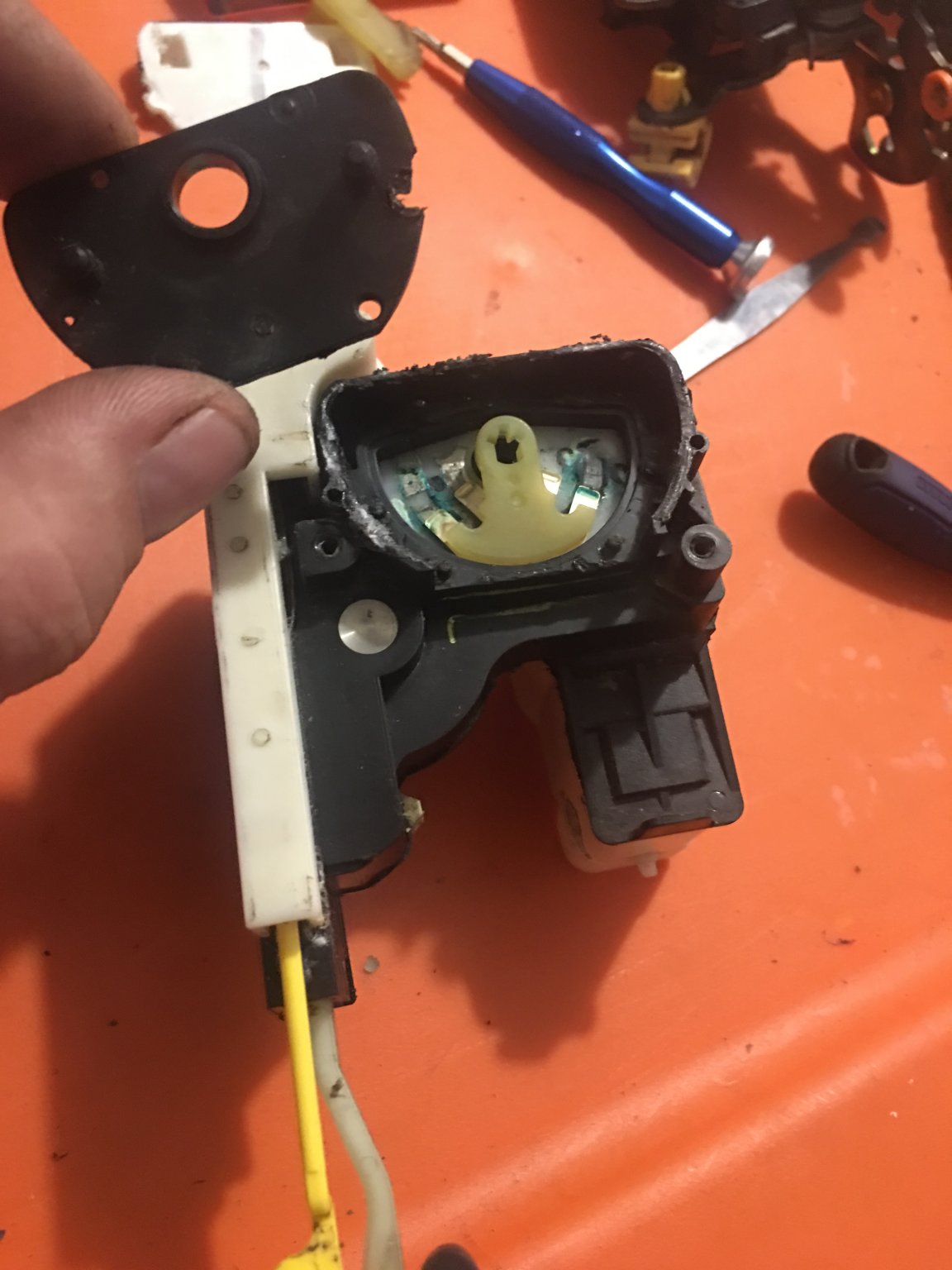

Once the plate was removed the cause of my concern was clearly evident
And as you can see I had some nasty corrosion built up preventing the switch from functioning properly

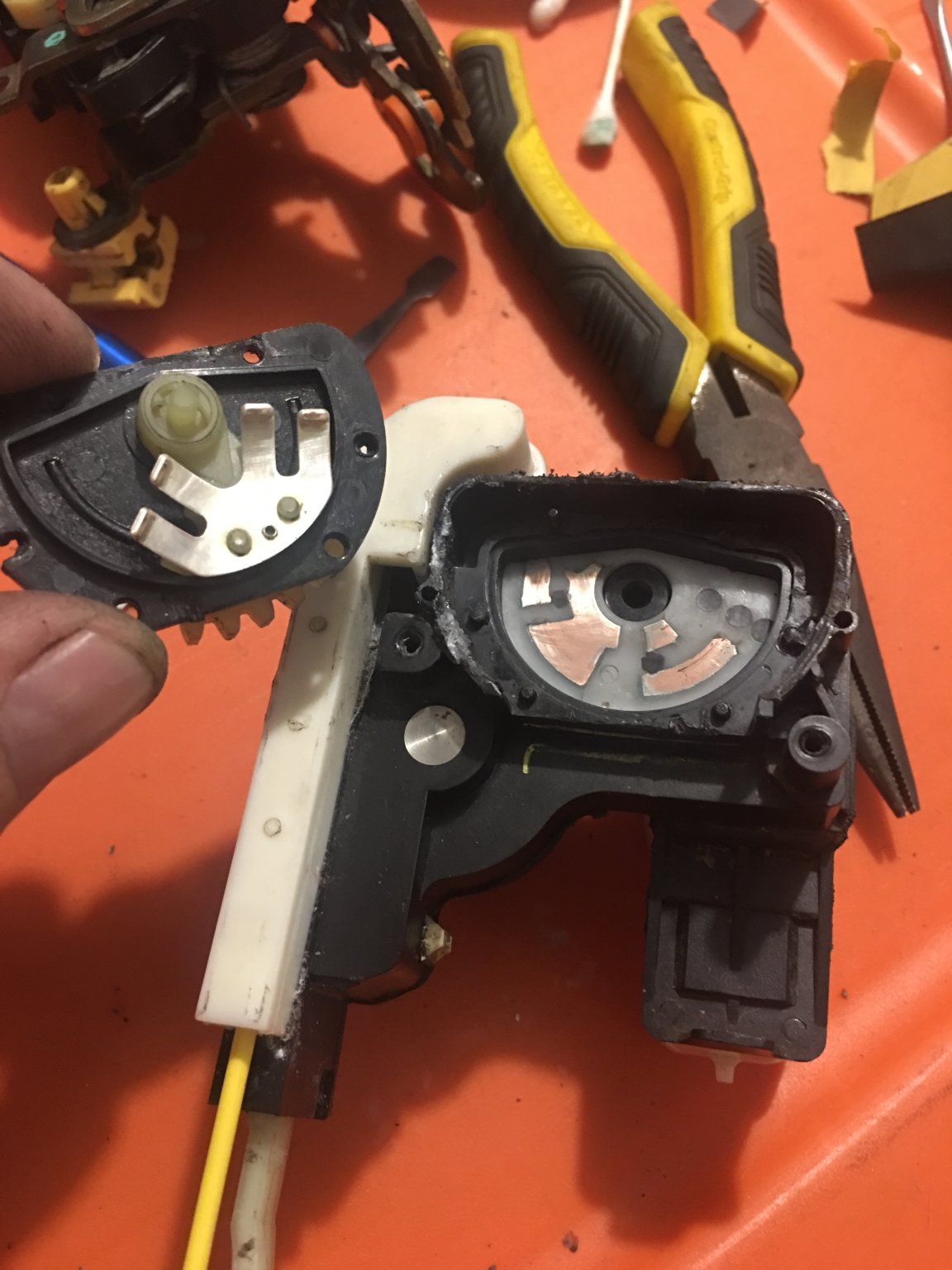

I used 400 grit sandpaper, rubbing alcohol and a couple q-tips to clean up the contacts.
Assemble in reverse order...
Once I had it all back together I plugged the latch assembly back into the harness and tested it using a screwdriver as the "door striker". Turned the key to off and "opened" the door and everything worked beautifully like new.
NOTE: the drivers door module is unplugged in order to remove the door panel. The module must be plugged back in in order to properly test the function of the door latch assembly!
Hopefully no one else experiences this problem but if you do I hope this helps!

Just needs to be cleaned! The contacts in the switch built up a bit of corrosion making poor/no connection, dissabling it.
Why buy a new one $$$ when you can just clean it.
