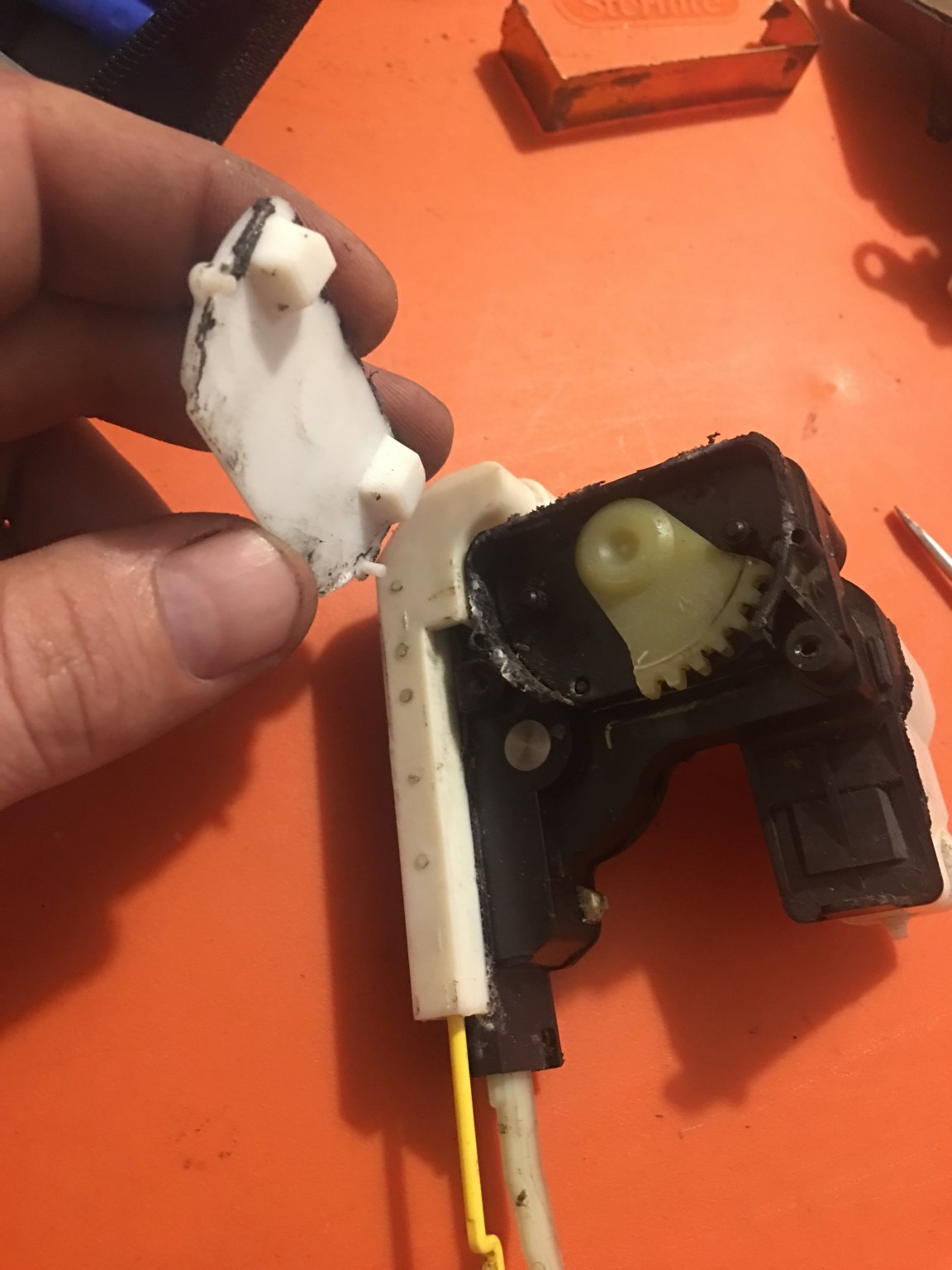

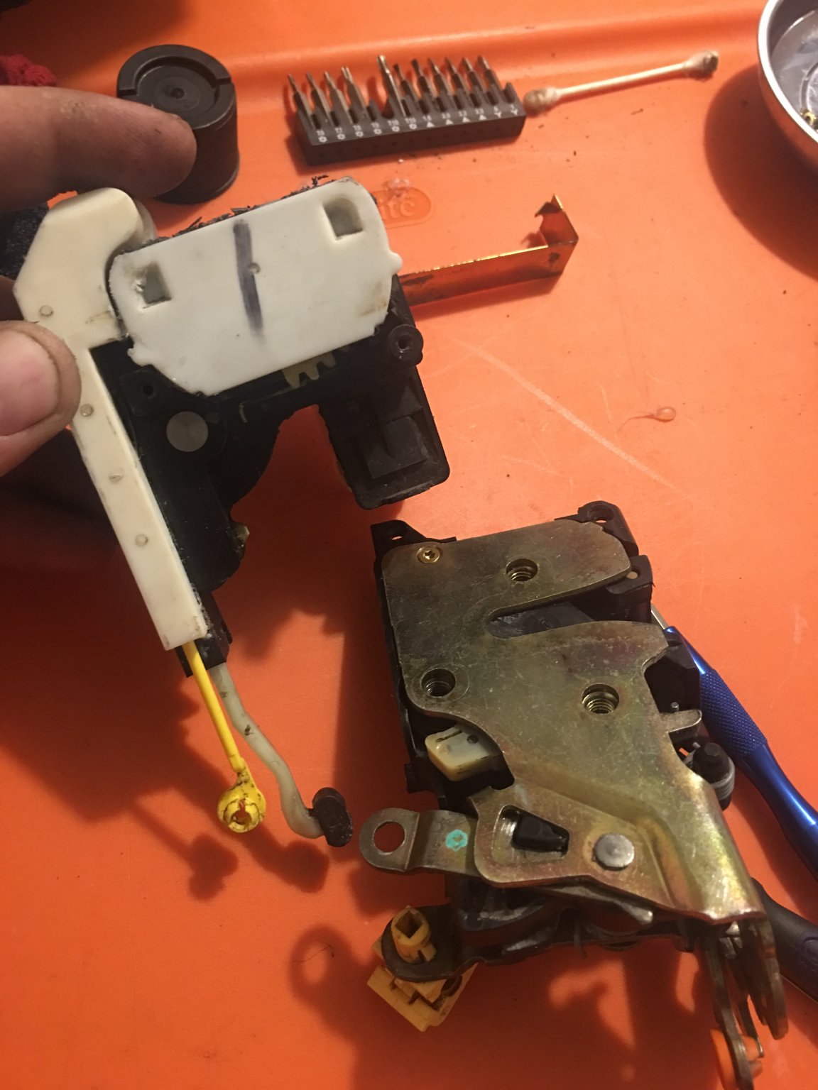

Good to know thanks for the info! That's one thing I wanna try and dive into in the next couple weeks as the ski season dies down and I'm not working crazy amounts of hours.Just needs to be cleaned! The contacts in the switch built up a bit of corrosion making poor/no connection, dissabling it.
Why buy a new one $$$ when you can just clean it.
I appreciate @iamdub! When I couldn't find any info on this I figured someone else may come across this issue and be completely lost. I like to pitch in when I can and if I can help save someone a headache, some time and money while doing so then mission accomplished!
