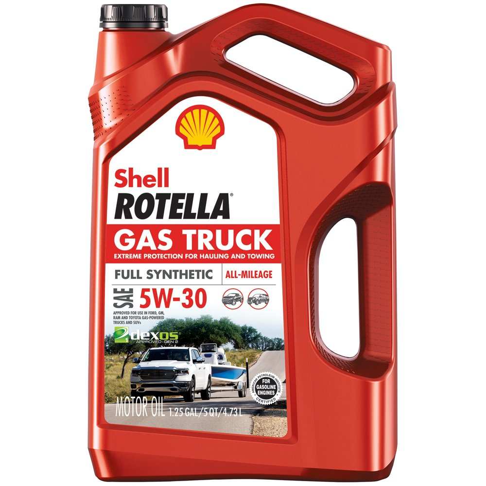

Yes 5W-30 when it was NEW !! No it's got 200K miles !! Was told by many folks 10W30 wont make much of a difference??? But winter is coming and moving to Chicago area soon so I'm changing oil filter again and use Shell rotella gas/truck I have in my oil stash
Manual Fuel pressure not option at moment

Hmmmm Maybe small chance the Fram XG oil filter is defective and messing up my oil PSI ??
Gonna change to new K&N oil filter this week and use this "Awesome sauce" oil since I have like 100 qts of it from Walmart/Autozone clearance sale 2019/2020 ;)
