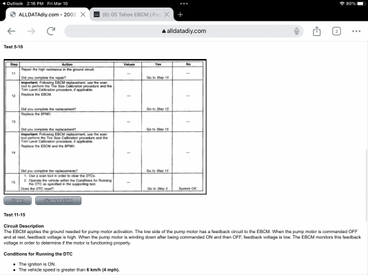

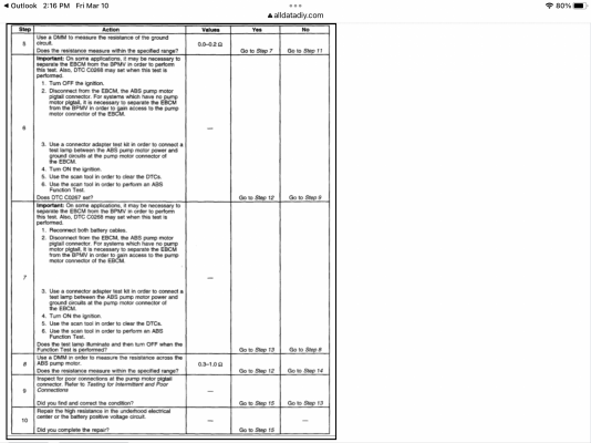

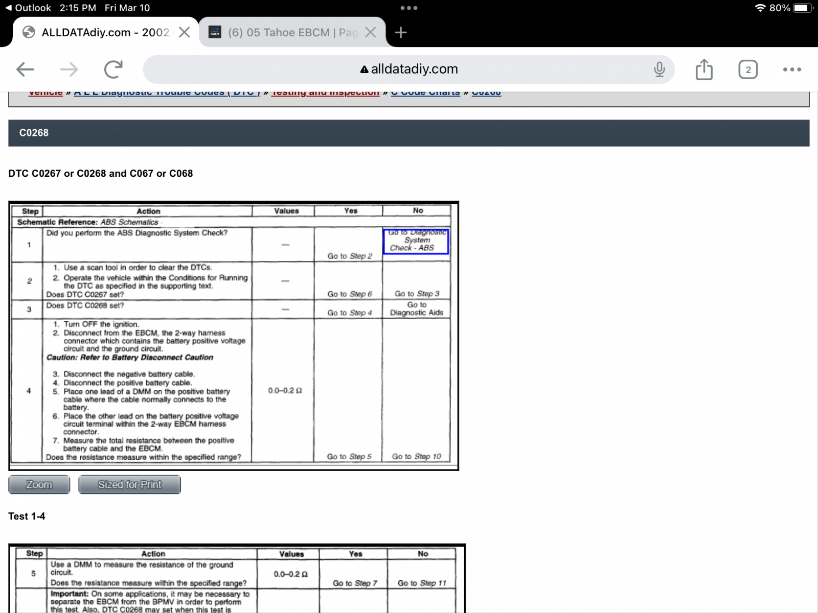

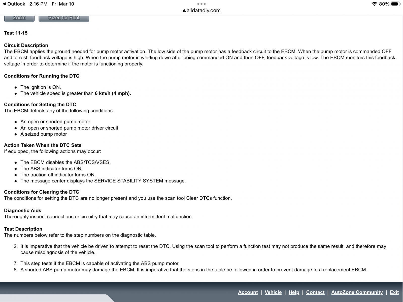

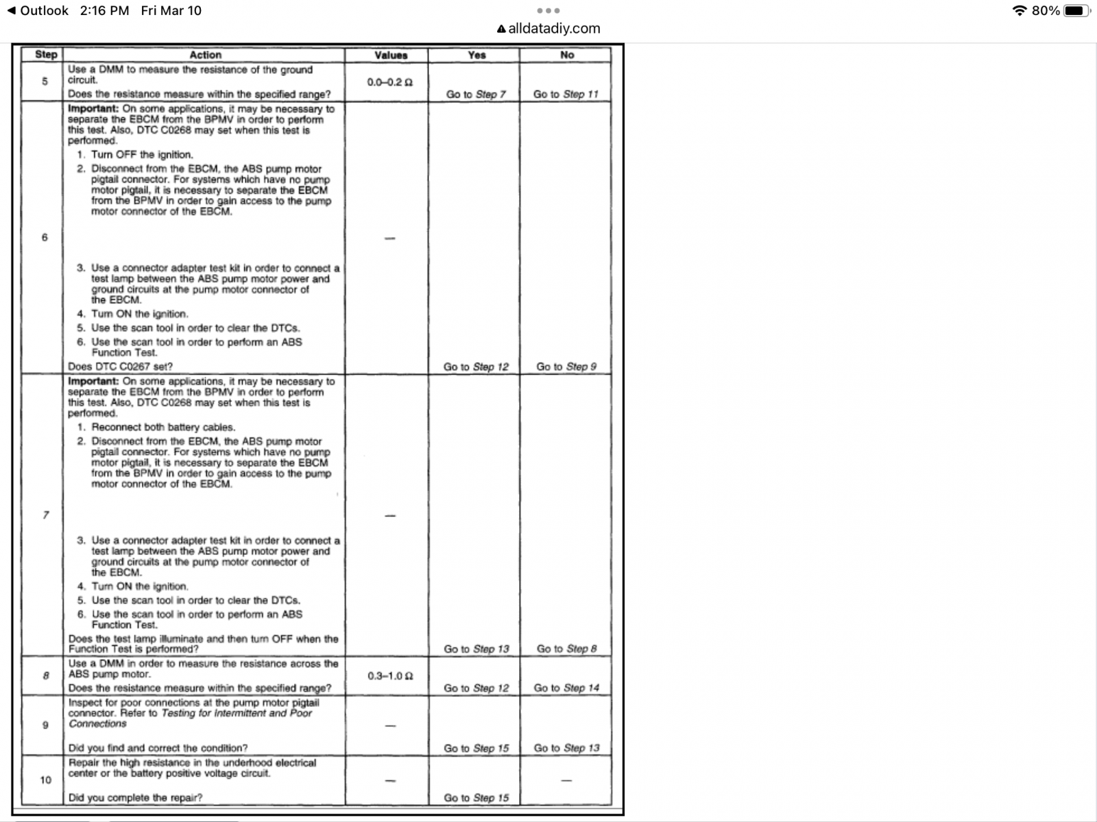

You don’t need to worry about the fluid- replacing the EBCM won’t let the brake fluid leak. Here’s 4 screenshots from my alldatadiy for my 02 which will be the same procedure. This shows “ without JL4” which is the RPO code for traction control but I looked and the instructions are the same for both types.

Why? Just follow the service manual procedure which is outlined in the steps I posted in those screenshots. You just need to lower it enough to get to the EBCM screws unless I’m missing something? There should be enough flexibility to access the screws.

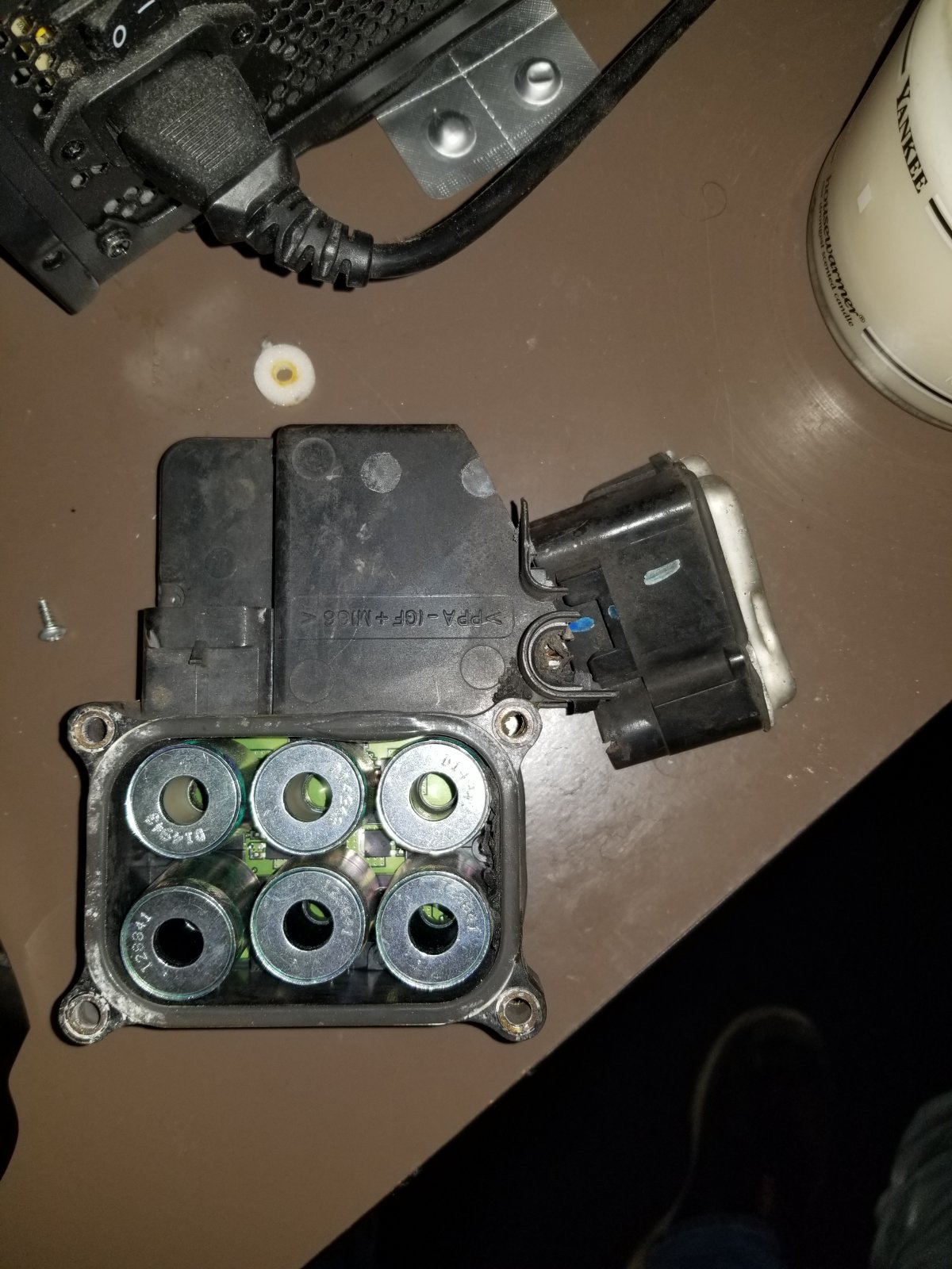

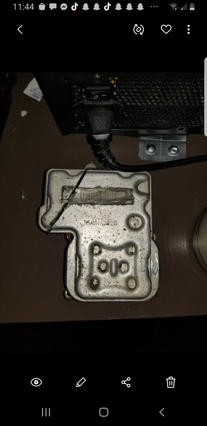

he did and it happened to me as well in which case the ebcm was simply cut off with a saw, the pump wasn't removed.
and when replacing the ebcm it has to be the exact same part number, no programming is required, plug-n-play
the part number is stamped on the top of the ebcm
taking the ebcm off does not allow air or anything to enter the pump.

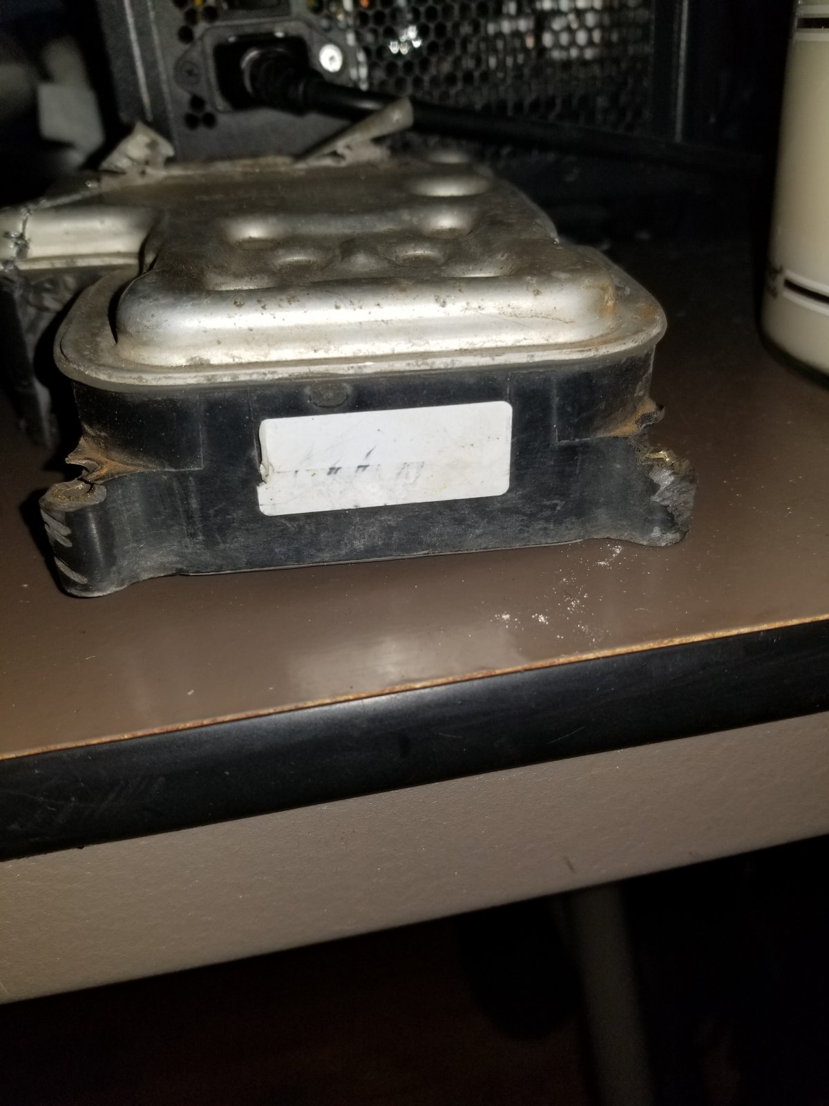

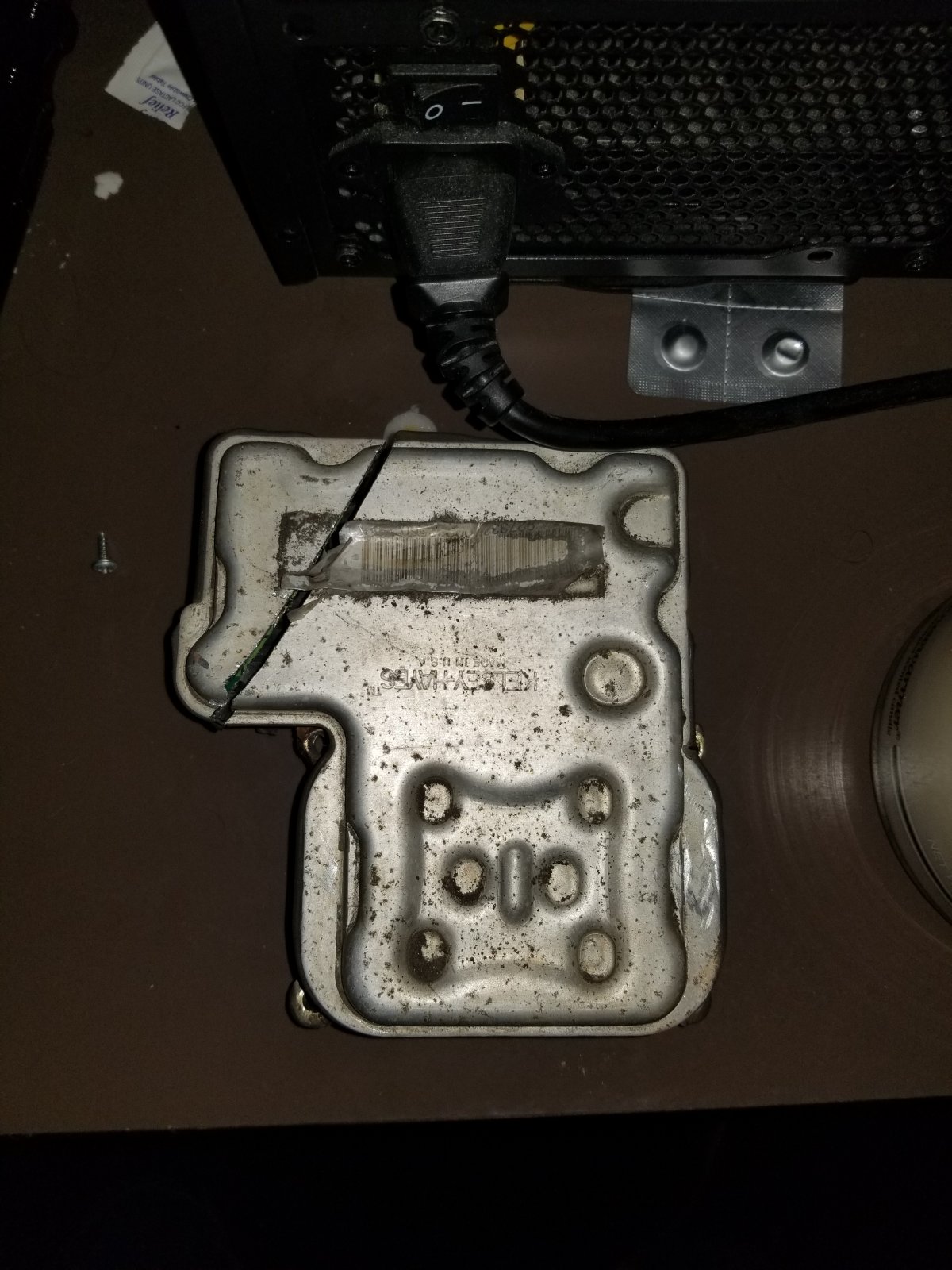

What kind of saw aswell? Scared I'd cut into the pump
