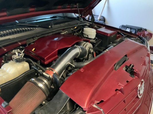

Work continues on the engine cover. This is the rough finish mold on the engine to confirm general fit. I'll need to do some trimming for hoses and cables and add openings for the oil fill and transmission dip stick. I'll do all that on the actual cover. Next, comes bondo, primer, gelcoat and wax. Then I'll be ready to do some fiberglassing to make the final mold.
Finished the plug used to make the fiberglass mold for the new engine cover.

After some mistakes and start overs, I finally managed to fabricate a new engine cover. Just finished painting it. Here are photos

Engine cover looks really good.
