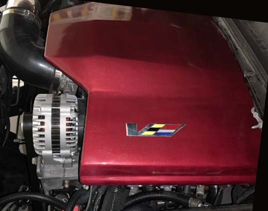

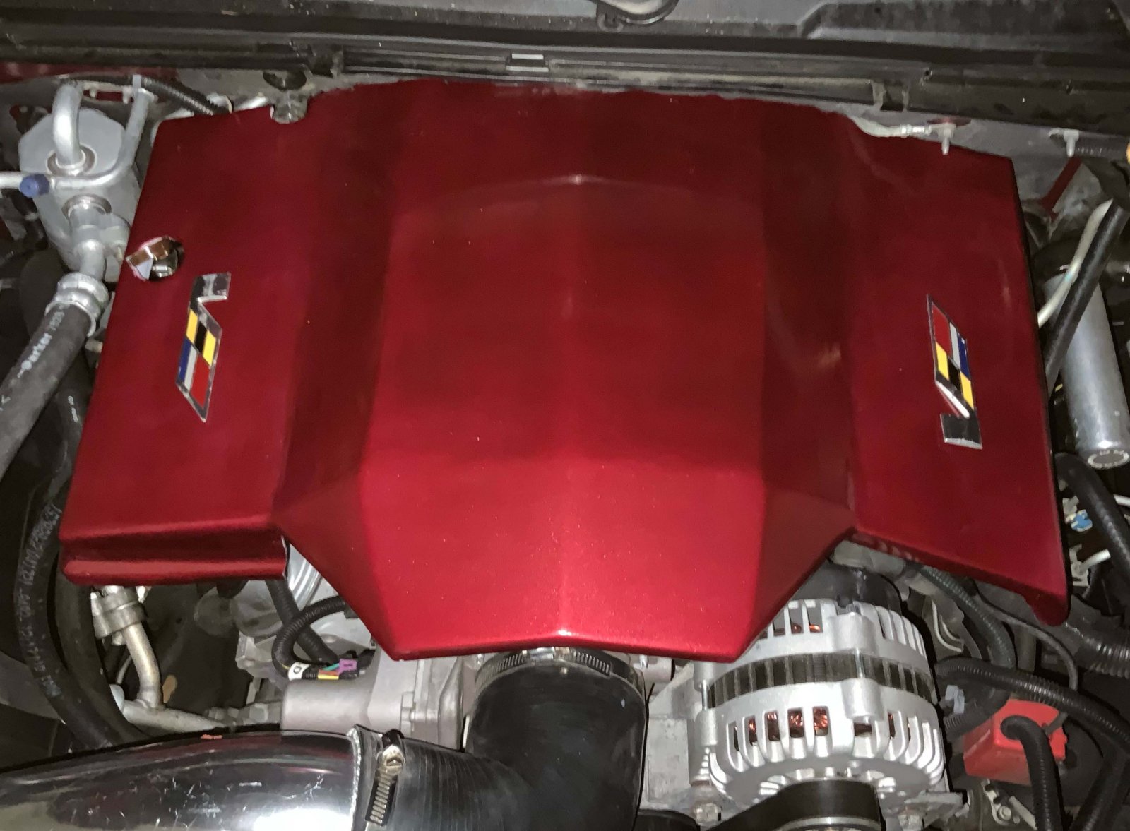

Added V badging and HP decals to the engine cover. To anticipate questions some may have about adding V badging: I built out the Escalade with the idea of what Cadillac could have done had they decided to make an Escalade V back in '06. In hotrodese, mine is a V Tribute Escalade. No, it's not supercharged. No, I have no plans to add a supercharger. This engine is Spec'd by GM Performance at 452hp and 441lb-ft torque; and I'm satisfied with it's performance. Since Cadillac didn't offer superchargers on the CTS-V until '09 I have no problem with adding the V badging to my non-supercharged high performance, V Tribute Escalade.
