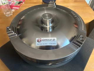

@NickTransmissions going through some older threads I saw you mention the thickness of the converter clutch being at least .050 thick and your builders are .070 thick.
The brand I'm looking at use woven carbon clutch packs and are a standard .020 thick. Lighter better materials but at what trade off. It's not a reman and it will also have a billet front plate.
What are your thoughts?

It's your money, do with it what you want but I have never heard of anyone making the trade off you mention above when it comes to converter clutches...Are you saying the "lighter" clutch somehow provides measurable gains over a thicker (and vastly superior) clutch? Or am I misunderstanding?
Billet covers arent needed unless high performance or frequent HD towing/hauling.
