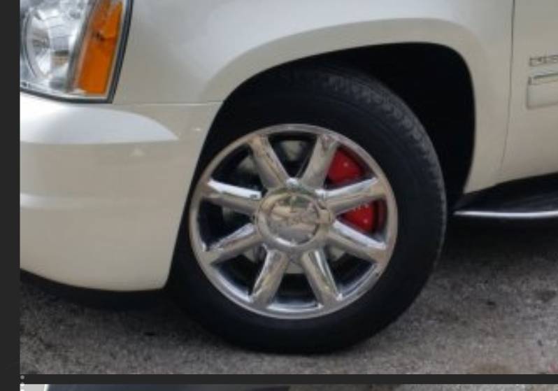

So here's my calipers painted up. Got a question tho before I start this swap tomorrow.
Am I ok to use DOT 3 brake fluid? The Wally has a gallon of DOT 3 for $16.00, & the DOT 3/4 shit is $15.00 a quart. So I got the gallon. a228da96a2050c52d27bf1926b9f0ee7.jpg162943bccfb0ab073c6b014d54106e12.jpg

Damn those came out good
Can't wait to see them installed.

These are the parts I used in my upgrade and I couldn't be happier with the performance and lack of noise. I know there are more aggressive pads/rotors but this works for me:
Calipers:
Drivers side: ACDelco 18FR2247
Passenger side: ACDelco 18FR2246
Pads: ACDelco 17D1363CH
Rotors: ACDelco Specialty Performance 18A1705SD

Good evening Thomas, yup that's the set I bought, I just checked my Amazon history. They are and have been working very well for me. Just a little dusting but never a squeal. I would buy them again. Hope this helps....
