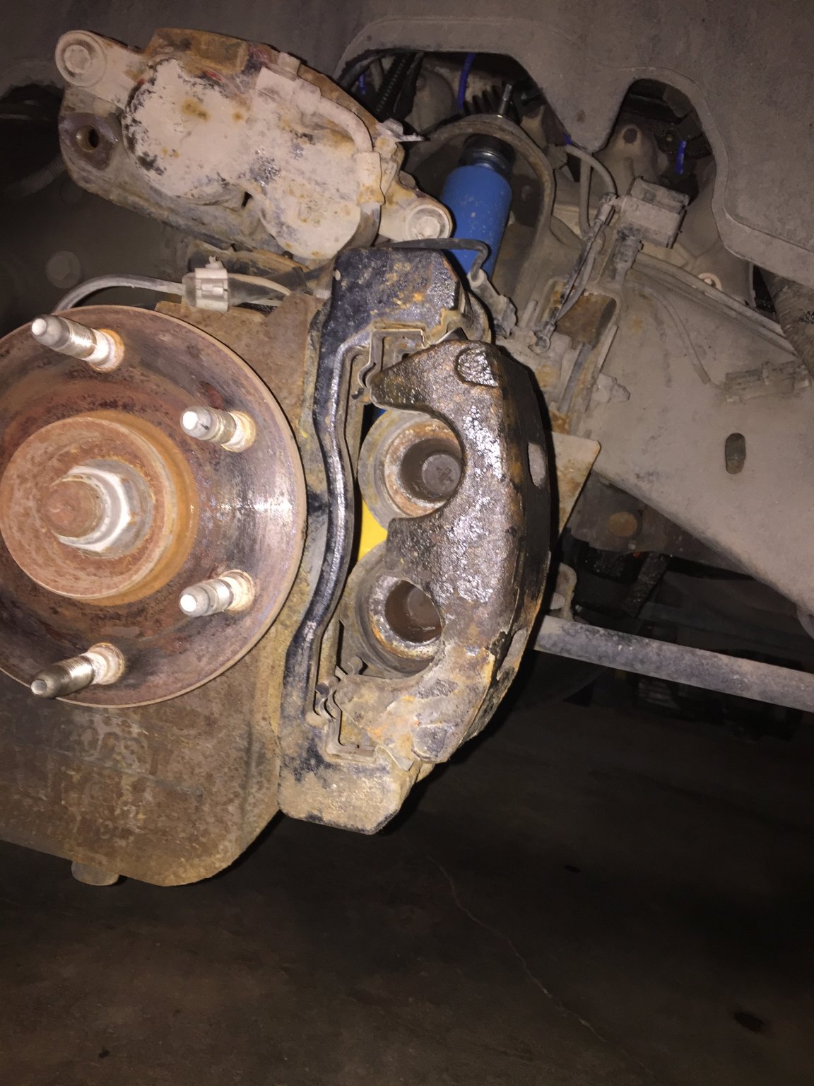

@Red Rocket & @TheAutumnWind are correct. I did the GMT-900 (NNBS) upgrade when I was on stock Denali 17's. There's no way you could fit a 14" rotor. I didn't take any measurements but I'm betting there was maybe half an inch of clearance between caliper and wheel. The only thing I miss about the 17's, it looked pretty aggressive.
