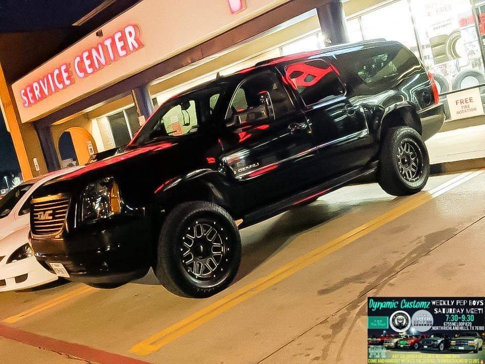

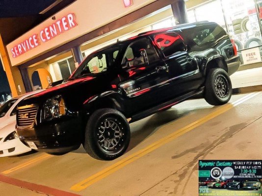

I've had my Denali for almost 3 years now. Finally got around to putting a 4" Ready Lift kit on it and some 315-70-17's. When I lifted it I deleted the autoride/auto level. I went with Bilstein 5100 shocks and struts. I did run into one issue with this lift kit on my vehicle. After it was installed and put back on the ground the rear was 1.5" lower than the front. Ready Lift didn't seem to know or have any solution to this problem. It ended up being the rear coil springs. Apparently at least for my 08 the coil spring is different in an autoride vs non autoride. After we swapped springs it leveled right out. For the wheels I went with American Racing Baja 17x9 with a -12mm offset. Tires are Goodyear Duratrac 315-70-17 and it required very minor trimming and a rubber mallet.
View media item 25840
View media item 25839
Is this a 4x4? I have a 2wd 09 Tahoe and struggling with the size of lift to put on it. This sits nice but I know 4x4 is already higher that 2wd so mine may not sit like this if I do that same lift. Great looking rig though!

The Denali is AWD. It always seemed like 4x4 Tahoes sat higher than mine stock. Maybe it was just an illusion though. Not sure I've ever compared a 2wd Tahoe to mine.
