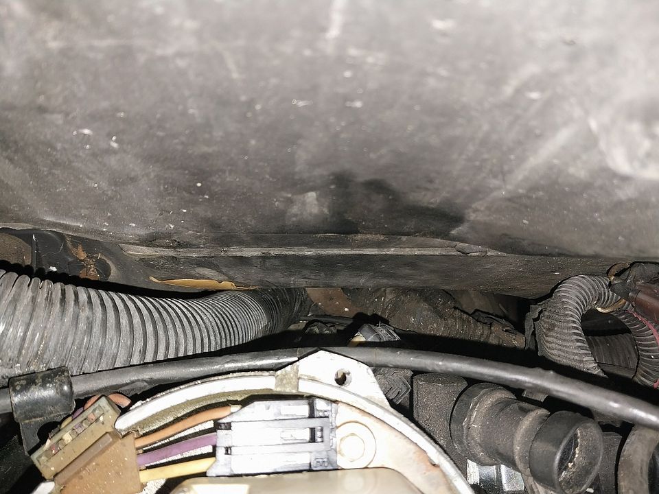

I got everything under the car put back into place and tidied up. Some interesting things learned, the P.O. said the exhaust had been worked on but did not elaborate. It turns out the pre-cats (I believe that is what they are called) and Y-Pipe had been replaced and the cat hollowed out at some point. We have no emissions testing in my county for this vintage of auto but the P.O. did have them in his county. I assume it passed emissions with just the pre-cats. The rest of the exhaust is stock and in near perfect condition with original mufflers. It took a lot of configuring of the exhaust piping to get it tucked back under there so the cross brace would fit, it was actually very difficult and I ended up using floor jacks to hold everything in the right position long enough to secure the bolts as it kept wanting to drop down enough to prevent the proper clearances. While I was under there I also cleaned up the fiberglass repairs as best I could and gave it a coating of Flex-Seal which matched the original undercoating nicely. I meant to get pics of that area but was so wiped out from exhaust pipe fun I forgot. The burn area got a coating of penetrating epoxy glass, thickened epoxy and sealer. It was a nightmare trying to sand that area in the tunnel with the tranny hanging so I did the best I could. I regret not getting any more pics of that area as it turned out decent considering what I was working with.
The inside of the burn area after repair and sealing, the sealer took longer to dry on the fresh epoxy than the older areas. This area as well as the floorboard repairs got sealed and a liberal coating of Flex-Seal after the sealer cured.
After getting the under side back as it should be I finished up the backup camera install and mounted a remote switch by the center console release button and seat switches. You would never know it was there and gives the ability to turn on the reverse camera at will, instead of only being functional in reverse. It is in a natural position to activate when your arm is resting on the console. To me, this was a better solution than opening up a huge can of worms trying to repair the transmission.
The underside work was a success, I now have a functioning speedo, reverse lights and backup camera. The cross brace is freshened up and properly secured as well as the burned tunnel glassed, repaired and sealed.

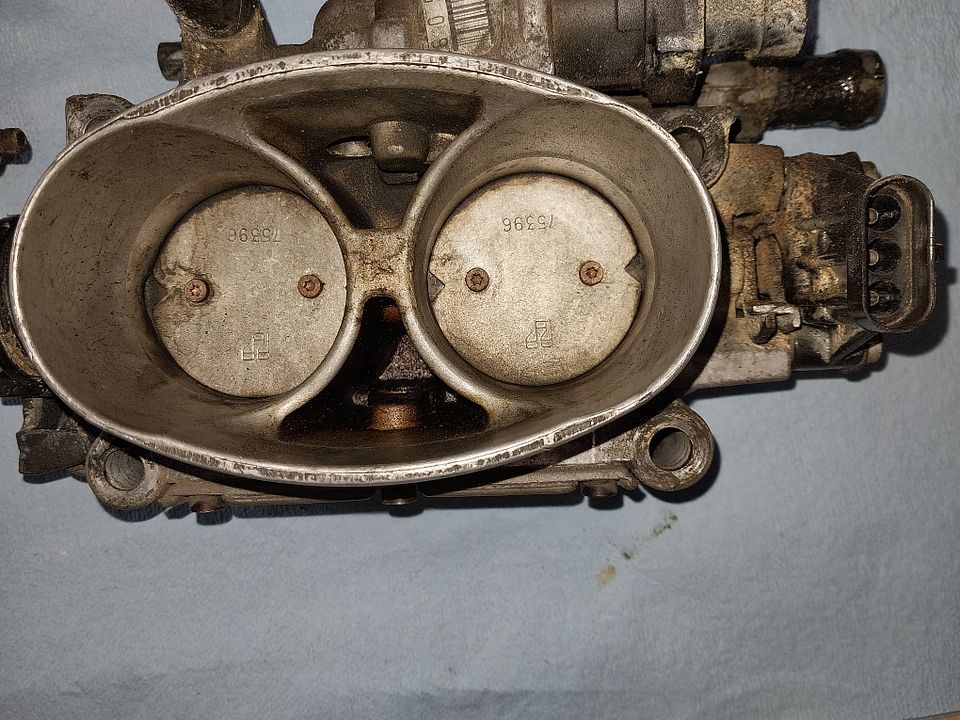

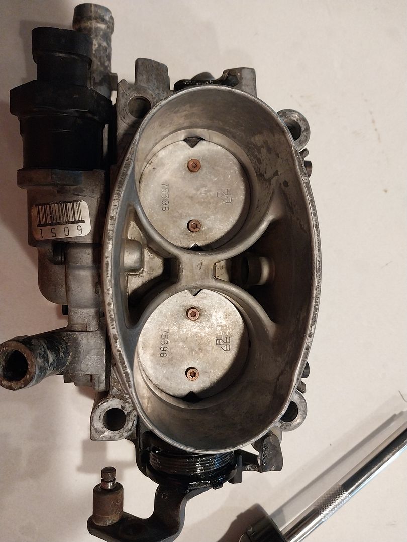

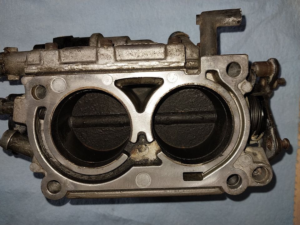

The next bit of fun was cleaning my throttle body and fixing various vacuum leaks. The car has an issue where it starts and idles at about 700 rpm's and as it warms up the idle increases to 1000 to 1100 rpm's, opposite of what it should be doing. I knew I had a few vacuum leaks and began tracking them down and replacing hoses as I get to areas. I needed to take the throttle body off for access and decided to go ahead and give it a thorough cleaning, new TPS and IAC. Bubba has been in here and the mess of hoses needed some attention.
Dirty and degusting TB...
Cleaner and less disgusting TB...
The new TPS will arrive today and the IAC a few weeks out. I very carefully cleaned and lubricated the old IAC and will put it back in place until the new one arrives. I have the IAC relearn process and TPS setting printed off and will get those done in the next day or so.

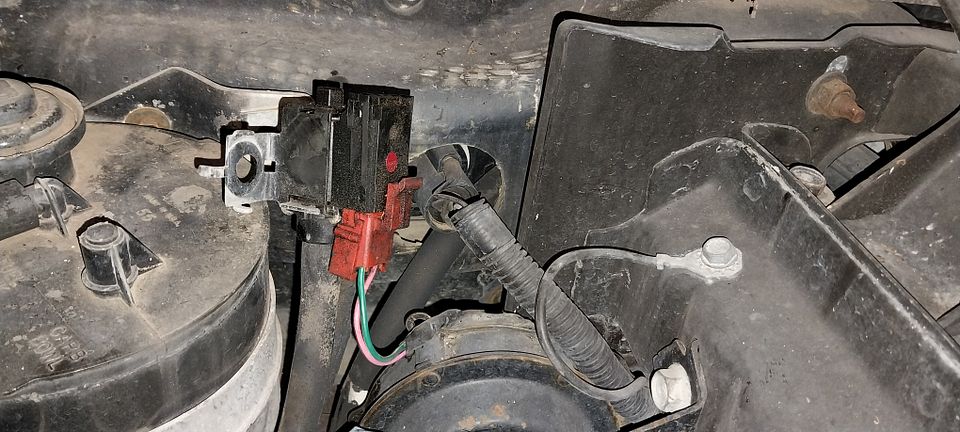

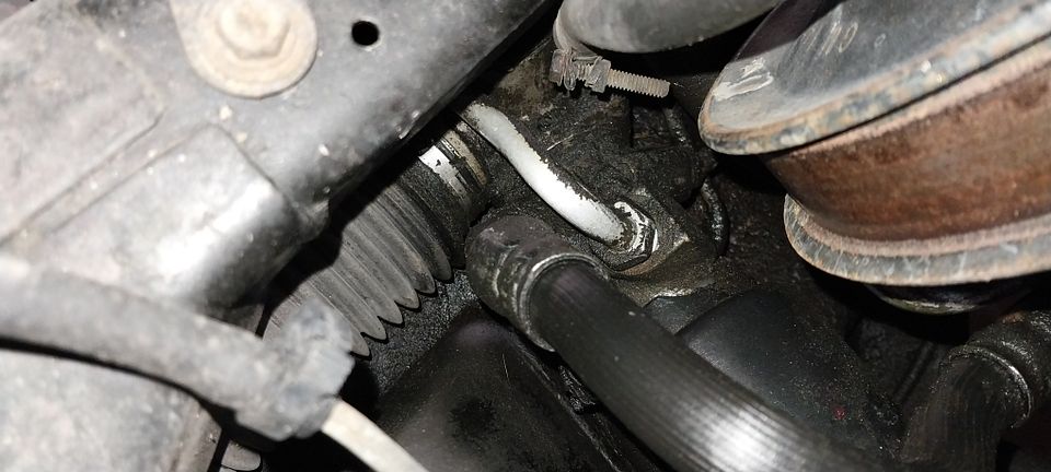

I got the AC low pressure switch installed, fan clutch kicks on but goes on and off every few seconds. I suspect the charge is actually low and that is causing the cycling. I am going to wait to recharge it as I want to replace the o-rings on the system first. It does cool well at the current state of charge but the temps were about 65 when I bypassed the low pressure switch so that attributed to the mistaken idea it was charged correctly.
While chasing vacuum leaks I found the HVAC/Cruise Control check valve "Tee" was missing the line to the HVAC, well, part of it is there and when I pulled it up it was obvious we have an issue. I believe the missing part goes behind the distributor and into this loom/bundle of wires going through the firewall. That bundle of wires is going to be fun to get my big hands on and find the missing tube, if it is in there. The plastic tubing on the check valve is sealed off and does not leak vacuum but I am sure the HVAC really needs that to function properly. I have a new GM replacement check valve already that I had bought when I decided I would replace all of the vacuum lines I could when the intake is out of the way.
Note the chewed spark plug wires, I hadn't seen those before so it is time to get some replacements on order, these look like GM original wires, which would be amazing if they are.
My fan runs constantly, I knew a prior Bubba had wired around them, time to correct this mess and see if the temp sensors and relays work correctly, I bought 4 or 5 relays awhile back just to have on hand.
The desiccated remains of a previous offender.

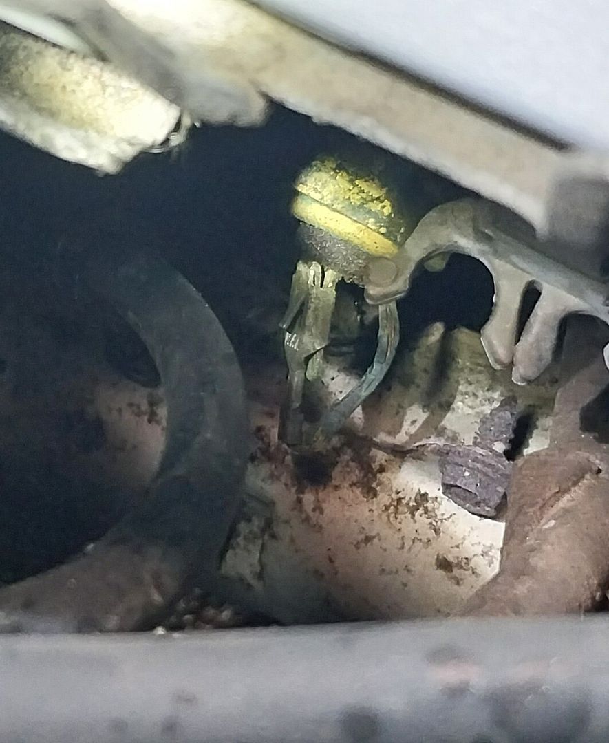

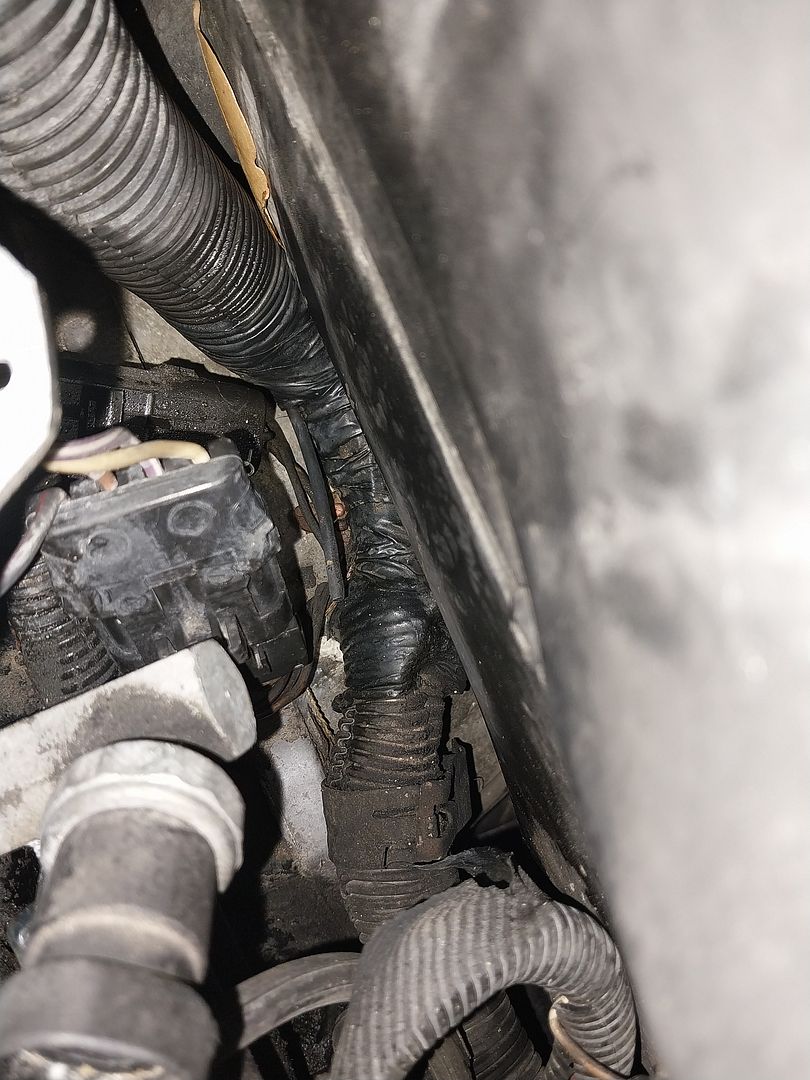

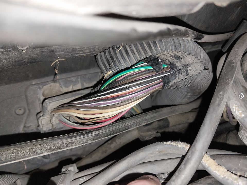

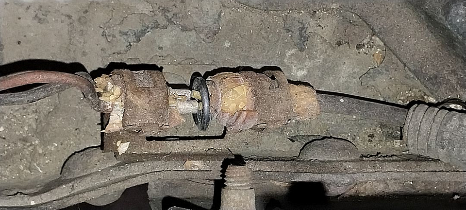

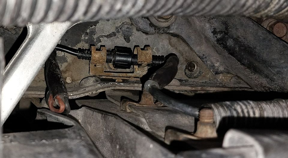

I really needed to get to the vacuum line for the HVAC but there really is no way I can get my booger hooks into that small space. In addition I had wanted to remove the air pump and had ordered a delete bracket to do the job. I started taking things off in preparation of the pump delete and decided to just keep going. Now is the time since I will so much apart so I decided to remove rest of the air system, solenoids/valves hoses/tubes and crap associated with it, replace the thermostat, the belt, vacuum lines, upper intake gaskets, replace the fuel rail o-rings, injector o-rings, paint the valve covers, clean upper intake, check over the gobs of wiring in hopes of eradicating Bubba and general condition checking and replacing of anything suspect. Yeah, it always snowballs.
The only hope I had of finding the broken HVAC vacuum tube was to get stuff out of the way. I took the cowl seal off, it was actually fairly easy, I removed the distributor cap and peered down into the abyss behind the engine. If was filthy back there, as expected, but I did find the melted vacuum tube, on the driver side of the dizzy, not where I expected to find it. It had not broken in the bundle of wires but instead melted well out of the wire bundle. That was good news! It was still an issue with my big hands and no room but at least I could see the problem. I was tempted to remove the distributor and still may if I see any evidence of leaks around the lower intake but the china rails are not leaking oil that I could find with a mirror.
The melted end of this...
...used to be attached to this...
Here is what it looked like when I discovered it.
I managed to use tools to cut the melted part off, attach a new silicone hose to it and route it back where it belongs. I did cleans as good as I could before attempting the repair.

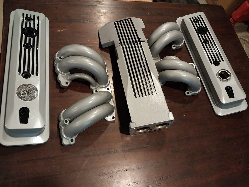

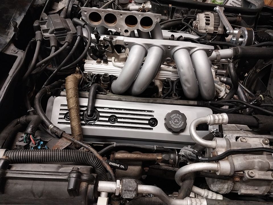

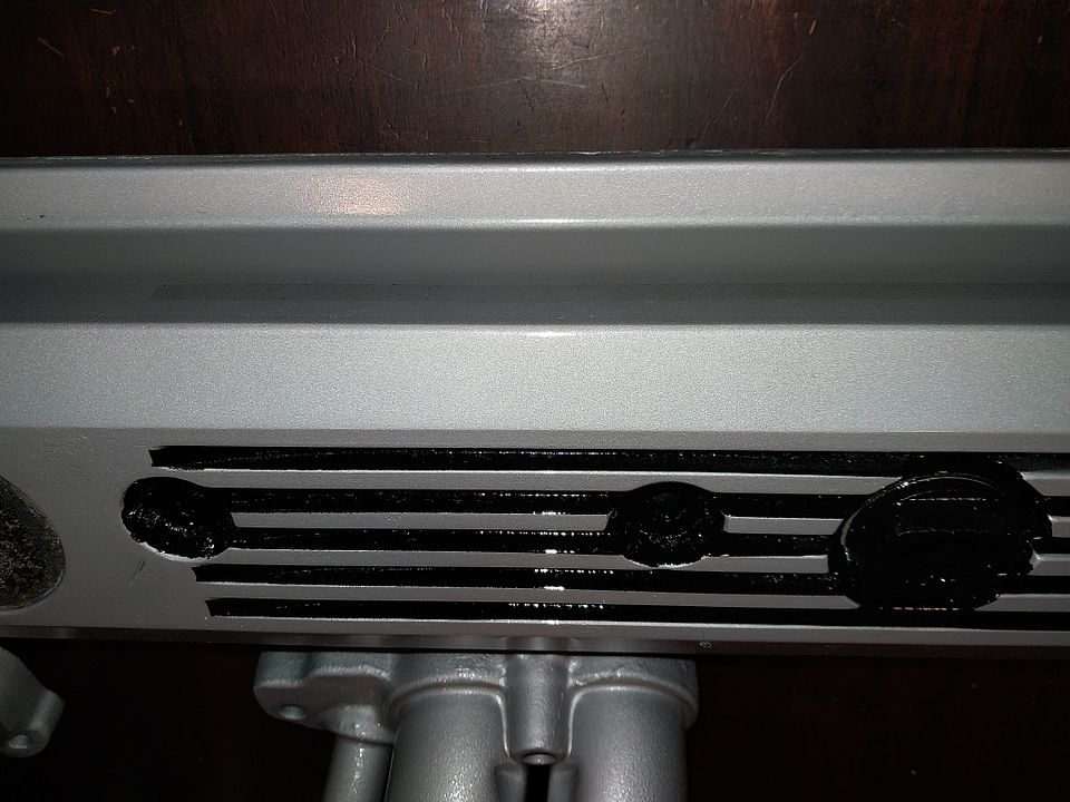

The bulk of this week has been cleaning the upper intake. The runners came extremely clean and bright, the plenum came clean but I cannot get it to match the brightness of the runners. I decided to paint them as well as the valve covers with High Heat Paint. Cleaned, sanded slightly, burned off, cleaned with alcohol, masked, primed with High Heat Primer, painted with Aluminum colored HH paint and cleared with HH clear.
In process...
I am going to paint the grooves in black instead of the red body color as I think red is overdone. I have yet to sand the valve covers, I am hoping to find someone local who can sand blast it for me. I managed to get all of the black soot/deposits from the runners and plenum, they were not bad but they did have a decent amount of buildup on them.

Since I had everything apart, I decided to tackle the valve covers. I tried sanding them to remove the factory finish, whatever it is, it is hard as a rock and tougher than my sandpaper. Those of us who are older remember when you could go to the hardware store and buy a paint stripper that actually worked, but that hasn't been the case in decades. I knew that my local Ace would have nothing to strip this rock hard coating, but O'Reilly's did, Aircraft Ultra Paint Remover. I was amazed at how well and quickly it bubbled up that finish. It is probably the most noxious smelling chemical I have used in a very long time, if ever and you absolutely have to use it outdoors, if trying to use indoors you will need a full respirator and a way to evacuate the fumes, it was absolutely brutal even outdoors. I stayed upwind of it, coated the valve covers, covered them in poly and let them cook for about 20 minutes. This was after round 1 and maybe half an hour of soaking and brushing off, I did a few more touch up rounds to get the rest of it off, especially the grooves and bolt holes.
I did a second coat on the areas that did not bubble up and managed to get about 95% of that coating off. I washed them afterwards with plain water and let them dry. The coating that did not come up was softened enough to be scraped and sanded. Though they did not come out perfect, there is no way I could have got them this good with sandpaper. I painted them with High heat Primer, Aluminum Paint and the "grooves" were painted in High Heat Black and then baked in the oven, first at 250 for 20 minutes, allowed to cool and then baked at 450 for 20 minutes. Before they get put back on the engine I will need to clean them good with acetone to remove tape residue that I did not see until they were baked. There are some nicks in the valve covers that I did not fill, these are mostly around the perimeter of the top and bottom, where they will never be visible so I left them alone. I did not see the point in trying to find a filler that would withstand the heat.
The rest of the intake got the same treatment, a very thorough cleaning, priming, painting and baking. This was a real pain the butt to mask but I am glad I took the time to carefully mask the sealing surfaces and anyplace two pieces touch, including the bolt holes. It should go back together exactly as it came apart with no issues from adding thickness of paint. The inside of the plenum and runners got very clean, I soaked everything in gas and used an extra long bottle brush to scrub the coking out of them.
The sealing surface of the runners is a little beat up, I may try leveling them off with a piece of float glass and some fine sandpaper. My wife wants to take a crack at re-painting the logo for the valve covers, if it doesn't come out good enough I will order a replacement.

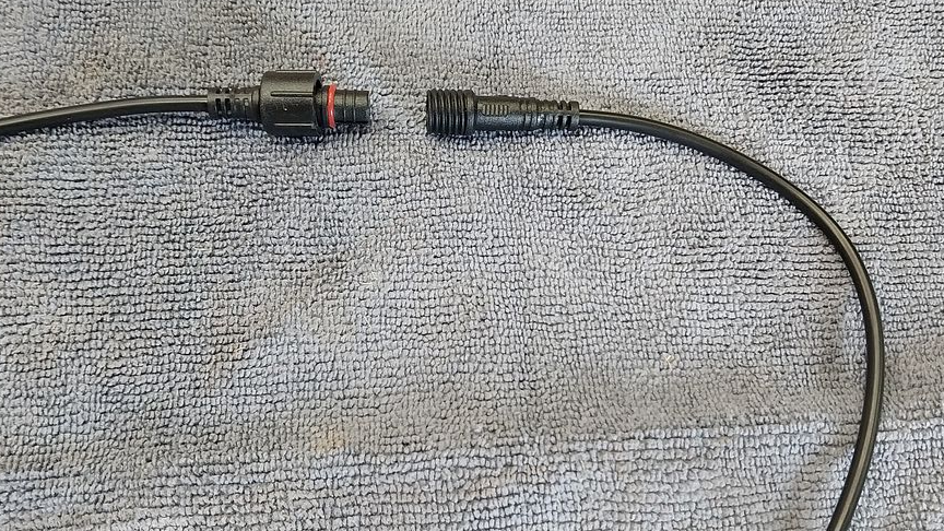

It was a good week, I got a lot done but not in picture format. I got the cooling system flushed, drained, rinsed and refilled. I got the new radiator hoses on, new serp belt on, cleaned and re-attached the temp sensor wire though I did not replace it, that will have to wait until I drop the exhaust to wrap it though the high temp wire came in. I cleaned the radiator shrouds and got everything associated with the cooling system finished including a 185 degree fail open t-stat.
The main fan had been direct wired by a previous owner so that when the key was on the main fan was on. I put everything back to stock according to the FSM and the main fan did not come on, I let the engine get all the way to 230 degrees before shutting it down. I replaced all of the relays, double checked the wiring and made sure the connectors and grounds were clean and correct. Still nothing, so I jumped the sensor in the intake to try and force the fan on, still nothing. I suspect something in the ECM is preventing the fans from coming on, everything else is correct but still not working.
I had previously ordered a new temperature switch for the aux pusher fan that comes on at 200 and goes off at 185. I used this as a trigger for both fans to come on and everything works as it should it just comes on sooner. The fans will probably not come on with the A/C but that may not be an issue as the fans come on at 200 degrees.
The only crappy pic I took...

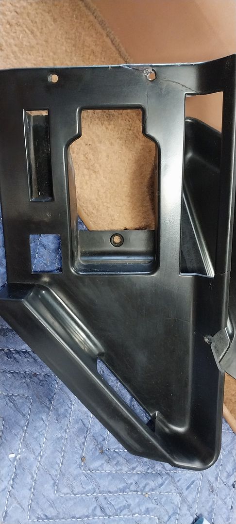

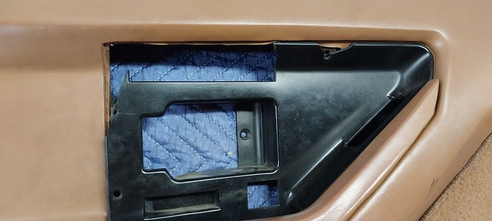

Time to start on the door cards, boy, what a mess. They were bad enough that I considered buying the re-pop ones but I have read very little positive about them as far as fitment goes. It also goes against the philosophy of this thread, so I jumped in with both feet and hands.
Let's start with the bezels, cracked, broken and fragile. These may get replaced so nothing is lost here.
Thickened epoxy and a little glass.
The top/right of the drivers door still had a broken out screw hole. I did not fix it because I know I have that piece somewhere and I would rather glass the original piece back in instead of making a thickened epoxy replacement. The original with a glass back is far more durable.
This was a quick and dirty repair since I may replace them, they are super brittle. The wiper switch got an LED bulb as did both courtesy lights.
