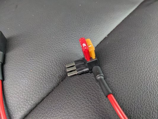

Thanks for this thread! It helped me install a VIOFO 129 Plus Duo dash cam on my 2024 Suburban.
I hardwired it using fuse 25 for BATTERY (always on) and fuse 26 for ACC (on with vehicle, stays on up 10 minutes after turning off vehicle or until you open the driver’s door), both of which are micro3. I used these fuse taps, which fit without modification! I replaced the included 15-amp tap circuit fuses with micro3 5-amp fuses. I connected ground to one of the nice grounds behind the kick-plate beneath the fuse box (as suggested above).
