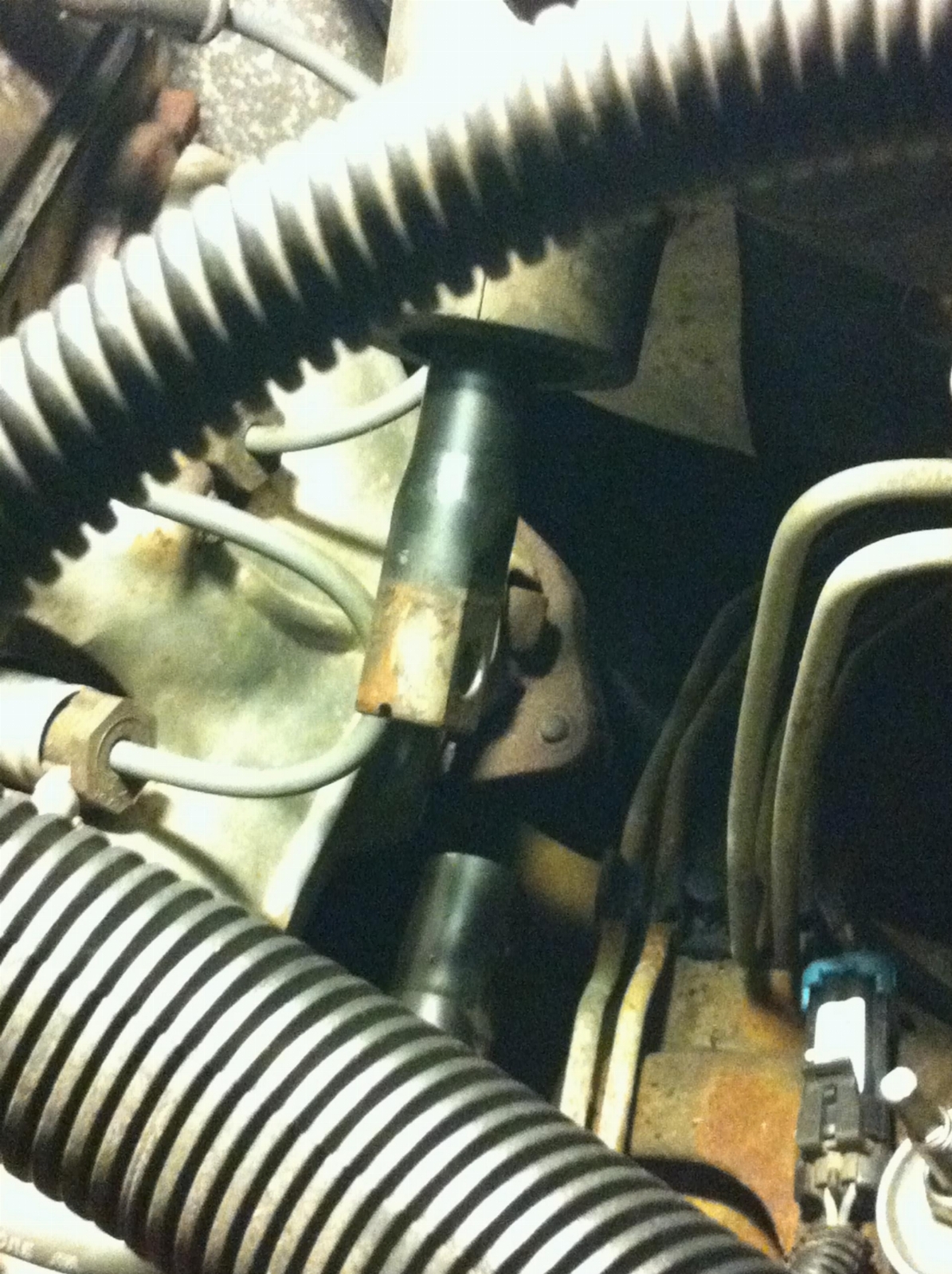

We had a huuuge rainstorm! I found that the rear carpet was getting soaked. The trim seemed OK at the rear hatch. What I did find is that the gromet that holds the wire loom in place seemed old and loose. I used some clear silicon sealant to hopefully take care of the leak.

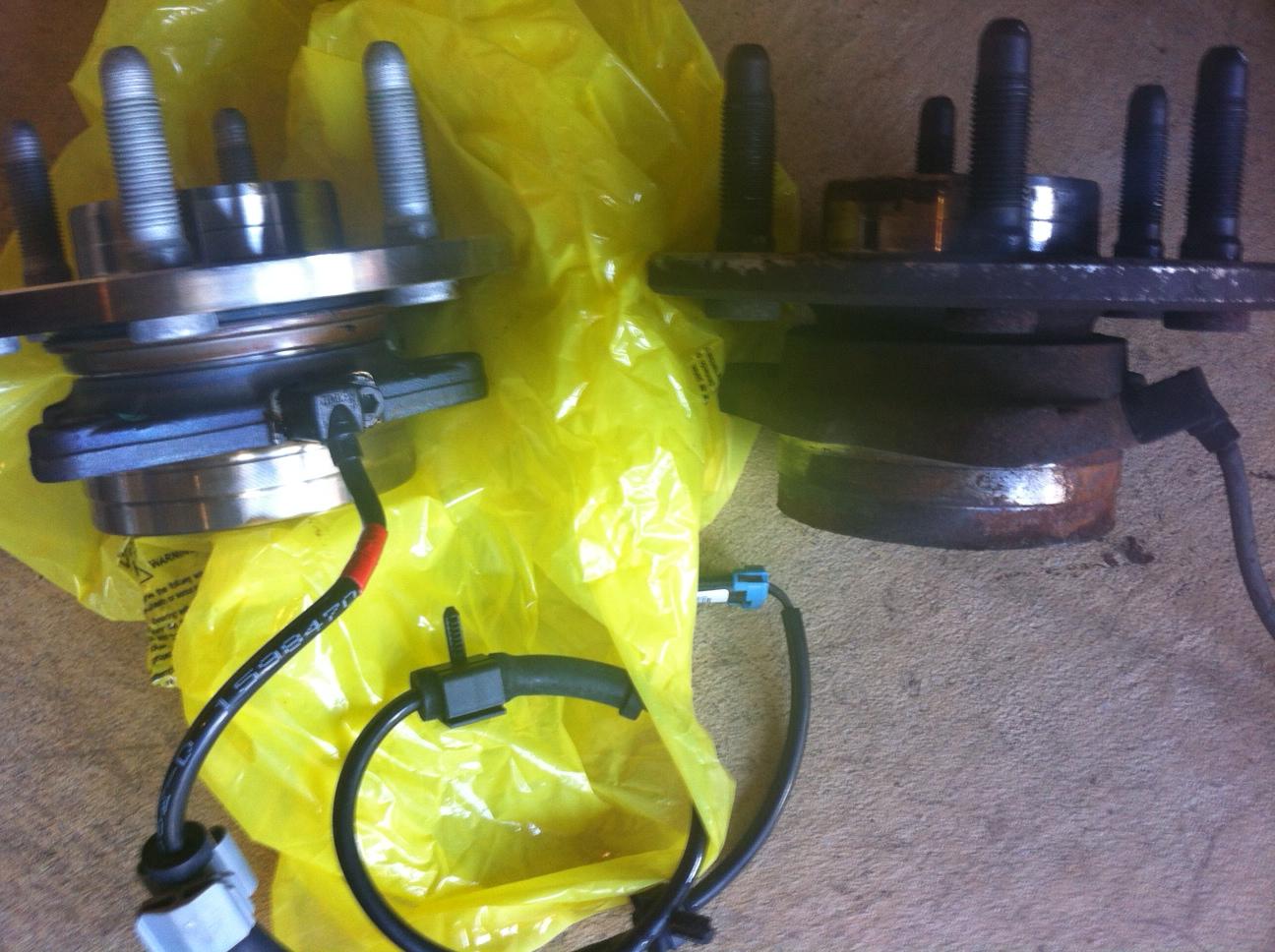

Crap, look what Amazon is shipping me..... I feel good and bad at the same time.
:emotions33:

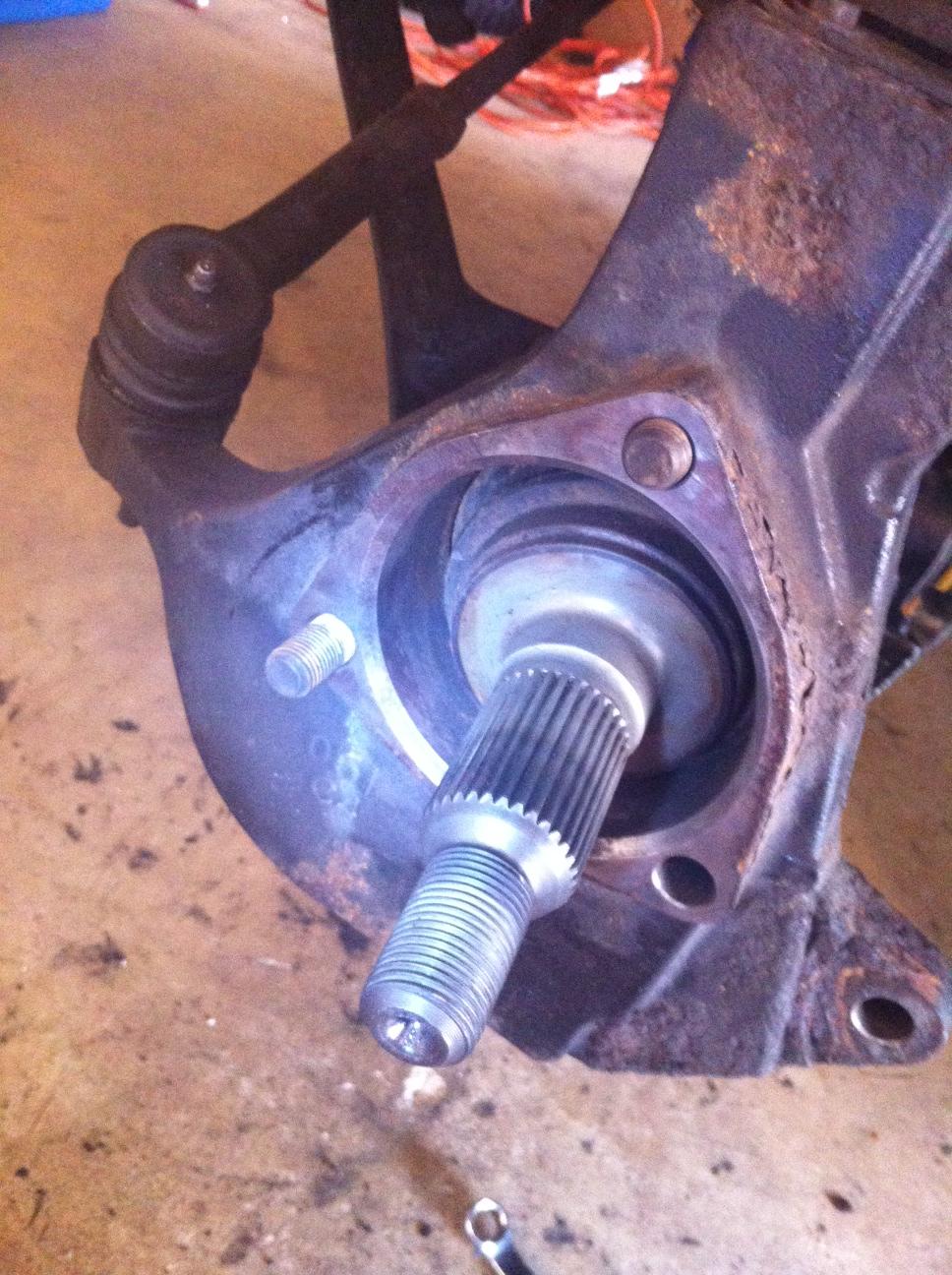

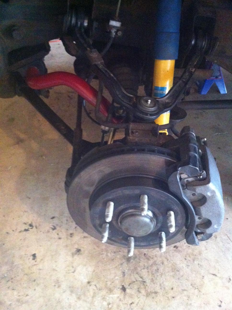

2 new front wheel bearing assemblies from Timken. The current ones have 141k miles on them and sound like metal scraping at higher speeds.
Eaibach sway bar kit. This truck is a real butt clencher in the turns. I'm used to more stability. I hope this helps.
