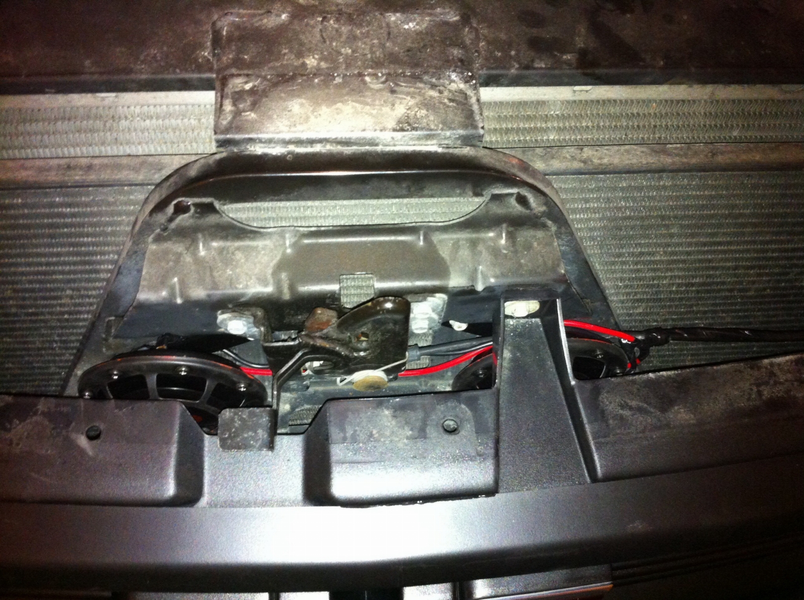

Fixed the steering clunk for a short amount of time. I used a grease gun with some thick royal purple stuff.
Tie down the wheel.
15mm bolt removed, clip in tube removed and grease gun up the nether regions.
