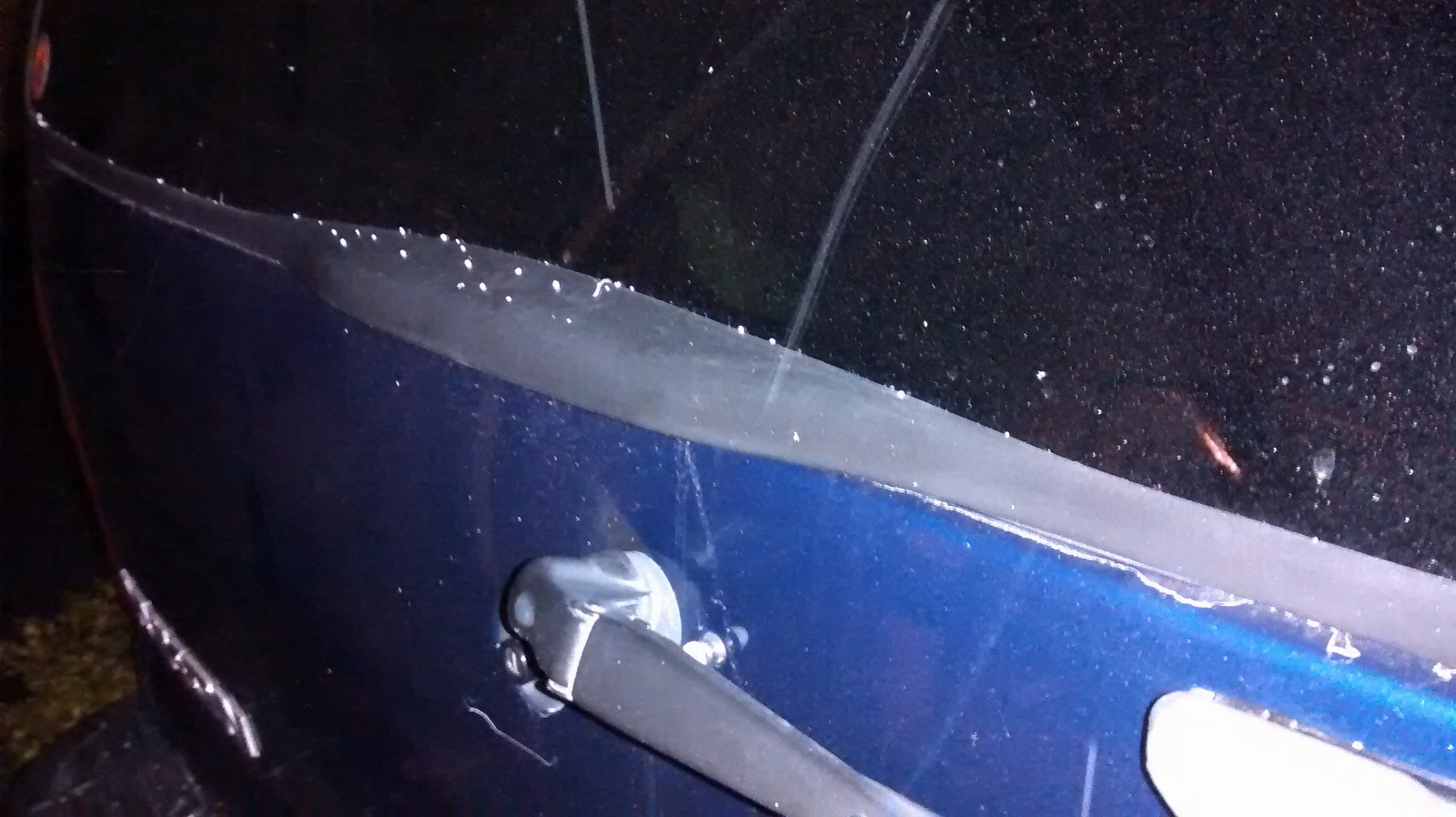

I fixed the drivers door molding that was peeling up and out. I first tried just some 20lb double sided tape by the molding was just pulling too hard, Next I took my time with a heat gun and softened the molding plastic, mostly shaped it flat and then stuck it on with more heat, massaging and whatnot. Time will tell if it holds.
