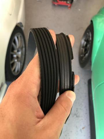

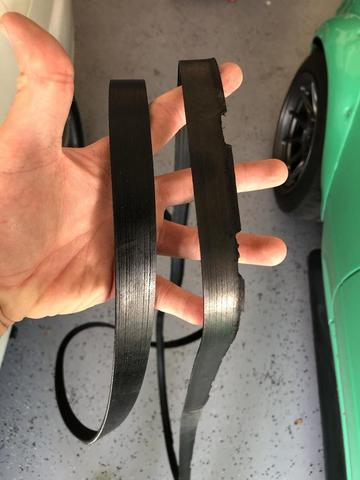

However, I need to do more maintenance as my main drive belt is getting shredded and about to let go. My AC compressor makes noise when engaged so I am thinking the clutch is seizing, Yay. I know it wont be anything spectacular, but I will take pics and upload for documentation purposes when I do those things.
