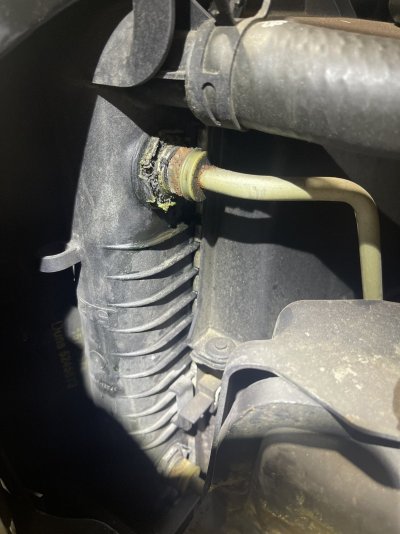

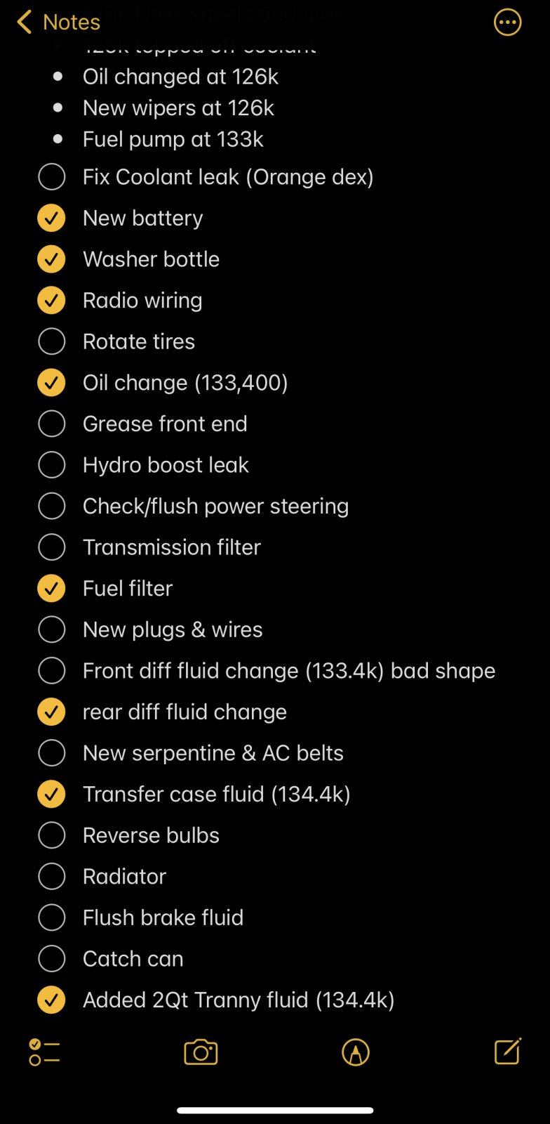

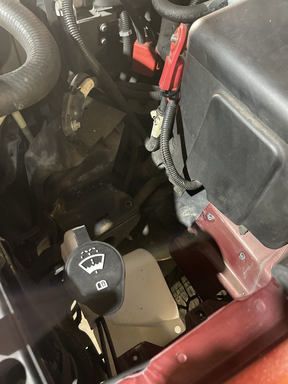

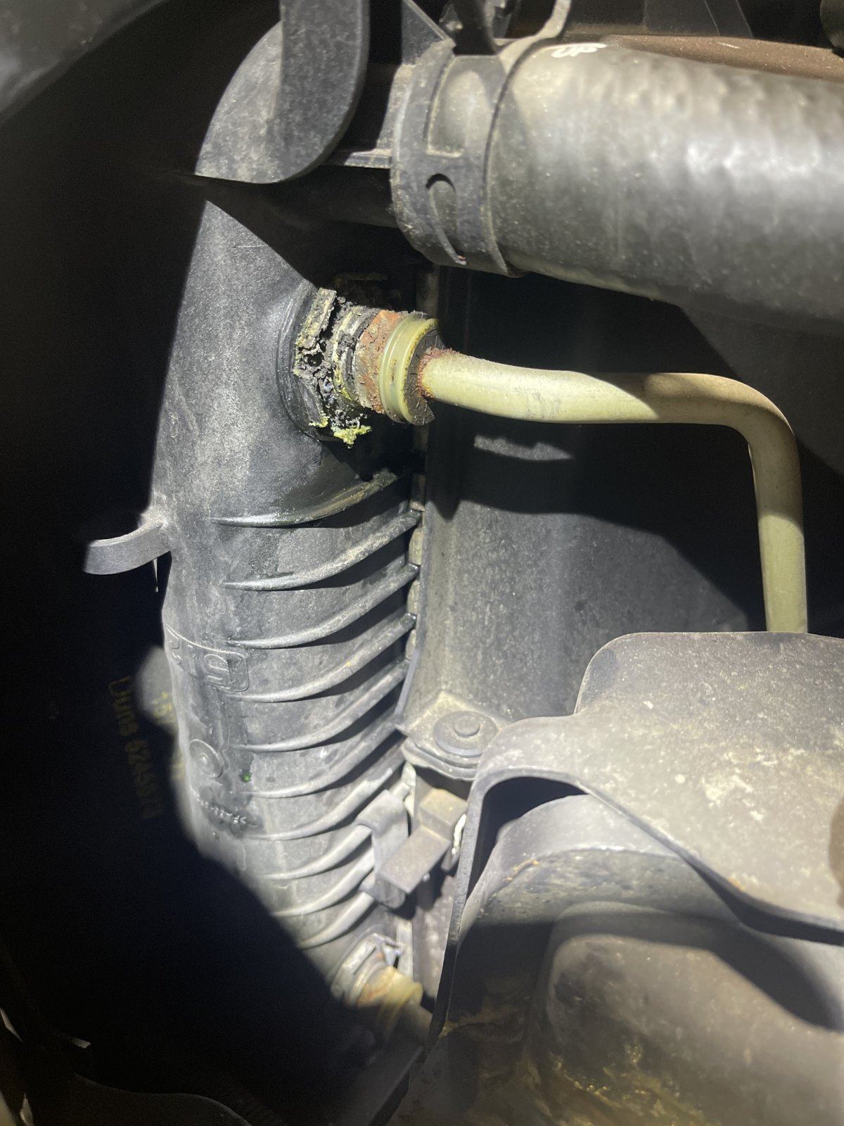

So today I did
-Wipers
-Oil change
-both diffs and t-case new fluids
-topped off coolant and power steering.
-removed a bunch of old brake fluid via turkey baster and added new.
I noticed a small coolant leak from one of the hard lines near the firewall. Running down the tranny dipstick. Anyone else have this issue?
Going to hit the frame with some rustolem or por15 in a few weeks once I get the shop cleaned up. Picked up a bunch of parts washers. Trying to get those sold/shipped this week.

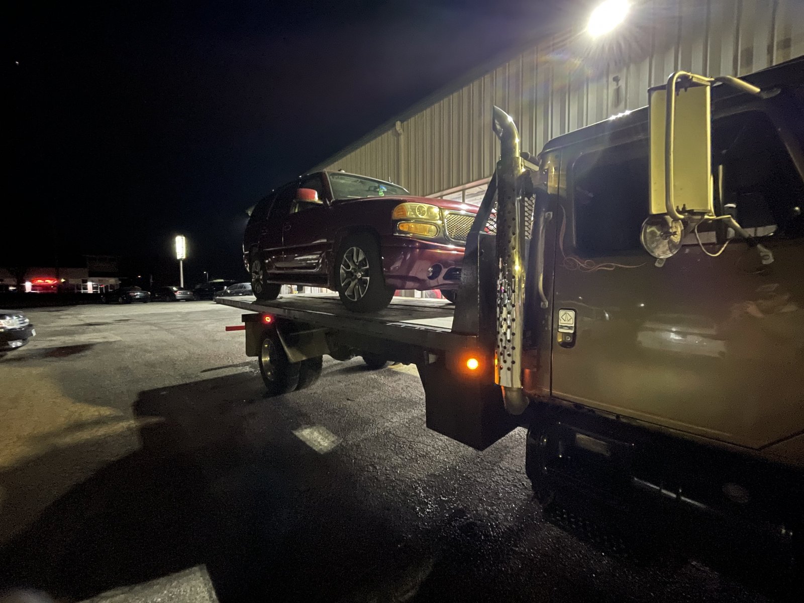

Plow truck got rekt today so have to spend the rest of the weekend working on that.
