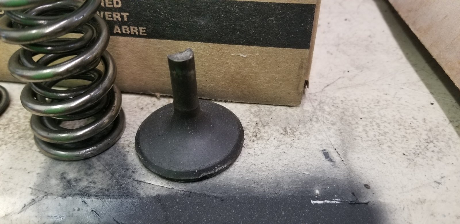

If you keep driving it, it's going to drop and a valve is going to kiss a piston which could create quite a mess, like a bent rod, busted piston and then it gets all chewed up in seconds and debris goes all through your motor trashing the whole thing. Mike was barely moving his when it let loose.
I had an exhaust leak once that sounded similar, thought it was a rod knock too. Then I got out my mechanic's stethoscope and located the source to my great relief. I'm the type that thinks of the worst scenario when something goes wrong with my car. Thankfully the guys here steer me straight.
That sounds like valvetrain. Seems it’s a higher pitch than a rod, at least from a video.
Yes! All the rod knocks I've heard were more manly! Then when Mike posted his old videos he called it.
Hopefully the OP leaves it alone and calls LT on Monday morning. Then if he'll take it in, tow it there to be on the safe side.
