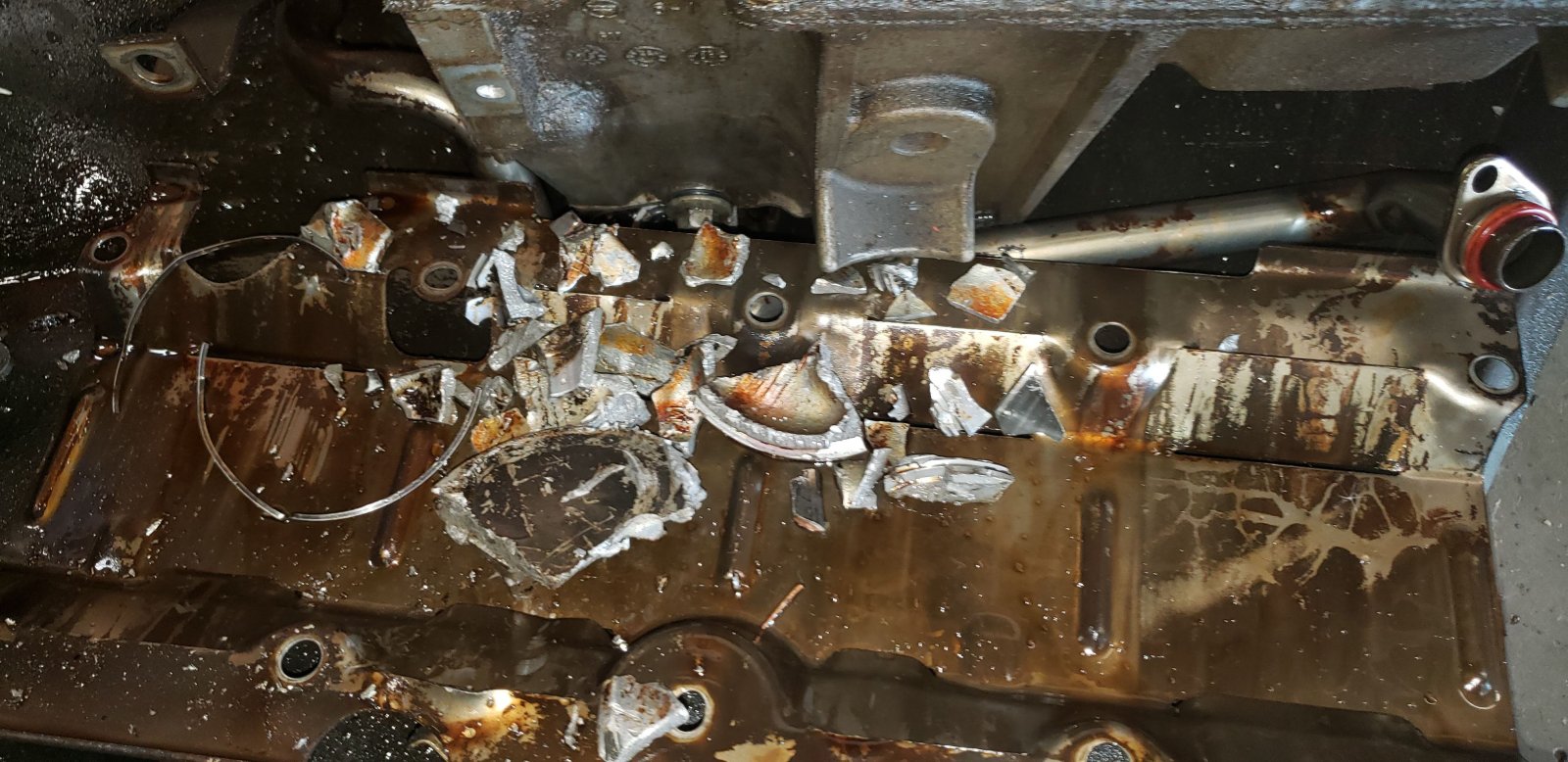

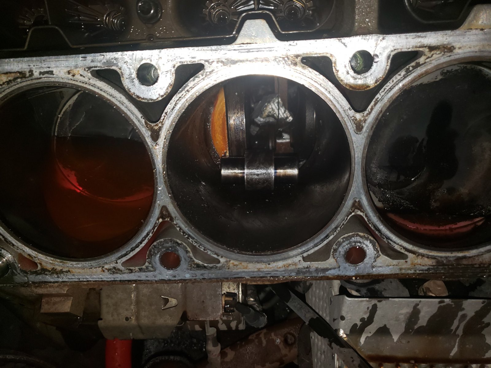

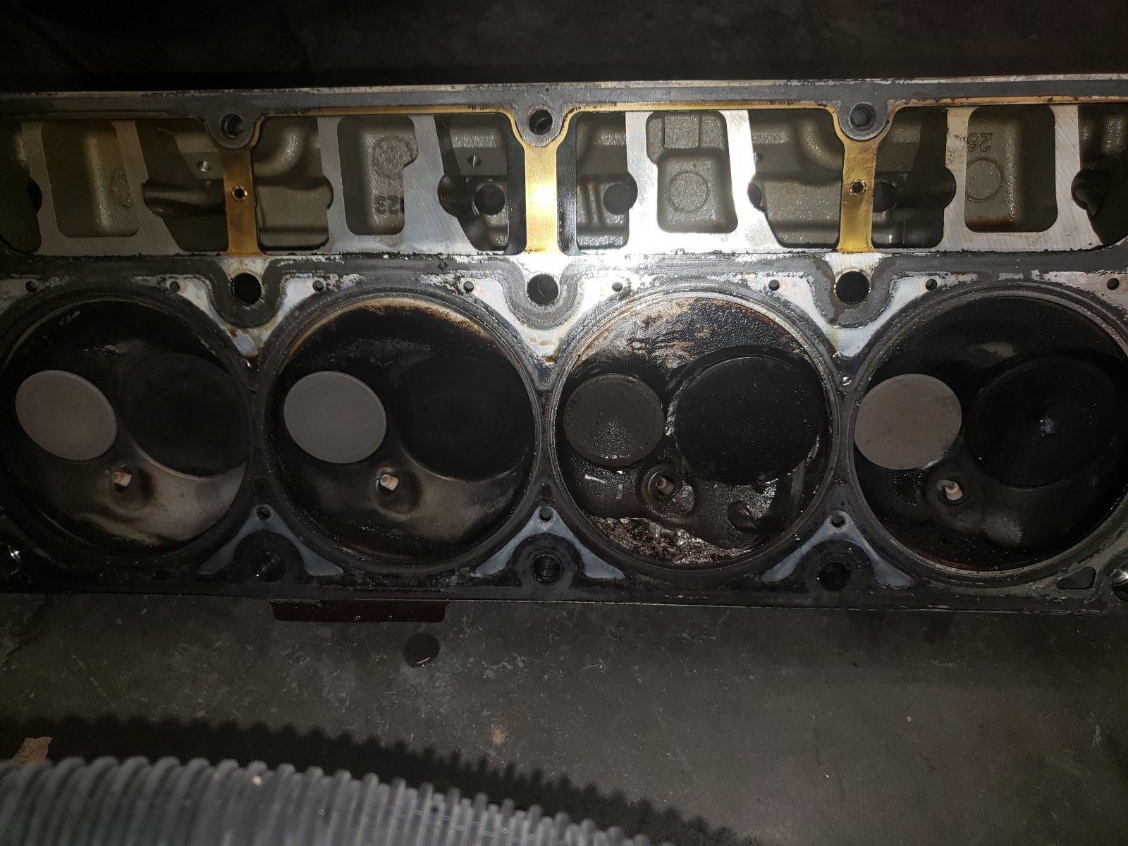

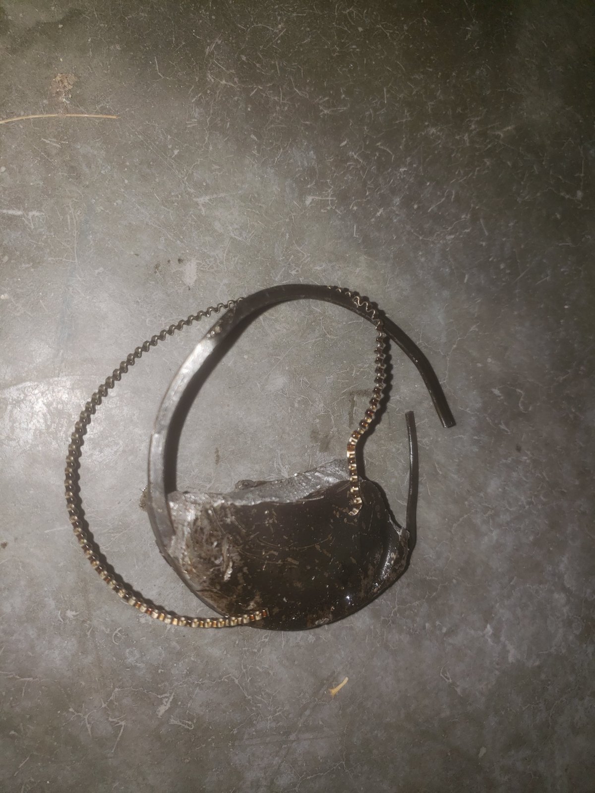

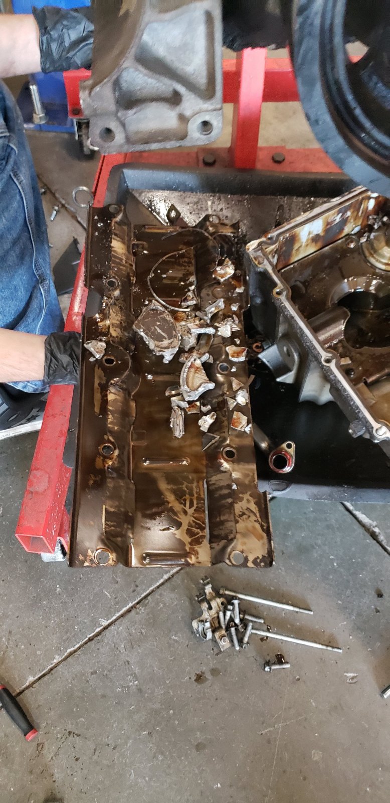

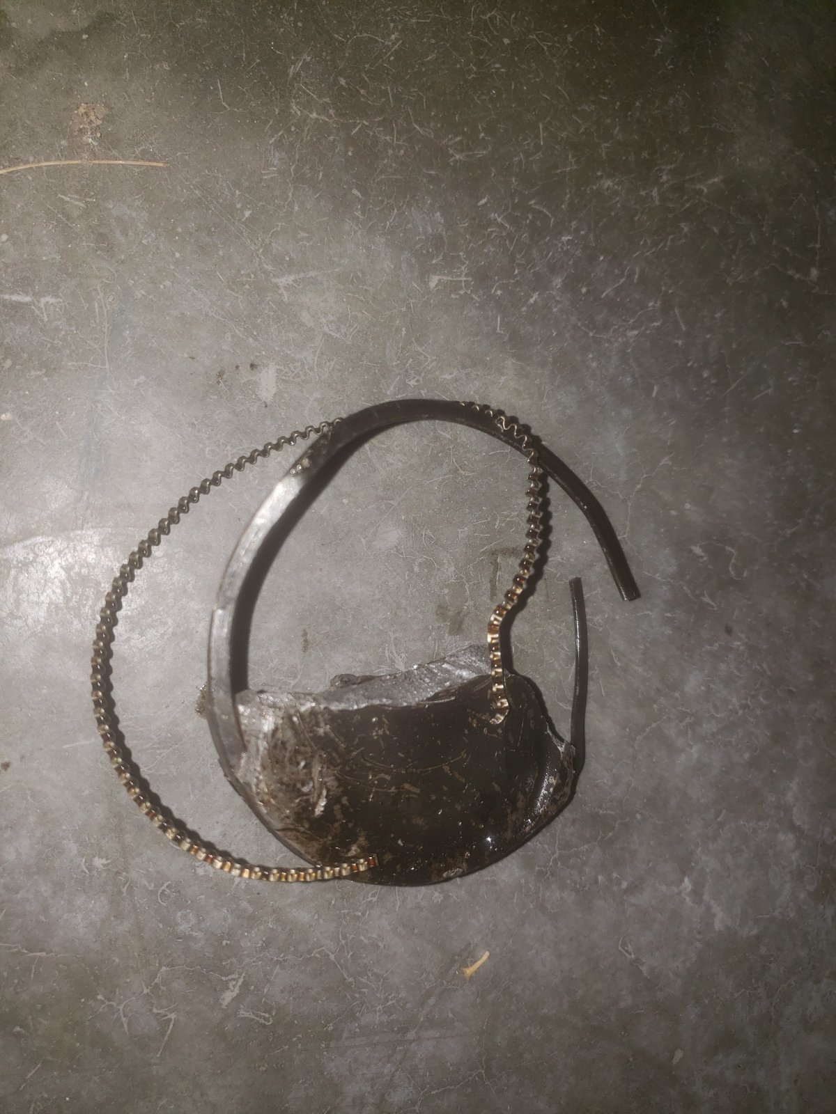

Interesting tidbit about the piston rings. The guy I bought the 2009 from in Texas said it had piston slap from day one and GM wouldn't do anything about it. After dealing with him I realized his a sheister (owns a construction company, go figure) because maintenance wasn't his strong point.
That may explain piston slap that NEVER went away and then turned into an oil burner after a hard run.
If you ever see a 2020 black escalade for sale in the future from the Dallas area from a guy who owns stated company beware....LOL
Not like I could afford one but the newer GM trucks seem to have really terrible quality control issues with the power trains. I wanted a non-AFM truck so I was only looking for ones that had a 2 or an 8 as their engine code in the VIN for the 2008-2009 Denalis. This one did with the L9H so I figured (if well maintained lol) it might be a good one. Oh well hard lesson to learn for sure!
