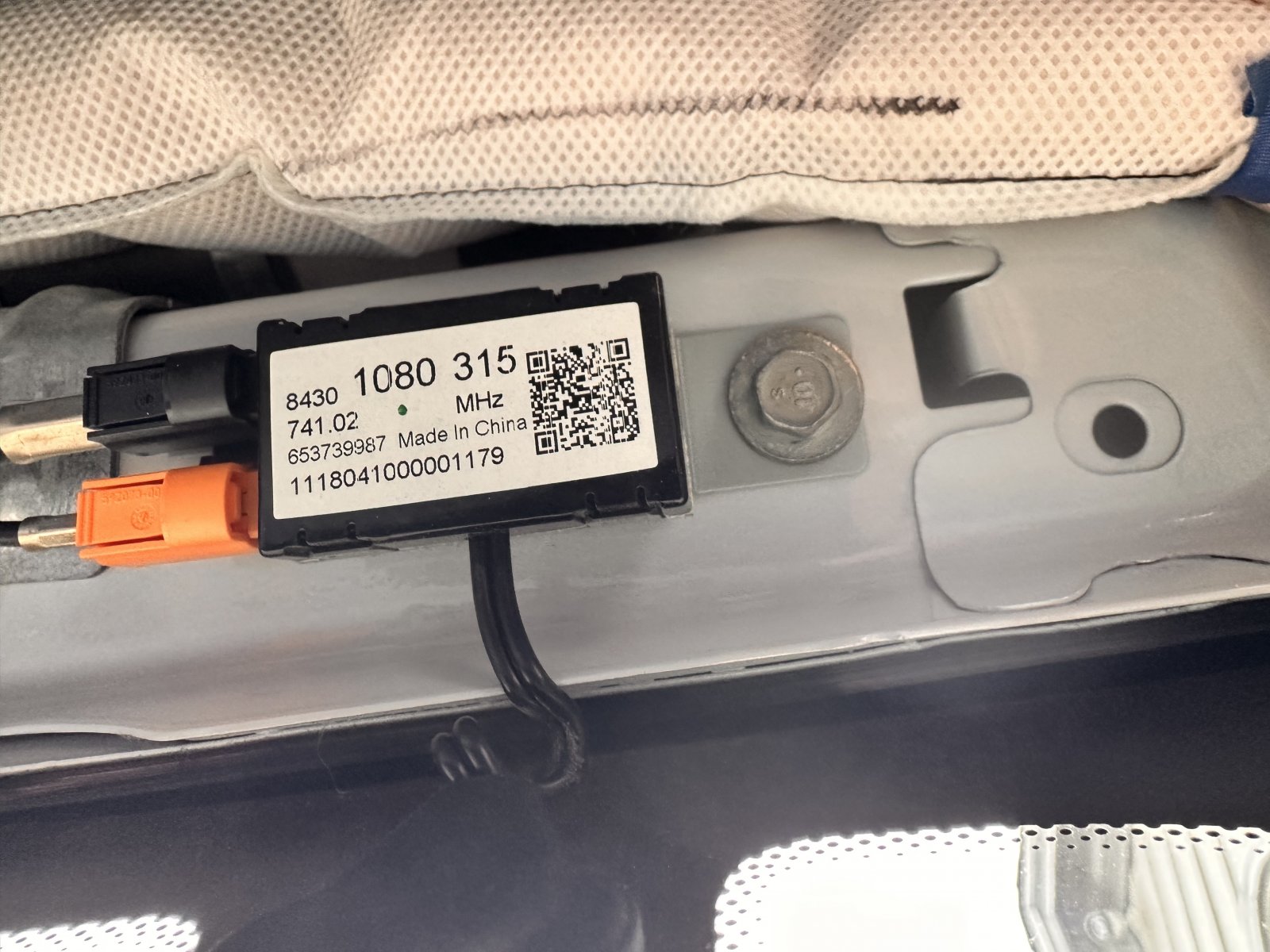

I have a 2018 Yukon Denali non-XL... Anyone know which part # to order from Rock Auto?

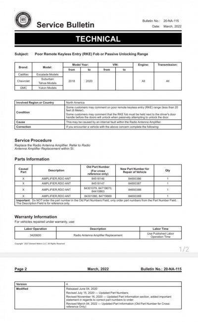

What I did (2018 Yukon, not Denali) was pull enough trim pieces to stick my phone in there and take a photo of the part number on the existing amp, then ordered the one that it (your screenshot from Rock Auto for example) says to replace it with. I ended up ordering it from Amazon as it was much faster.
Also, to add to the collective knowledge, my only symptom was that the buttons on the door handles got to the point that only very seldom would they unlock the doors. I had to remove the fob from my pocket and unlock the doors with the fob button. (But I never use the remote start, so don't know if that was an issue or not.) The replacement amp seems to have fixed by door handle button problem!
