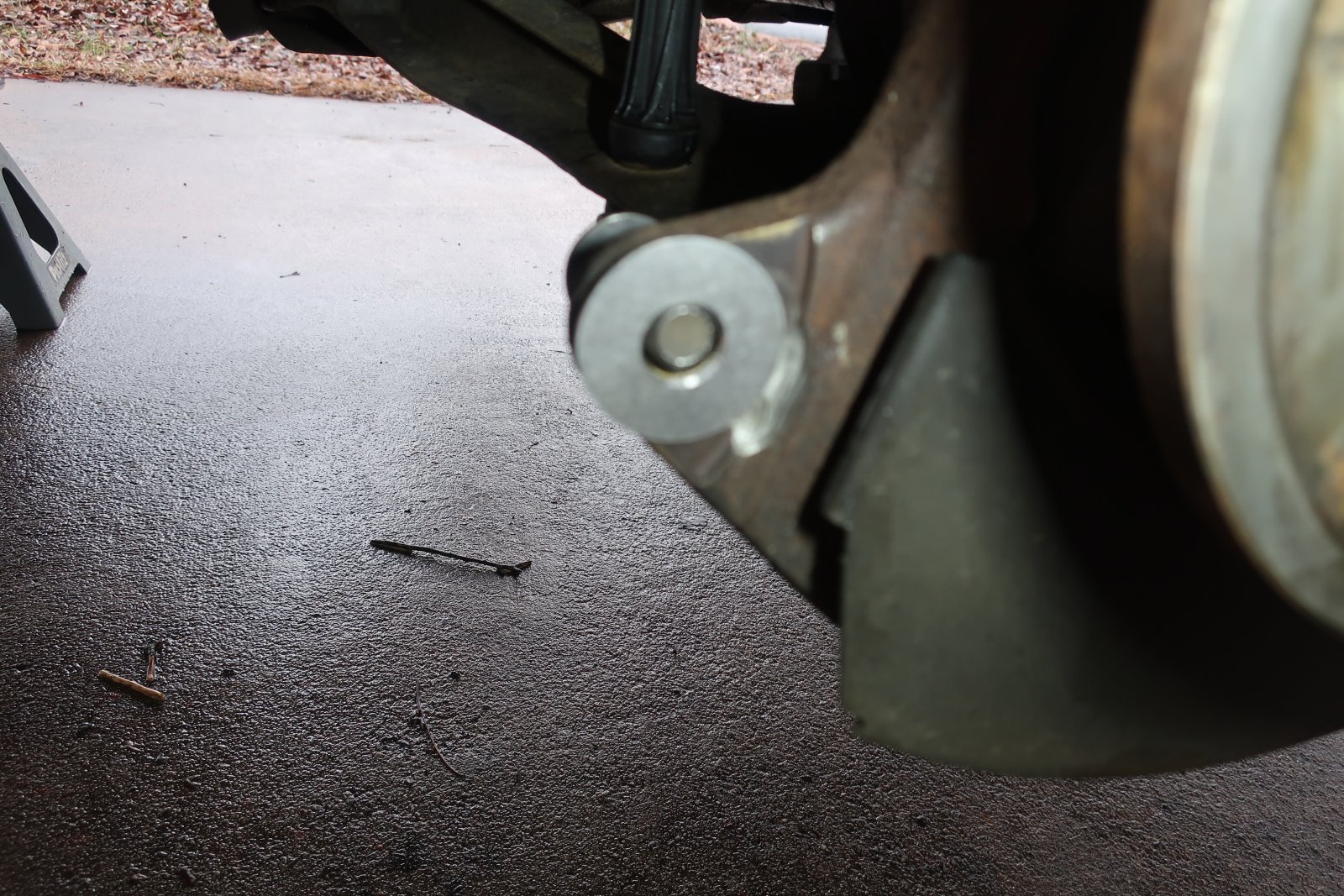

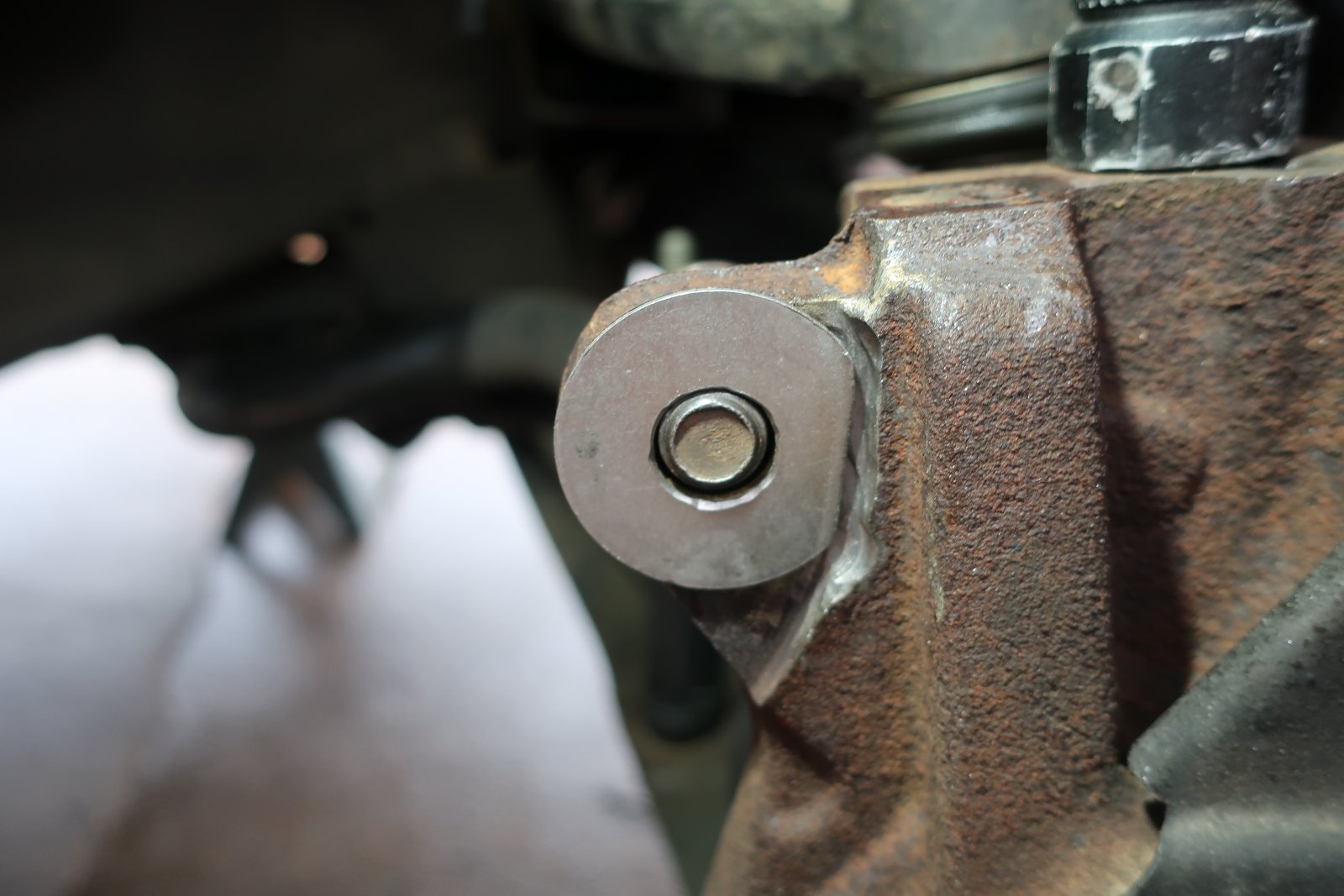

Now that I had clearance for the spacer washers to sit, I had to figure out which thickness of spacers I needed to center the calipers. Others had posted using a fender washer on each bolt.
Yeah. That didn't work for me.
From Amazon, I purchased 3/8" ID x 1 1/2" OD stainless steel fender washers, that were listed as being 0.040" thick, as well as same size but 0.060" thick. This way I had some leeway for spacing. I was still under the impression I would only need one spacer per bolt. I drilled out a group of both thickness washers to 9/16" ID so the M14 caliper bolts would pass through.
Got a caliper mounted with a 0.060" spacer between the caliper and the spindle. Lightly torqued the bolts. And noticed immediately that the rotor was NOT centered in the caliper.

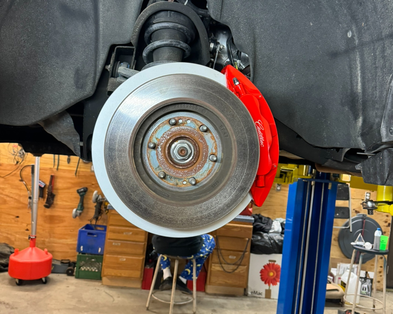

Top of driver's side caliper. Photo doesn't really show it, but the rotor looks centered in the caliper.
Bottom of driver's side caliper. Photo doesn't really show it, but the rotor looks centered in the caliper.
