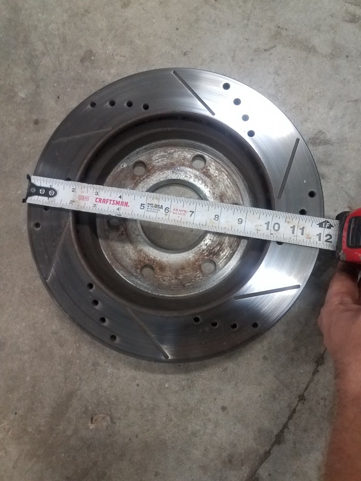

I swear I remember people talking about converting to the GMT-800 2 piston rear calipers years ago but couldn’t find anything on it when I looked last night before I ordered the red Power Stop calipers to match my Brembos. All that came up was converting the 800 to the 900 front brakes. There’s different rear calipers on the the 800 depending on 2WD or 4WD and I’m not sure if the parking brake is the same where the 800 rear rotor would just drop on so I wouldn’t want to blindly order parts. The bracket bolt spacing could be different, too.
All that I've read says due to bigger rotors, 800 rears were better than 900.
Also -- different size rotors for 800 based on brake options. JL4 has larger (304mm vs 330mm)

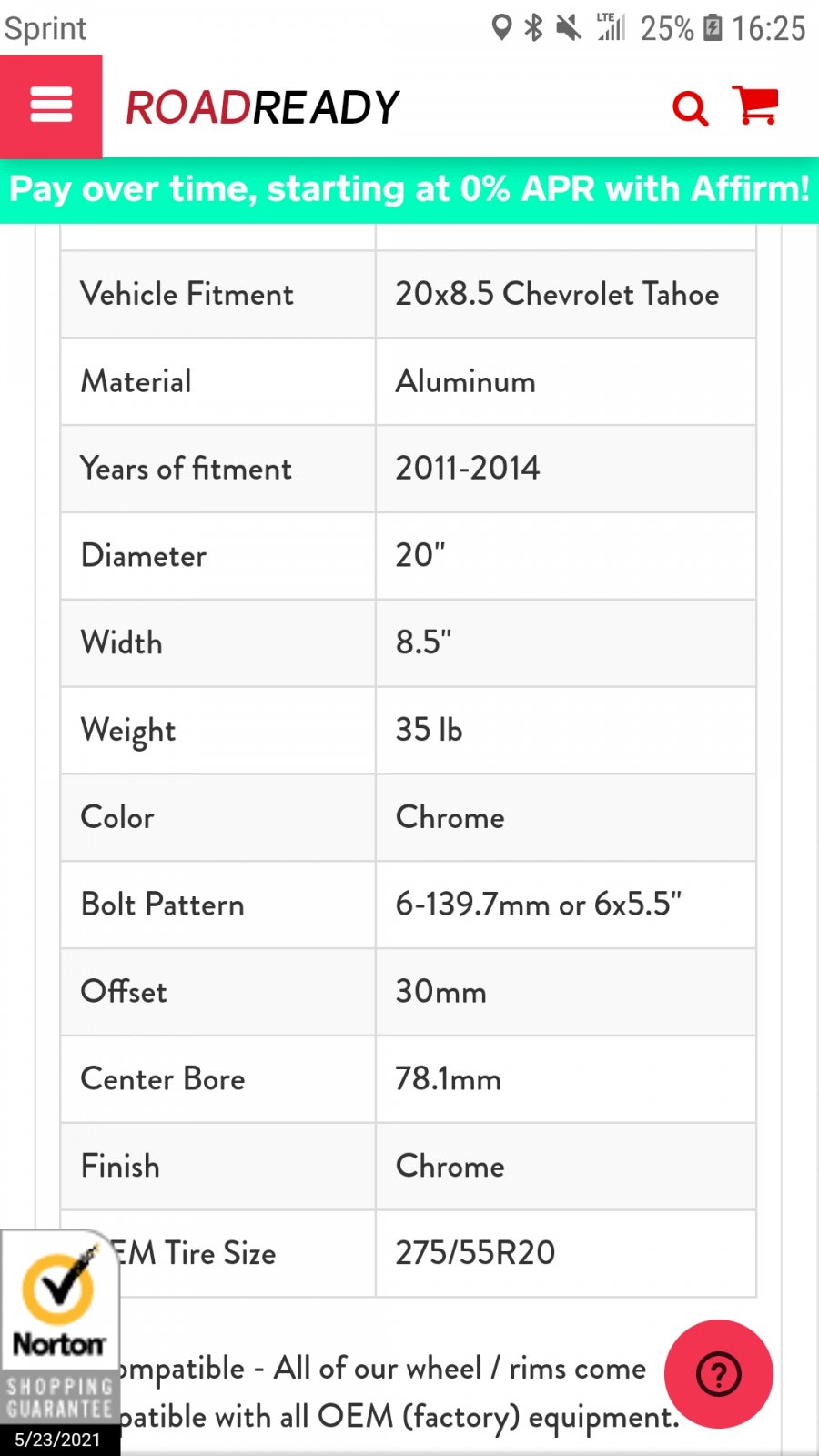

Really curious if the caliper will clear this wheel on my Tahoe -- it's from an '18 Silverado. Noticed it has 28mm offset...or at least that's the number on the backside.View attachment 277208
The guy in the video from the first page got his 2018 18" silverado wheels to fit with a 1/4 inch spacer.
Its was this wheel....2018 Z71?

I'm looking at the rear dual piston caliper mod next.
Calipers from the 2006 Suburban are dual piston with 330mm/12.99" vented rotors.
I might run up to Autozone this weekend and get some parts to test fit......if they don't work, I'll return them.

Do you know what the increase in pad area is over my 2003 tahoe? Its 4x4 so it has 2P calipers as well.
