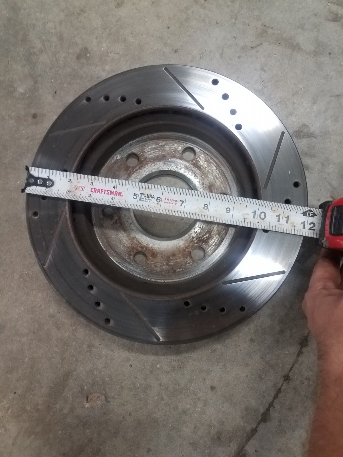

I'm looking at the rear dual piston caliper mod next.
Calipers from the 2006 Suburban are dual piston with 330mm/12.99" vented rotors.
I might run up to Autozone this weekend and get some parts to test fit......if they don't work, I'll return them.
