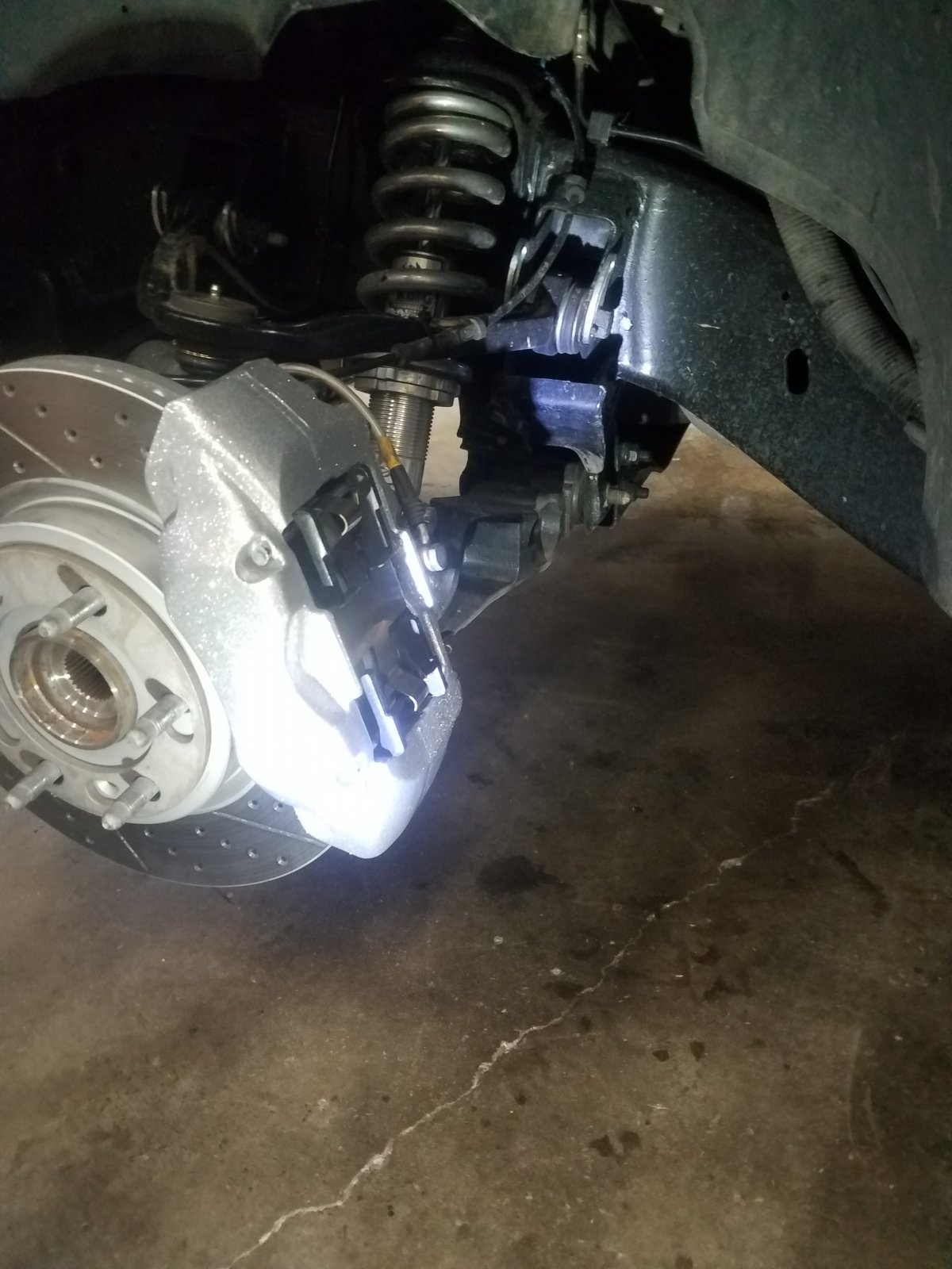

Well here is my progress.
Cut off wheel on the angle grinder......takes about 2 mins to delete the hump.....on this hump day. Then clean up with my Milwaukee M12 die grinder with a 40 grit flapper wheel.
Hope to get these out to powder coating this week

Ok, so I didn't even need to remove the existing caliper to figure out this wasn't even close to working. My 2010 Tahoe Z71 with the factory 18 inch wheels had about .75 inch clearance between the wheel and original caliper, which is very generous. The original caliper measures approximately 3.5 inches from the mounting flange to the outer edge of the caliper closest to the wheel. The new 2019+ caliper measures approximately 4.75-4.875 inches from the mounting flange to the outer edge of the dreaded casting "bump". Looks like new wheels are going to need to go on here since I just bought new bfg ko2s. Pics attached. We need this info stored in a sticky or something, if possible

Well I took some measurements of my wheels........there is no way in hell I can run these with my current wheels unless I go with .50" spacer.......and I hate spacers.
I have shaved the hump and cleaned most of the casting flash up for powder coating......any offers. Since they're back on a national back order?
They would work if I went back to my stock wheels, but I'm not doing that.

Test fitted this fuel wheel today...worked no problema.
Ordered for a 2020 Silverado. 18x9 ET20
And good spoke spacing to highlight the calipers.
Finally I can move forward......gee.
My Z71 wheels did not clear the caliper with a 1/4" spacer but did easily with 1/2".
Its probably somewhere in between.
With 1/2" spacer the studs only ended up with about a lugnut worth of thread though....so would not run that except for storage
or at a body shop.
