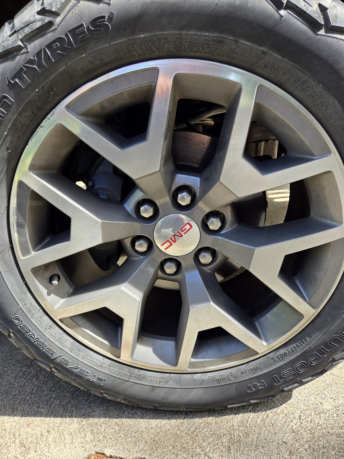

Have you looked into the 6 piston police tahoe caliper upgrade? I like the brake upgrades I did on my 14 sierra. I'm going to do the 6 piston calipers on the front of my 18 sierra with the camaro 4 piston calipers on the rear. Here's the rear of my 14

Have you looked into the 6 piston police tahoe caliper upgrade? I like the brake upgrades I did on my 14 sierra. I'm going to do the 6 piston calipers on the front of my 18 sierra with the camaro 4 piston calipers on the rear. Here's the rear of my 14 View attachment 438426
Now I want to upgrade my BBK again!!! Do you happen to have part numbers for the front and rear? Are any adapters needed for the rear like the front?
For the front calipers I machined some steel spacers that are 4mm thick to go between spindle mounts and the caliper to center it on the rotors. If you're going PPV 6 pistons up front i haven't done them yet.
