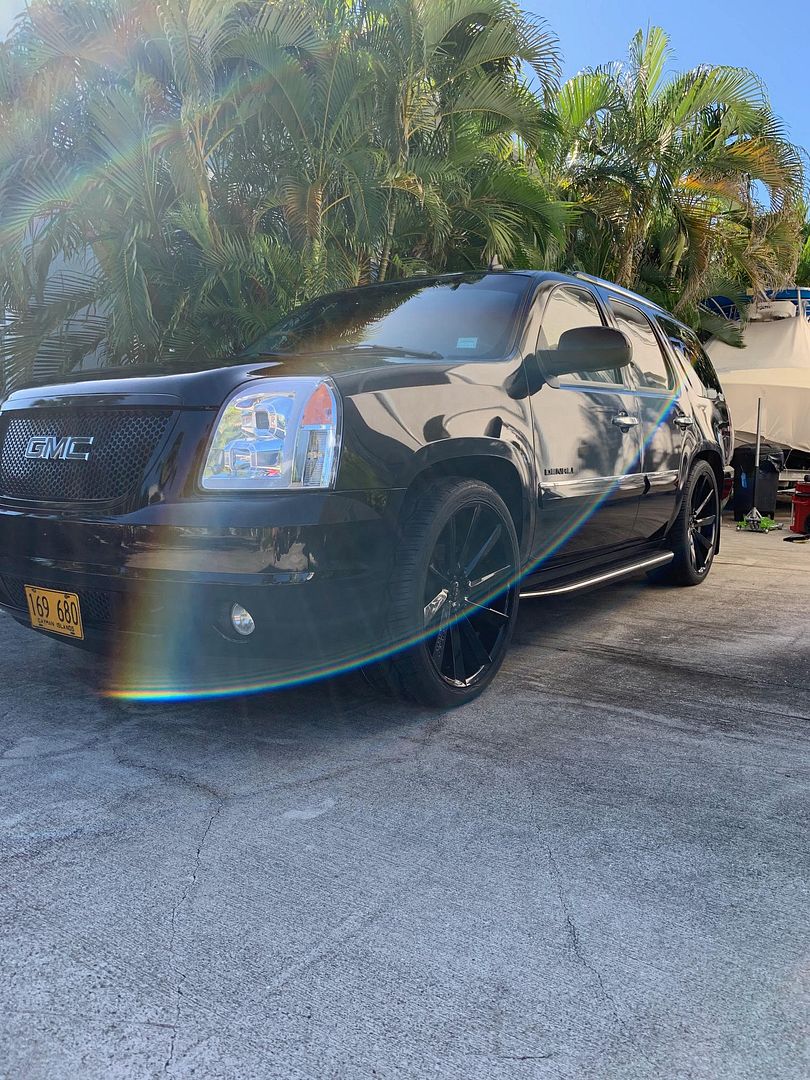

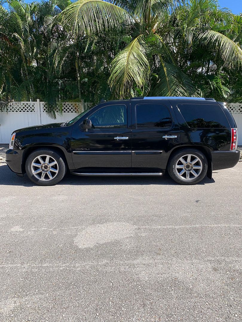

So here's the baseline picture prior taking her apart

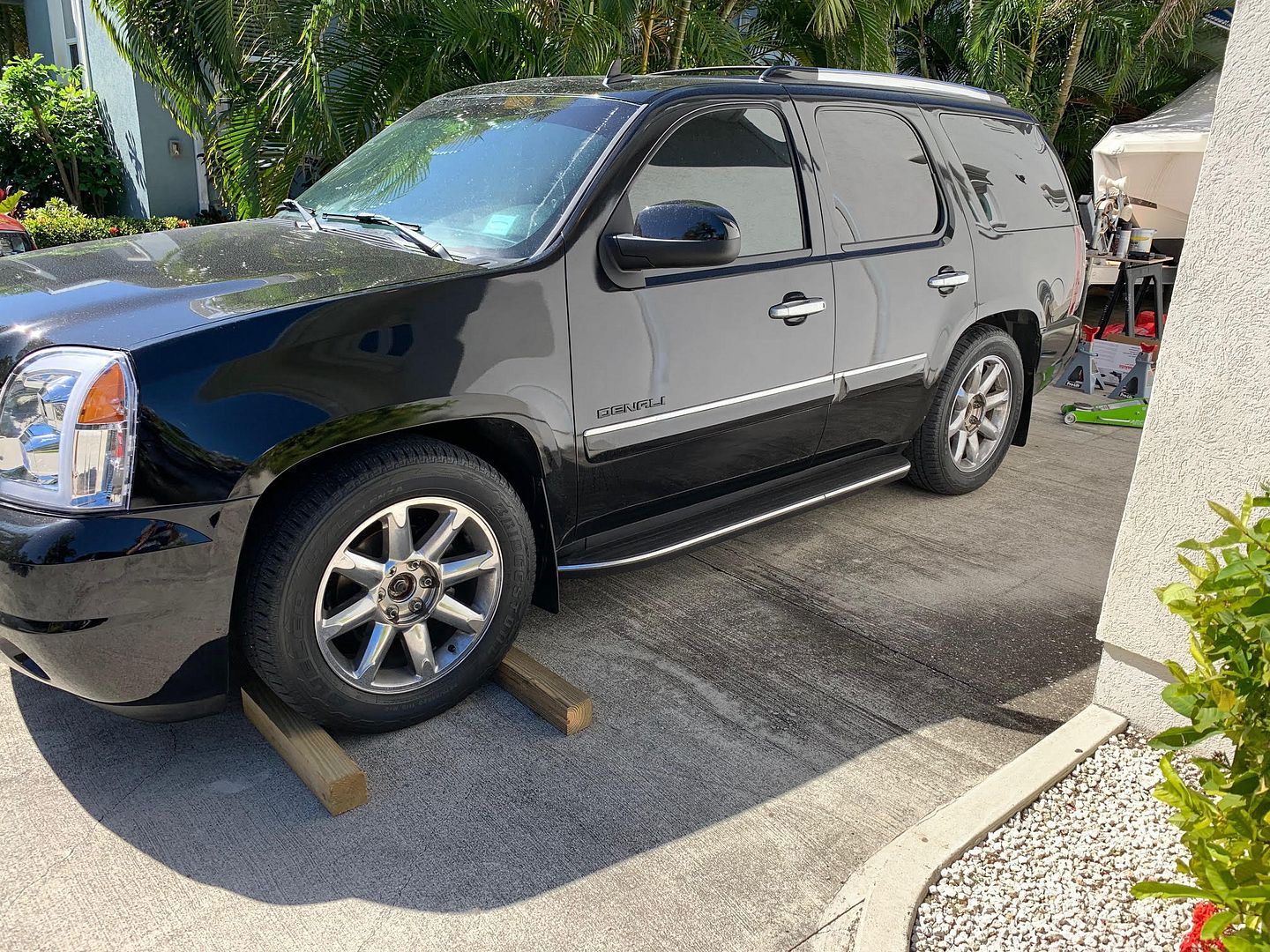

I was hoping I could get this done in 2 days, but I planned it for the long New Years weekend just in case, plus I wasn't able to get started as early as I would have liked the first 2 days. The first few hours were far and away the toughest part, breaking bolts that had been locked down for 130k miles just isn't easy and it always seems like every piece is a jigsaw puzzle of wrenches/ratchets/extensions/swivels to get at them with enough leverage. I did NOT have the right combination to easily get at the upper strut mounts down through the engine bay, so I got immediately discouraged on the passenger side at the very beginning.
I used a video on how to replace lower controls arms from 1A auto and TWA motorsports lowering videos to kind of help guide me through, but the good news is it all starts to make a lot of sense once you get under there and start doing it. But like I said the beginning was the toughest part.

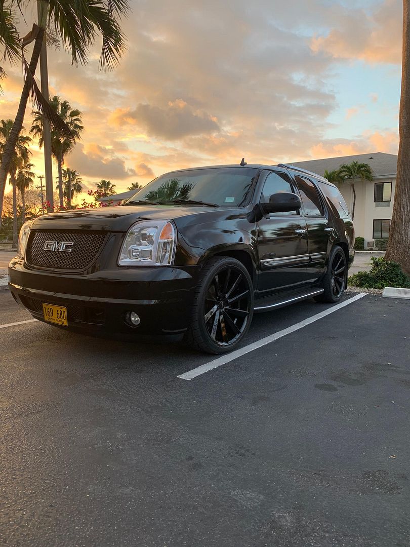

And... front end done! We're back on the ground! Loved it instantly - shrink those fender gaps!
