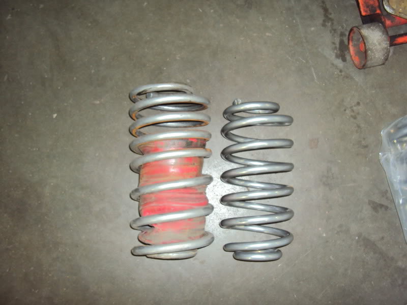

I'm using some spring retainers from a jeep when I do mine, definitely a good idea if you don't have the shock lengths perfect. My 10-450s should be installed tomorrow or monday :pepper:

I'll get the springs in next week and it will be another week to swap them for 9" springs if necessary. I want the rear fender on the tire, if the 10-450 does it or gets close I'll just run those and call it good, then I can forget the djm lca brackets and all the other crap. School is taking up some lootcakes right now so you'll just have to wait sucka.

hes going to need the 9s for sure if not 8-500s.

I talked to summit, and they have 9-500 on the website, but I don't see the 8-500, and the guy I talked to said that he would have to check on it to make sure they can get it. If anyone has a link to the 8's, please post it.
If I put the 8's on it, is there shock changes that im going to have to make? Thanks!

Yes you will have to get shorter shocks, look at the beginning of this thread.
