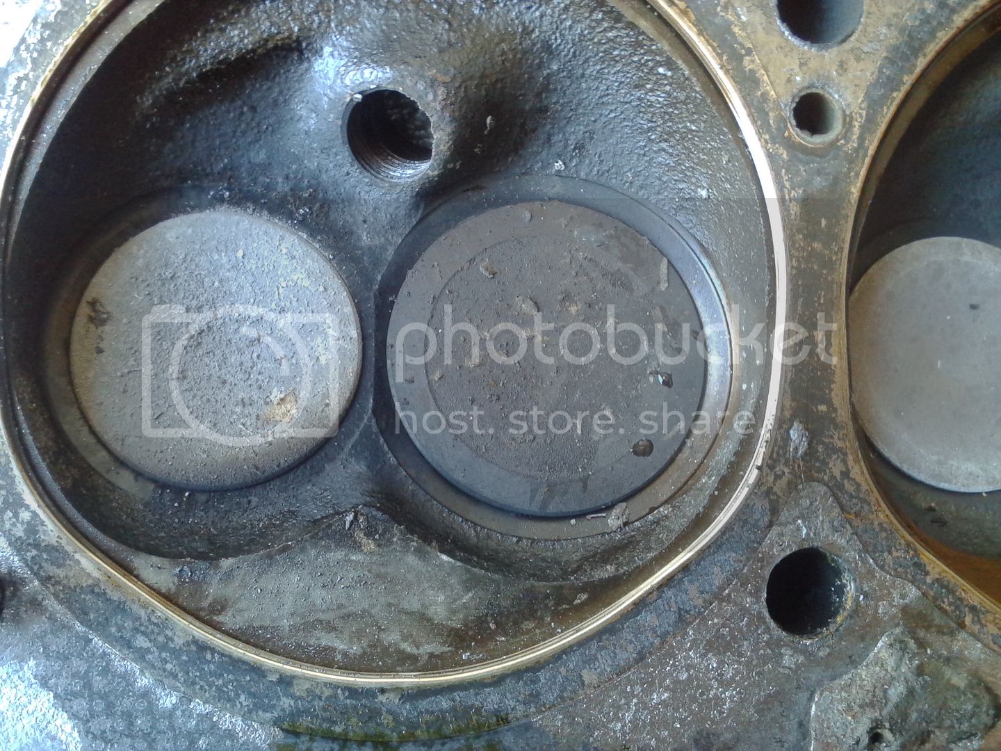

yeah a blip for a 0.5 of a second aint hurting nothing. its when its stays and keeps building.
then your ******* uncle chip shows up and ruins the party.
there he is. lol heres the kicker, i was already building the new engine for the car. plan was to have a running spare. yeah right. it knew wtf was up, and like a scorn woman, she blew up on me.
let me tell ya, when you chip a piston, you know asap you just hurt the hell out your engine. made some damn horrid sounds at 6,000 rpm till that chip got chewed up and passed the valve. ate the spark plug and then started to misfire really bad. never thought you could hear it being eaten up lol
ate that valve up too. it held no air pressure when i was taking my valve springs off it. straight hiss out the exhaust port lol

On my '79 and later my '85, melted pistons on both, they sounded like birds chirping. The material between the rings on the sides fell away like those chips. Never had a chip though, just plain melted them! What a lesson in fuel pressure! LOL

Whatsa wideband? This was in the 1980s and early 1990s. It wasn't until '92 or so where we had the ability to hook laptops up to the newer Grand Nationals and do more specialized tuning. My buddies blew a lot of engines that way. I stayed with mild chips and pulled power through careful selection of parts and headwork and massaging what was there already and turbos. The biggest problem people run into now and then was making things too big. In my speed shop, I made more money taking all the quackery off the cars then selling parts.

I used to run 18-20 psi with a 237 regulator, stock pump and injectors on pump gas with a bottle of 104+ octane booster or Sunoco unleaded race gas when available. The motors were designed to run indefinitely at 20 psi but run them at 24 psi in 3rd gear and you'll lift the heads off the deck. A 24 psi swing was ok in 1st if it settled back to 18-20 psi. We used air compressor dials mounted in the ashtray to control the boost. That's how I melted a couple of pistons racing an RX-7, kept turning up the boost to beat him, his whole motor blew up and I melted a piston and drove it home sounding like a bird chirping for sixty miles.
