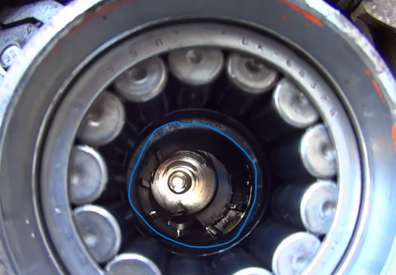

Got some time and going through the entire rear end to rebuild, what the heck is this inner sleeve? It is plastic and none of the parts stores or rockauto carry it. youtube videos of 14 or 10 bolt rebuilds seem to be hit or miss on this part even being present when other tear down the axle. im putting this back together tomorrow in prep to put in the vehicle but idk if i need to worry about replacing this... ive done all the pinion, carrier and axle bearings/seals minus this sleeve.

I second ABS wheel speed sensor. I think they showed up on the GMT900s(?) Is there a wire on each side of the wheel on the axle?
The GMT800 and prior relied on rear wheel speed via the VSS on either the transmission or transfer case, not on the actual rear wheels.
