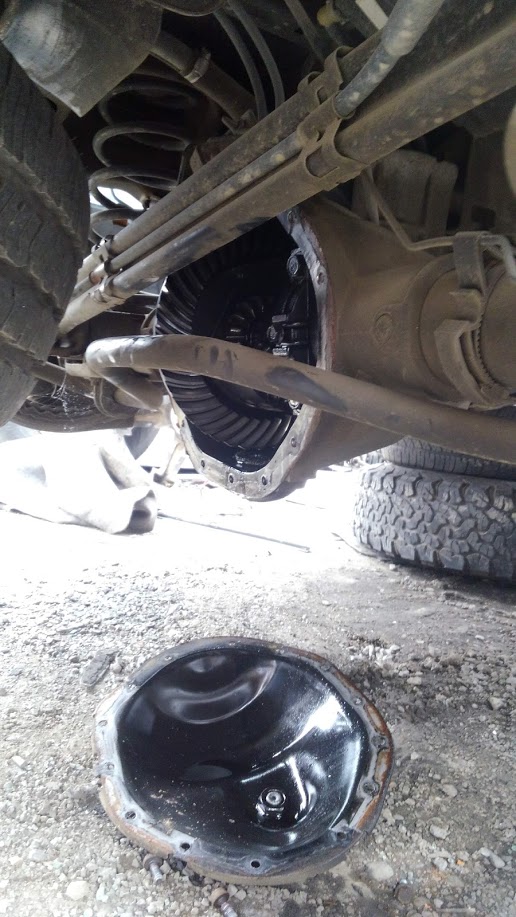

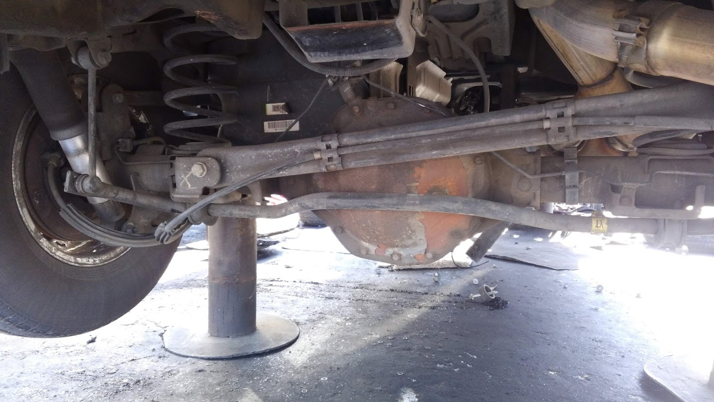

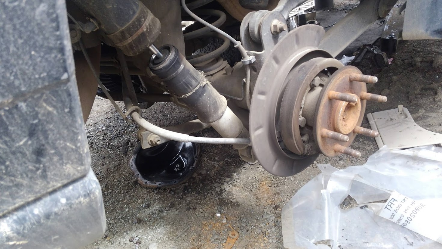

Another nice reason to get GMT900 axle is the fact that they are likely to have less miles and look cleaner overall. For example this one I just got was the absolute cheapest one I could find and its what I would consider an 8/10 for outside appearance and 9/10 for inside.
