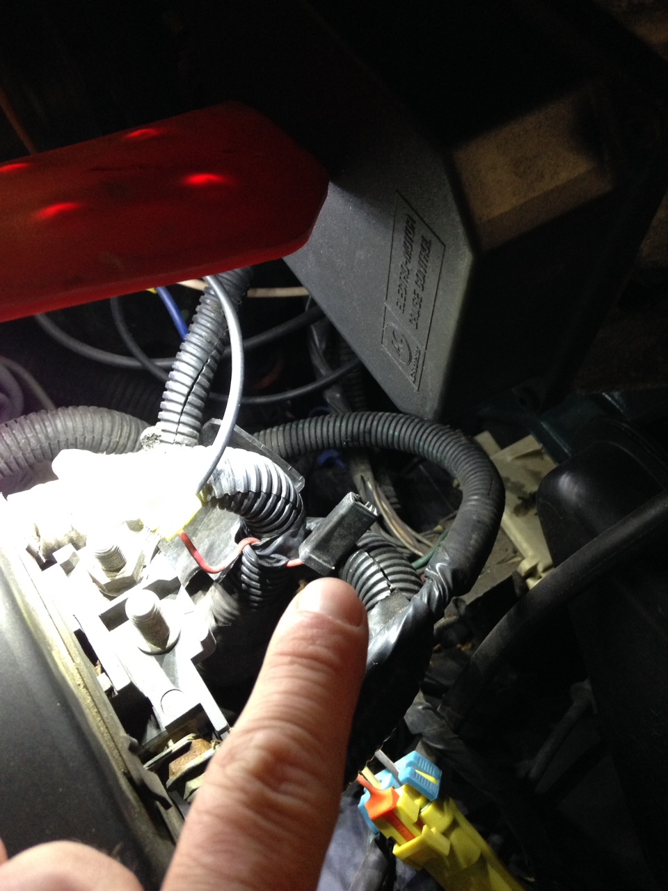

You could check to see if the pump isn't getting enough voltage. You'd unplug the pump harness (and I assume it's in a crappy location) and then jumper the pump test connector to battery positive. Then see if you have 12V at the pump connector.
Test connector is here by the fuse box, it has a red wire going to it...
