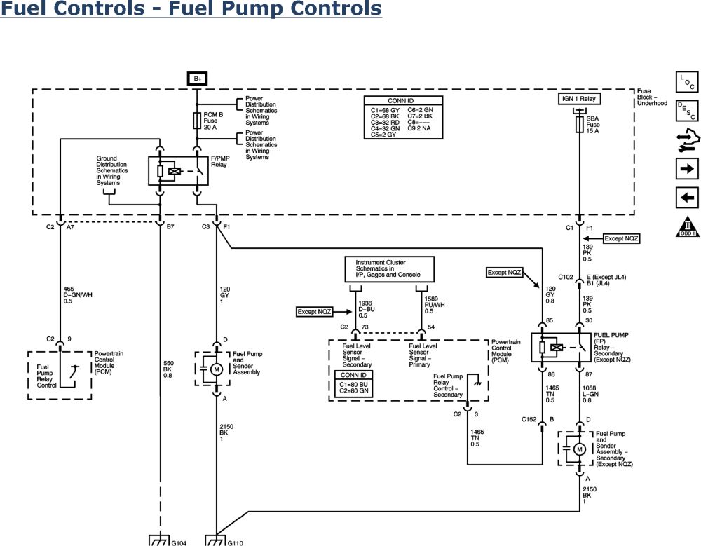

Makes sense now according to attached schematic they are using PCM B fuse also to power the Fuel Pump via the Fuel Pump Relay. Wonder why GM did away with the previous individual Fuel Pump Fuse.
Thank you very much for your help anyway. It gave me the crucial clues. I haven't really solved the problem yet, because the wiring harness looks OK and the fact that petrol leaked from the petrol pump shouldn't have caused an electrical fault.
But since the fault hasn't occurred since I pulled the petrol pump relay and the petrol pump was leaking and causing problems anyway, I think the connection is clear.
I'll need a few more days because I'm now doing the rust protection on the underbody at the same time, but I think I'll briefly hook the petrol pump up to the wiring harness today and just start the car with the petrol pump relay to see if the fuse stays intact.
In any case, you've helped me a lot...
Best regards from Germany
That fuse powers through the contact set of the fuel pump relay straight to the fuel pump. It could be the pump is shorted (Its motor windings melted together which lowers resistance and increases current draw)*NOTICE* I did NOT say short to ground for the pump or you have a wiring harness short to ground fault. Go to both contact terminals and measure to ground to check for a short to ground (with pump disconnected).
