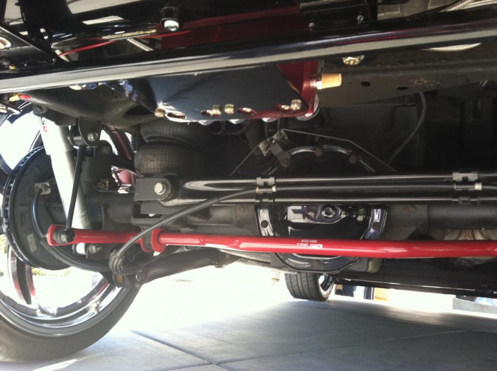

Got the rear bags installed and cut the bumpstop bracket off. It rides so much better than the 5" springs did.
I've still got to do the leveling arms/sensors and tack the lower cups in place.
It airs out not as low as I hoped, might look into different lower bag mounts as the ride tech kit has the bags maybe 3" above the axle tube. But playing with different heights I've found it rides best very close to where it sat with the 5" springs. After I get the front done and figure ride height I'll debate changing rear brackets.
Now one odd thing happening is when aired down the pass side sits lower. Any ideas? I'm going to look it over closer tomorrow

Found the pass panhard mount is sitting on the sway bar. No idea yet how to fix that other than longer links or notch the bracket. It has a dim hardware kit.
